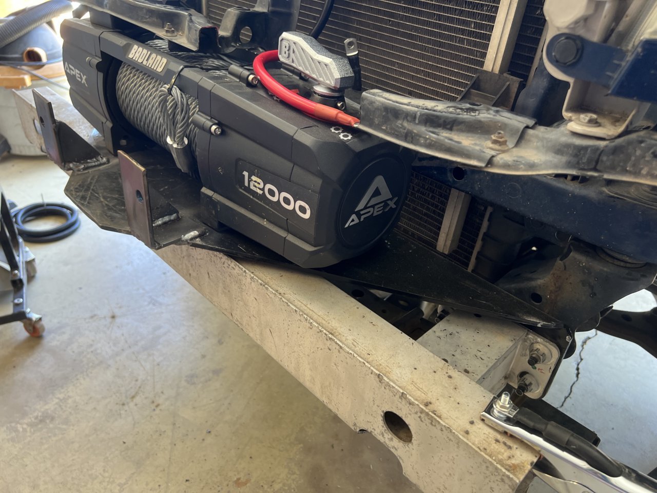

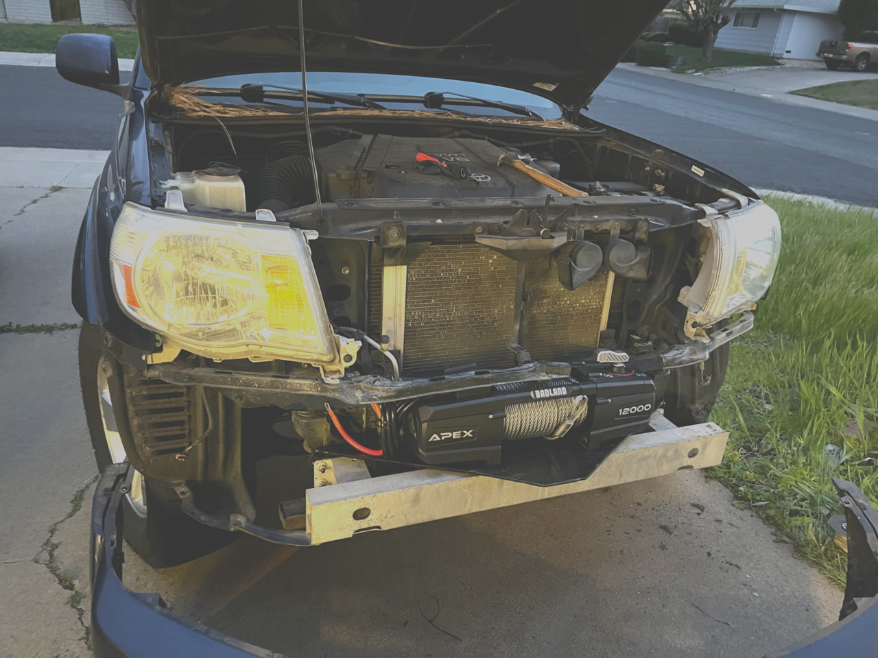

    So I did a thing today to my dad's 05.
    2 weeks ago, we mounted the winch on a winch plate between the bumper and frame, (black triangle) but we ran out of time to wire it and make the bumper cover fit right. We did get the bumper cover zip tied close to where it goes so he wasn't out a truck.

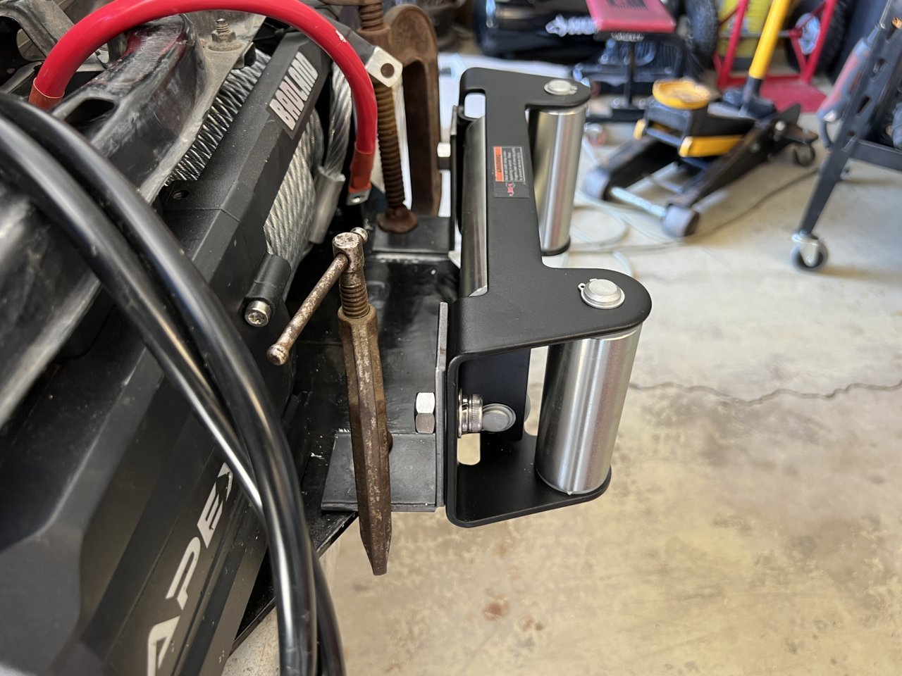

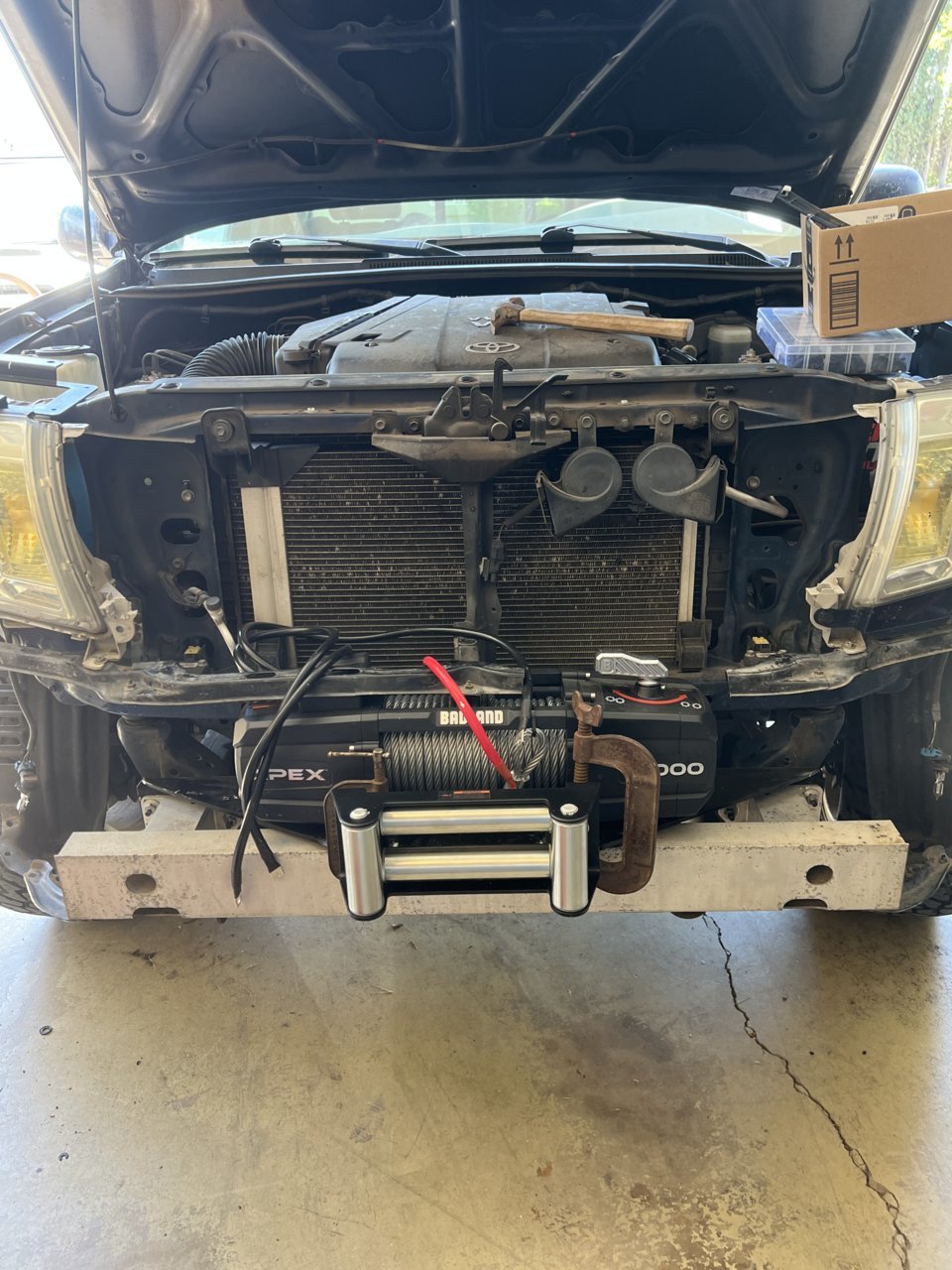

    I made some 90 deg brackets out of 3/16 x 2" flat bar and clamped them in place using the fairlead to be sure they fit after welding.

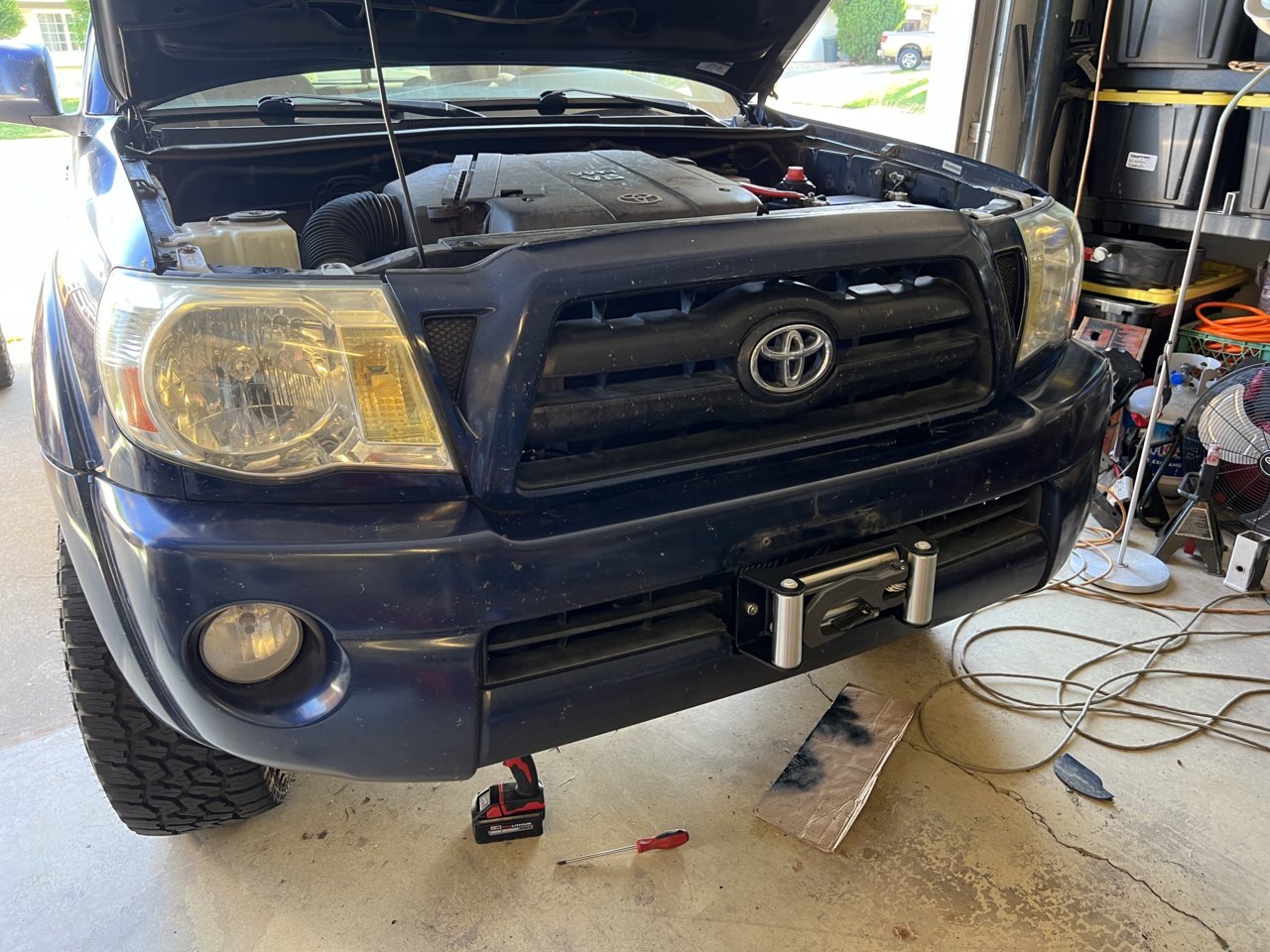

    I made a cut in the bumper cover just big enough to fit the new brackets (not the fairlead), then after we wired the winch up, we put the bumper cover on and bolted the fairlead to the outside.
    He plans to use it to haul logs around on his property, so he got the steel cable. The winch winds in and out like it should when wired to the controller, but in Bluetooth mode, the winch will only wind in. Sucks, because it isn't easy to get the winch out to replace it under warranty.

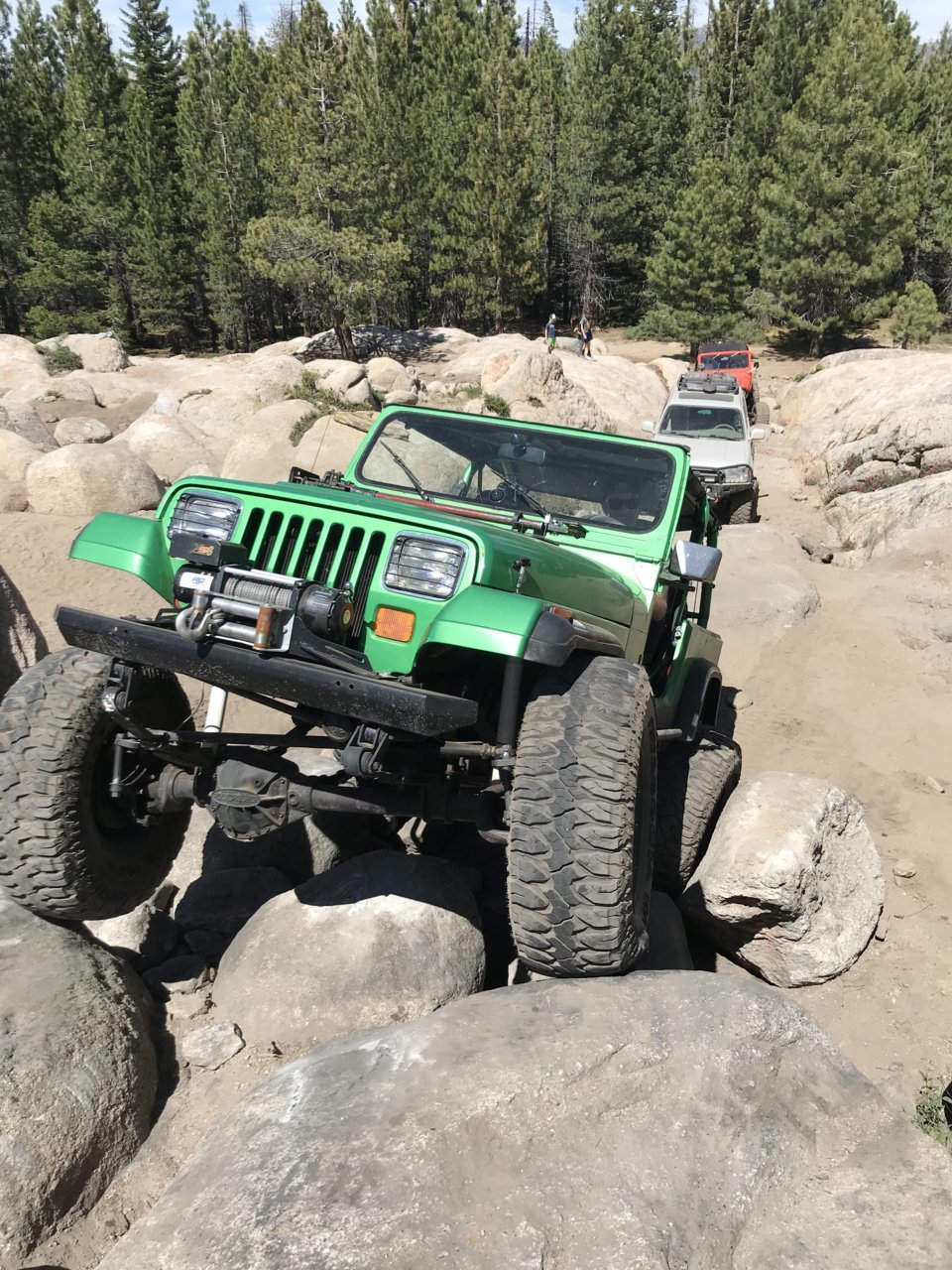

    Oh yeah been there. Bought someones project Jeep… not a tight bolt on the whole thing.
    turned out ok.
