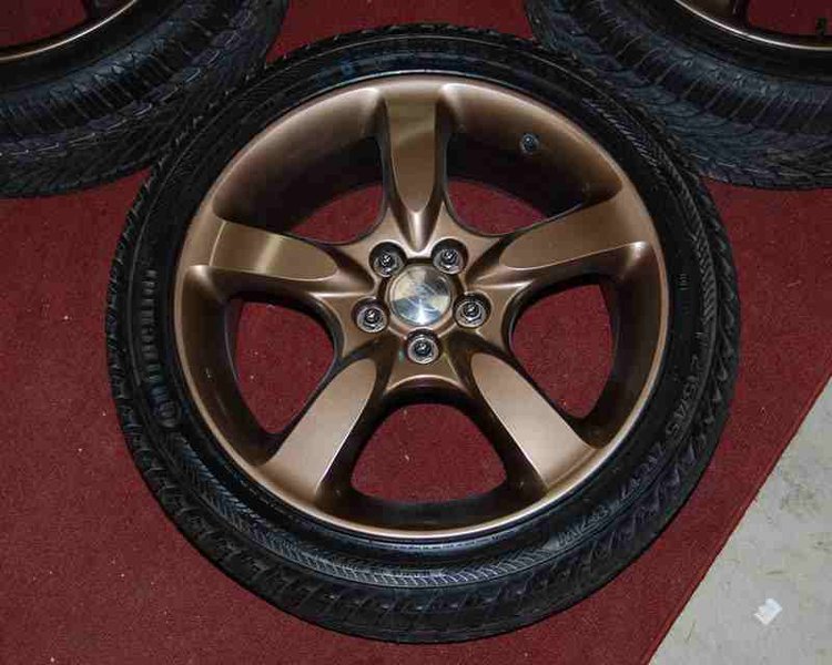

    Dont think the bronze looks good?

    I like bronze on white trucks and almost went that route but it has to be a light color bronze like so (this is my opinion though :p ):
    I also like the mix of the gunmetal, white and black which is why that's what's on my rig :)
    Cuts look nice man!

    Hmm im not entirely opposed, was just thinking too much would be overwhelming a little.

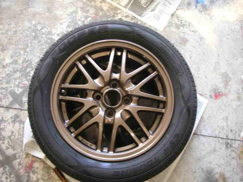

    I know if i was getting new wheels theyd be the bronze F5s which are a tad darker.This is the bronze i was thinking to use in particular (duplicolor wheel bronze). Found a post with some actually done up too.
    Thanks, i still need to get flares trimmed front and rear. Spray underneath the front with rubberized undercoating and cycle the front with tires/no shock. But i think its gonna be pretty close...i hope. Lol
