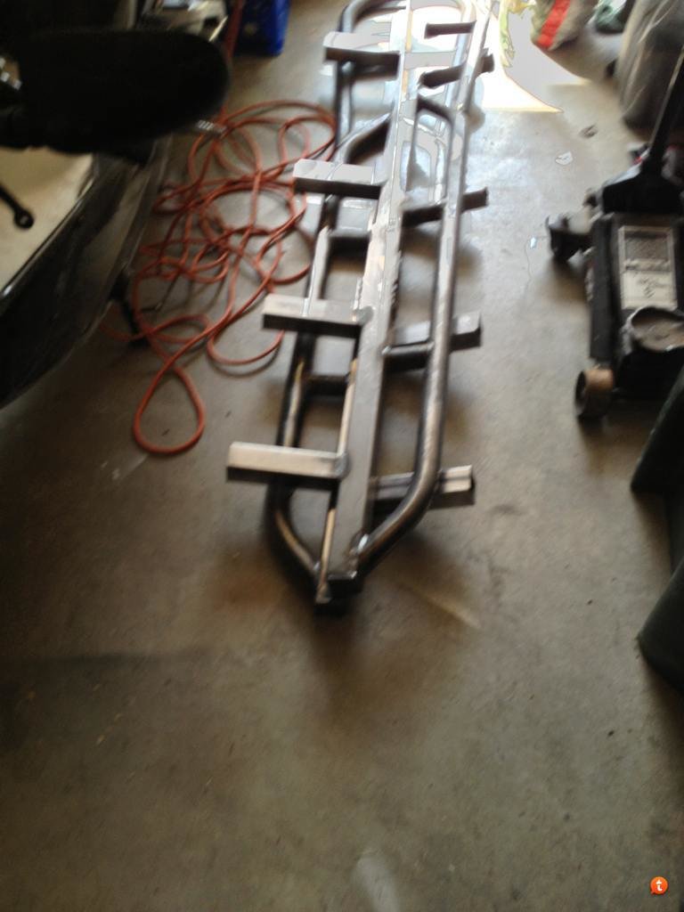

    Woot! Sliders came in fast! 3 weeks plus shipping. Thanks Jerry!

    With the kick outs, nice. You got the feet to weld them to the frame too right?

    Yes I did, those were shipped separate and arrived this past Saturday.
    Plan to clean and paint them this weekend. And get some quotes for the weld work.

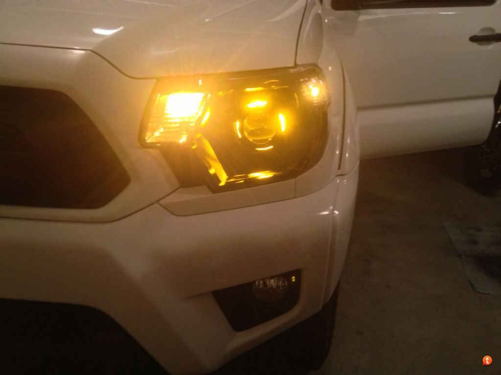

    Are those the FX-R projectors, or the mini stage III D2S projectors? How hard was it to wire the halos?

    They are the minis. If I were to redo it I would go ahead and get fxr personally. It's not that much more work since the minis now require cutting the flange off the reflector bowl.
    The halos are easy, I just tapped them into the parking light wires. If you tap into drl they blink with the blinker which I didn't want. So I chose the parking lights and leave my switch there all the time except when I need the headlights obviously
