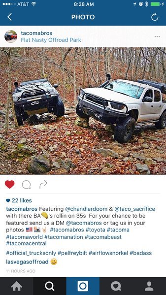

    Spotted

    Haha I sent him that. I just changed my IG tag again though so it's no longer the correct tag.

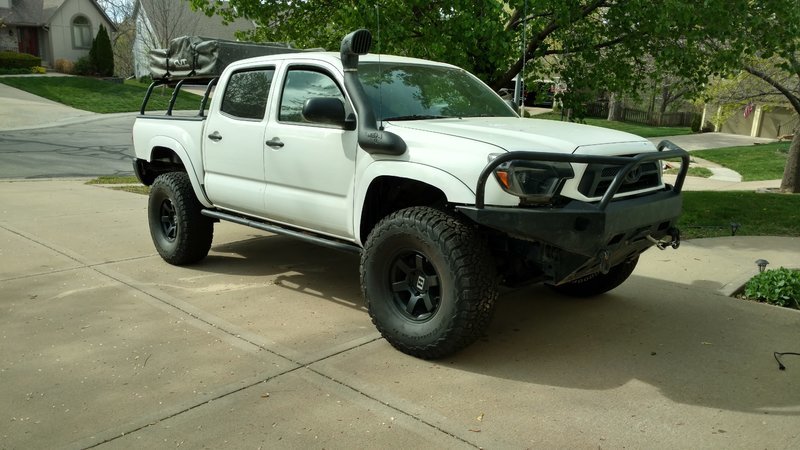

    Put my flares back on finally. See how long they last. If they do fall off. I'm not too worried, got pretty used to the flareless look

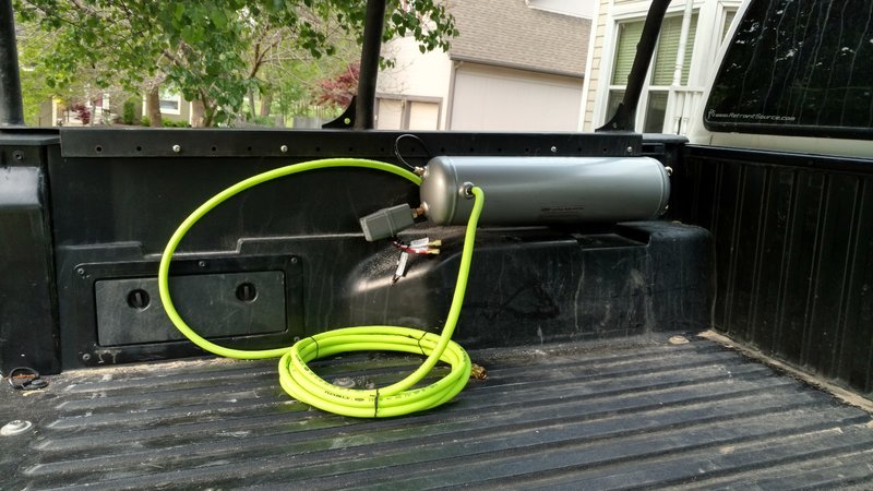

    Got a start on mounting my oba. Decided to move the tank to an easier accessible spot for now. The super long hose is temporary for now. Still to do electrical and put the compressor in the back seat still.

    Is it ok for the tank to sit like that? I ask cause I've heard different inputs...

    Other than any moisture won't specifically drain out of the drain the best, I don't know of any real reason it can't be.

    Thanks. Wasn't sure of any reasons either just what I heard. I'll most likely mount mine there when I get a rack

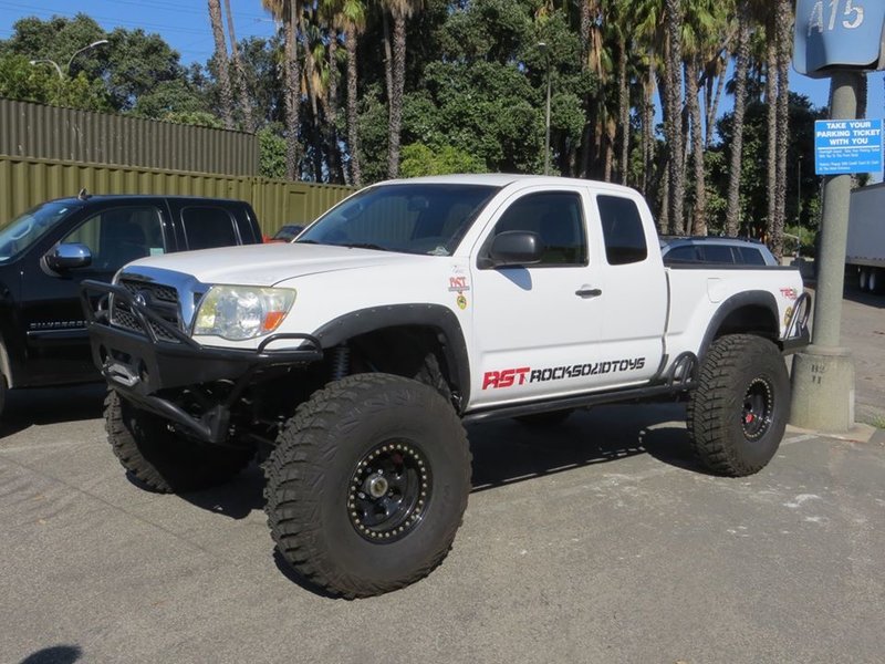

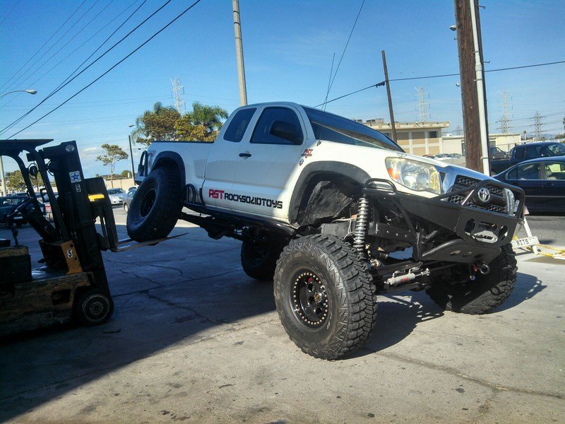

    I'll just leave this here

    If that's not damn awesome idk what is

    That's what I'm saying

    Did you see it in person?

    No, lol

    OBA is finished! Compressor behind the driver rear seat, utilizing the stock hole for the air lead to the tank. I then drilled another hole for the gasket that was there and used it for the compressor power from the tank pressure regulator/relay. The viair air pressure gauge was already messed up so I went and bought one from home depot and put it directly on the tank, no shitty compression hose now. The on/off switch is in the driver side cubby in the bed.
    Other than my wiring not being the prettiest, it all works like a charm. Just one very small air leak at the quick connect from the cab to tank hose (i may just get rid of the quick connect here). Compressor turns off at 150psi and back on at 110 like it should!
    If anyone wants pictures of anything let me know, other than that it looks like I posted earlier in the bed still. Currently leaving the extra hose attached since I'm going wheeling Saturday anyways.

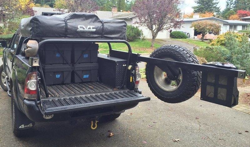

    Well my swingout I'm gonna make for the bedrack actually since @ChandlerDOOM showed me this one. It belongs to @OutbackHack.
    The bumper I'm going to keep super slim instead of having a full license plate width which really isn't "high clearance" imo

    That's cool I never saw that before!

    Yea a pretty slick setup. I'm doing a different latching style though.
    And I like that I'll be able to keep my bumper super tucked when I make it
