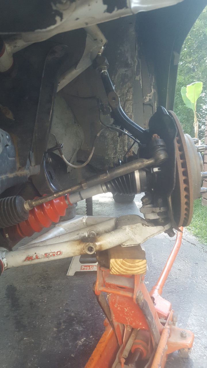

    Info for verifying shocks.
    shock length at full droop is 25.5 inches (which is just shy axle bind)
    5.5 inches of shock shaft fully extended. kit must not use 8inch coilovers then unless theres an internal spacer :notsure:
    Need to let off some preload to be able to check compressed height still

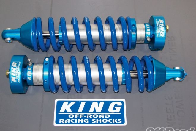

    It isn’t the extension but rather just how much physical space (or lack there of).
    Top picture is first gen coil overs, bottom is second gen. Look at the tip at the bottom of the coil overs. On the first gen there is essentially none because there is enough room around the axle to fit an entire coil/shock. But on the second gen there isn't, so they take away shock travel and put that extended tip in to make up for the length.
    1011or_01_+king_performance_series_coilover_install_toyota_tacoma+king_shocks.jpg king_oem_performance_shock_upgrade_kits_front_remote_reservoir_sample.jpg
    I think it was @jberry813 that explained it one time on here.

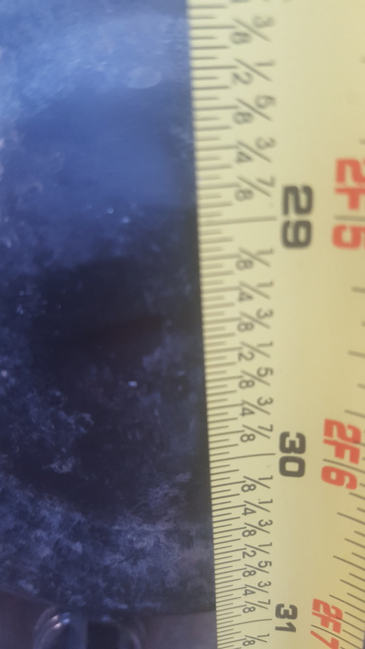

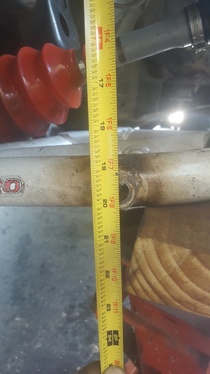

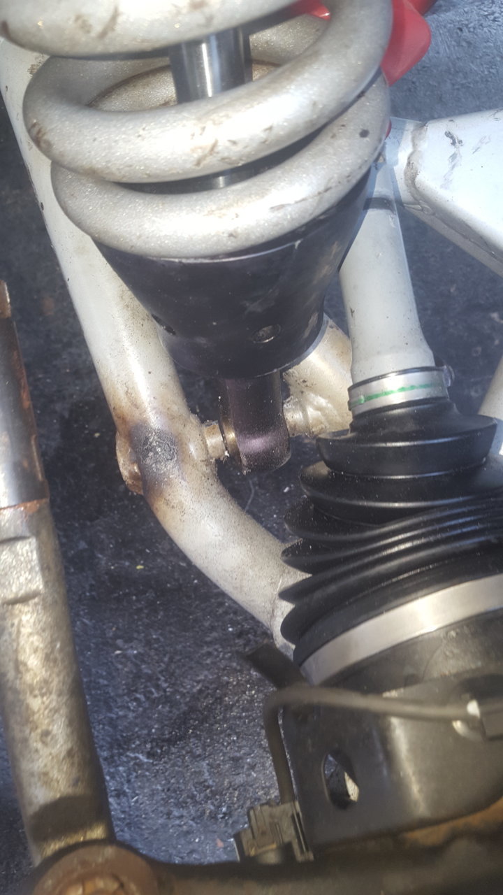

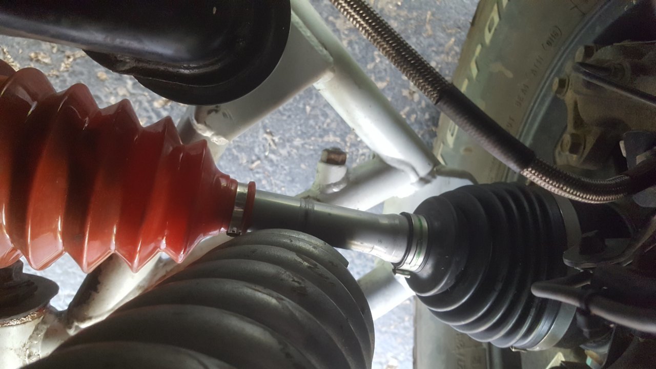

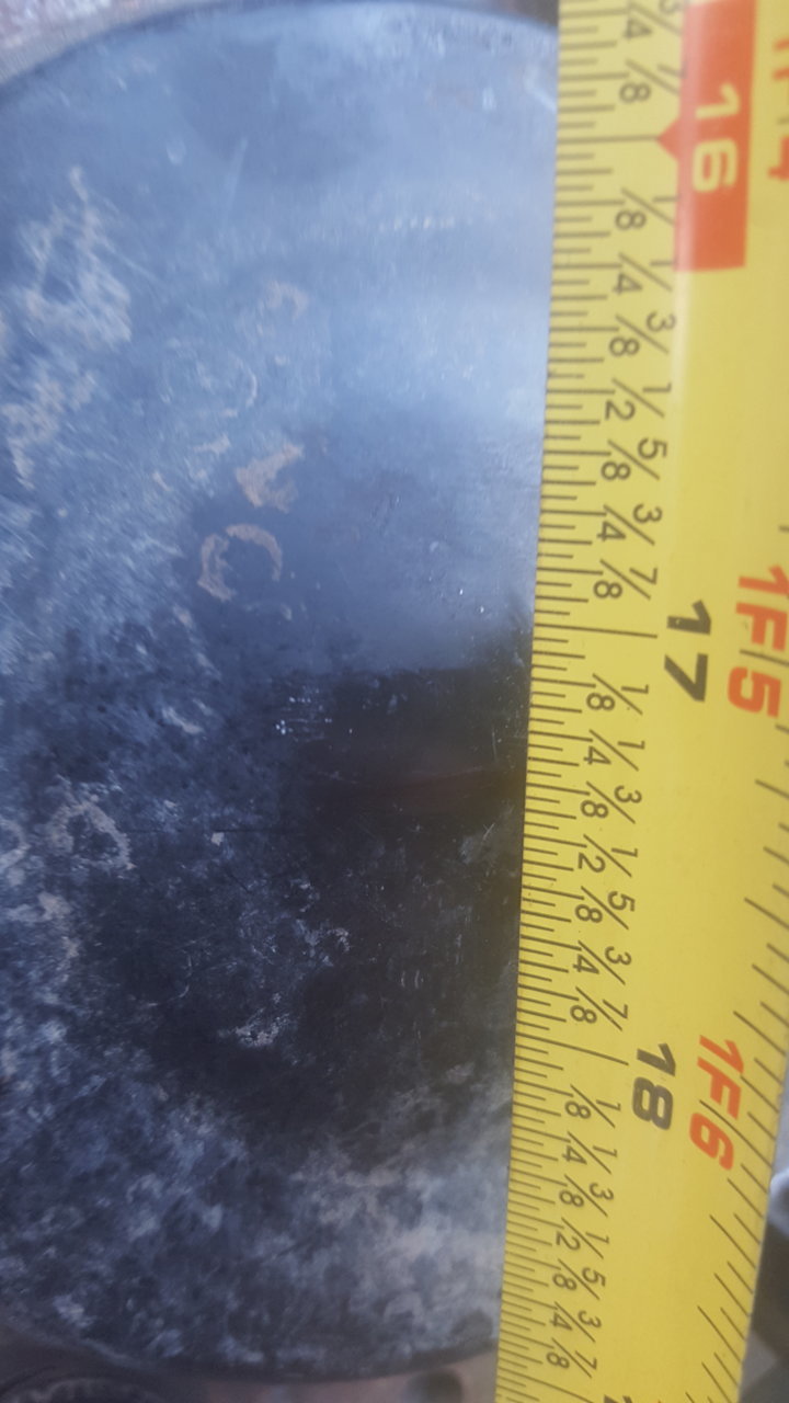

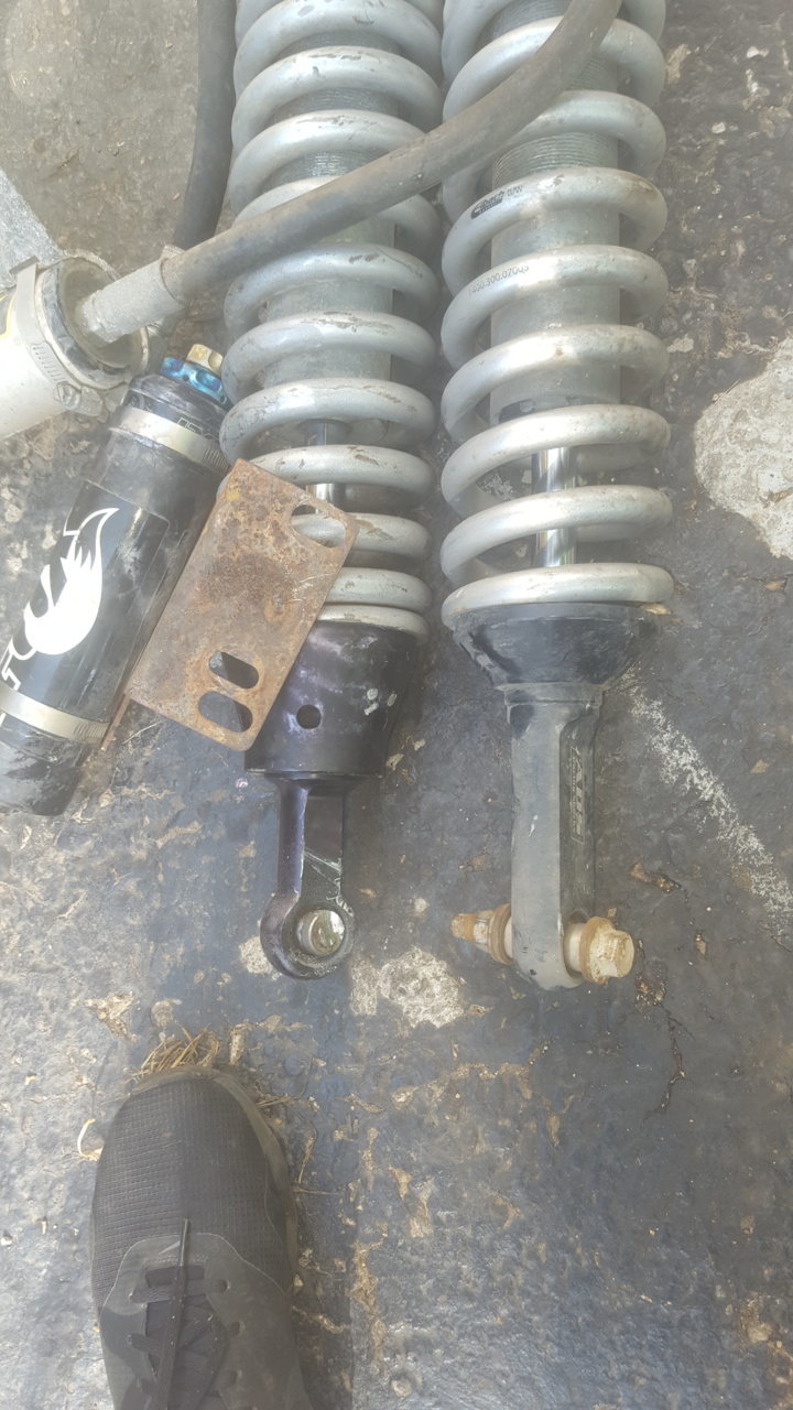

    1st picture compares rod ends (LT to MT)
    3rd is shock top hat to eyelet extended aka droop(~25.5 inches)
    4th is shock top hat to eyelet compressed aka bump(~19.75 inches)
    5&6 are wheel travel measurement so 12 inches minus 1/2in for axle bind

    after a long week of verifying and cutting/drilling/hammering a bolt out i was finally able to get the shock back in with a new bolt and lower eyelet uniball.
    its the correct shock for the application just odd lower rod end. i guess i just need to tweak the alignment more.
