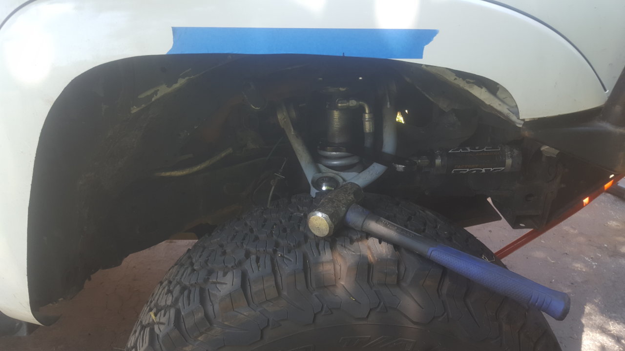

    Had the day off today so i decided to mess with the truck :bananadance:

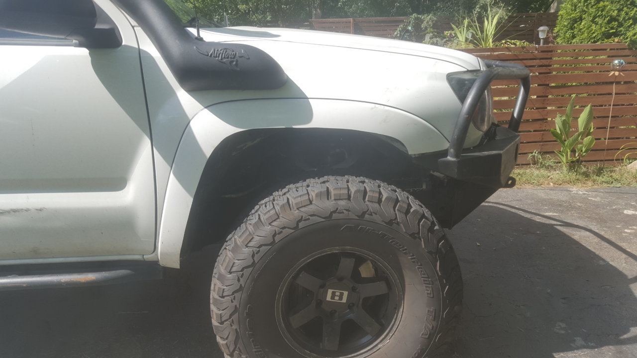

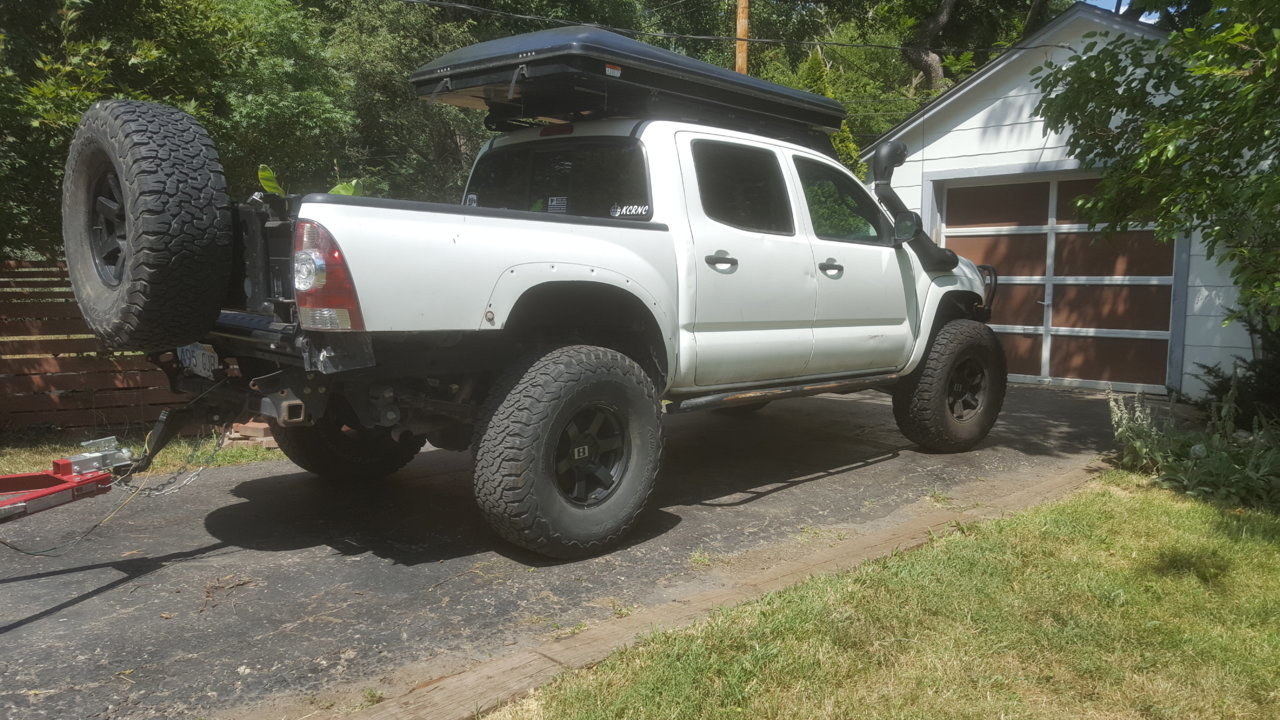

    Adjusted the preload from 3inches of threads down to ~1.5inches. Making ride height to the flare about 5in. That was not fun in the heat at all. About 50/50 split on up/downtravel now and axles are back to near level so i wont need to worry about boot rub.
    Driver outer boot has a hole in it. Passenger wheel bearing has gone bad. Passenger front cam is bent over.
    but i already have a new boot and total chaos cam gussets are ordered. Ill swap my spare gusseted spindles in and hope they have a good wheel bearing.
    Before:
    After:

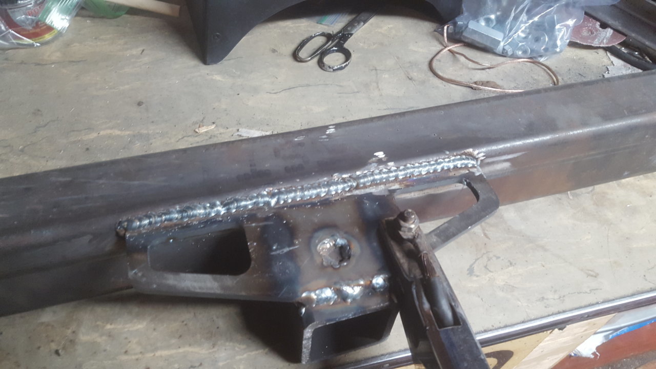

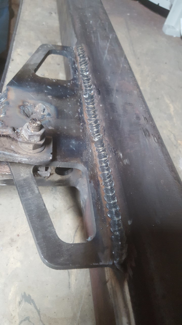

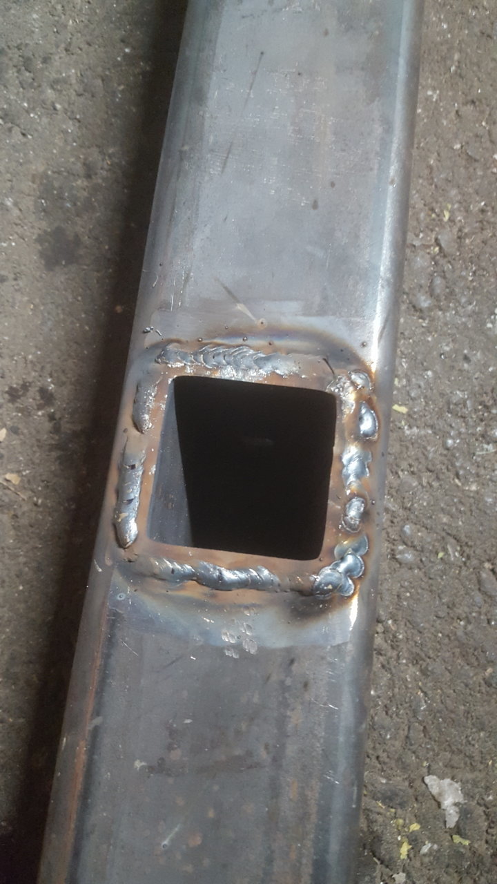

    few years late but i finally started working on my rear bumper tonight. not bad for not welding in a long ass time. very happy with how it has turned out so far. still need to make my frame mounts and cut it down to size.

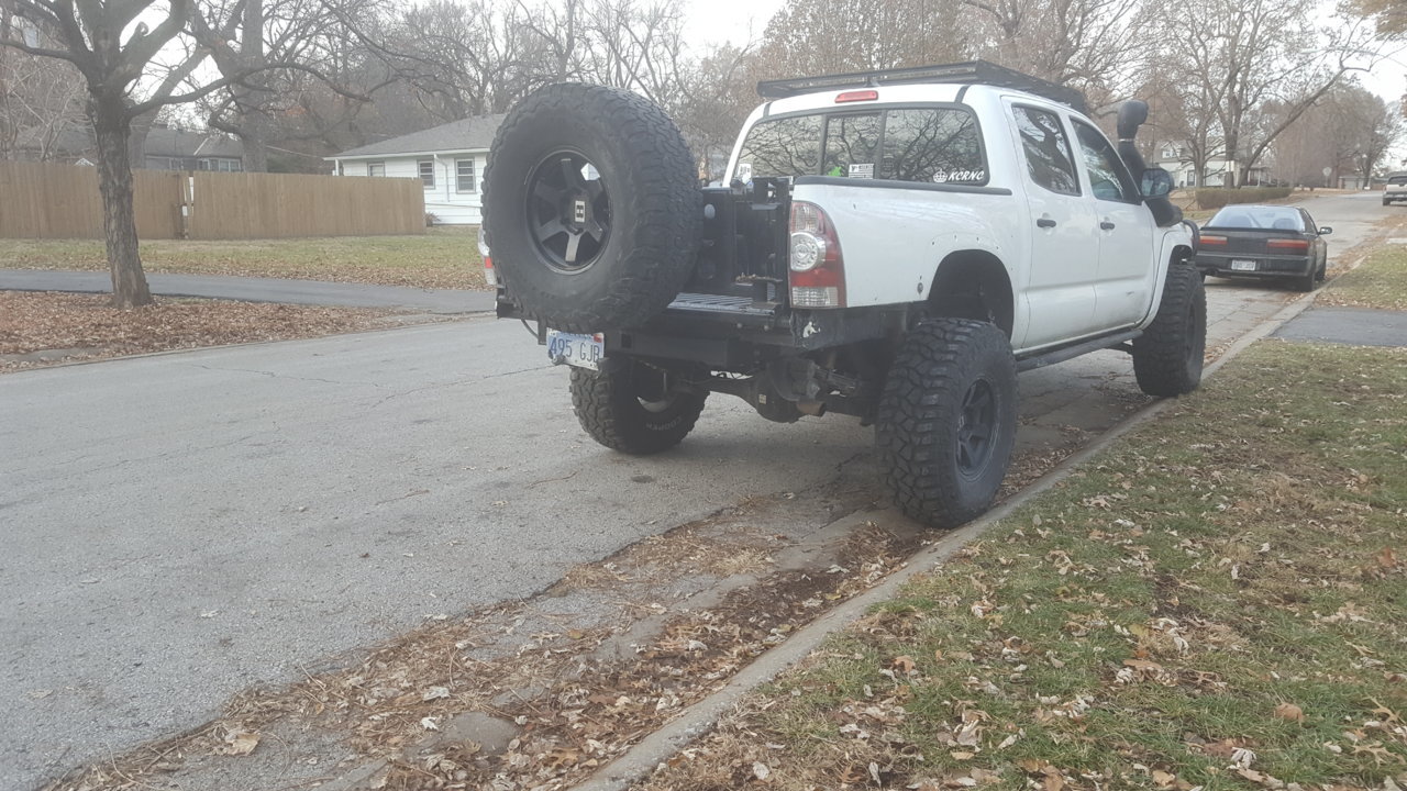

    i did a thing
