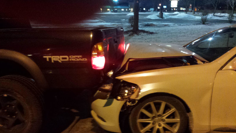

    unnamed.jpg my son was in the same situation. stopped at a light and the guy who hit him never touch his brakes. frame was bent, bumper toasted and the trailer hitch was embedded half way into the spare tire!
