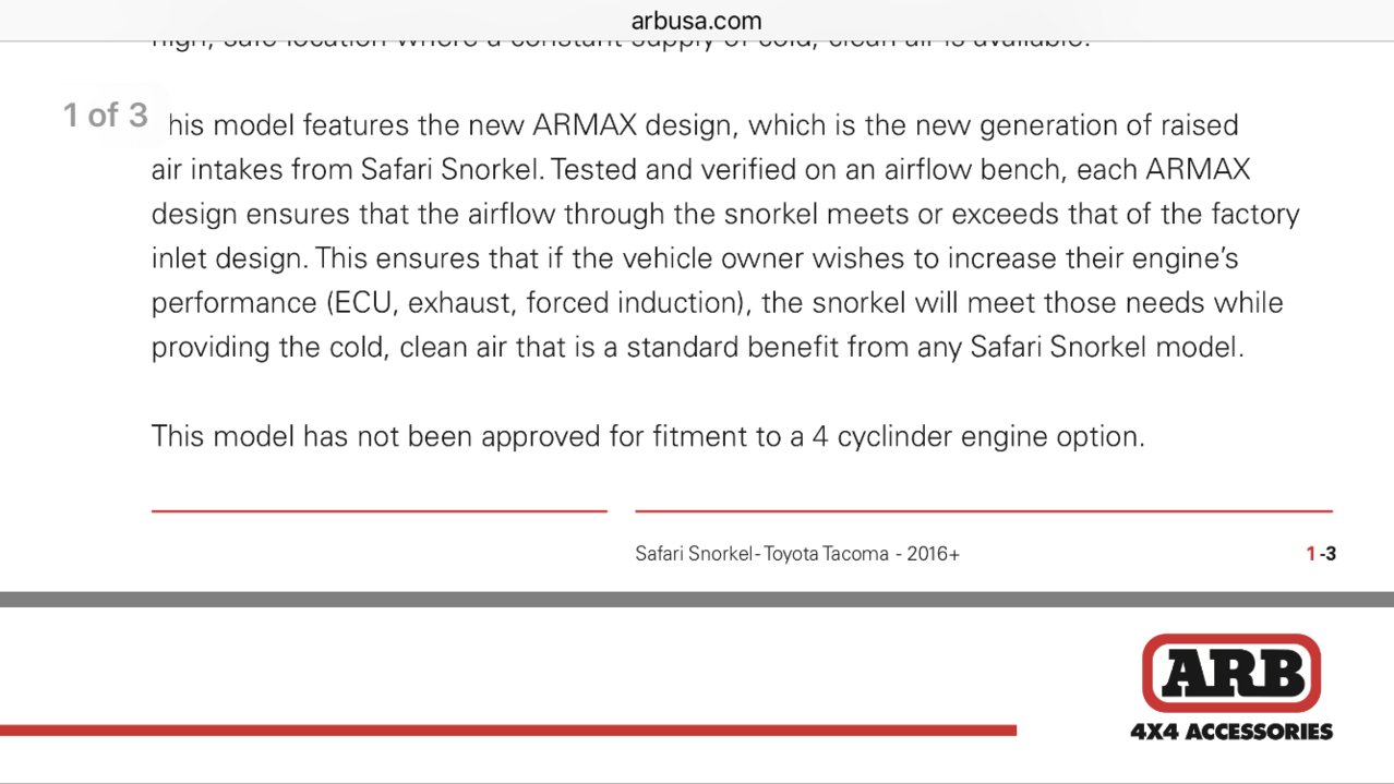

    Read the last sentence...

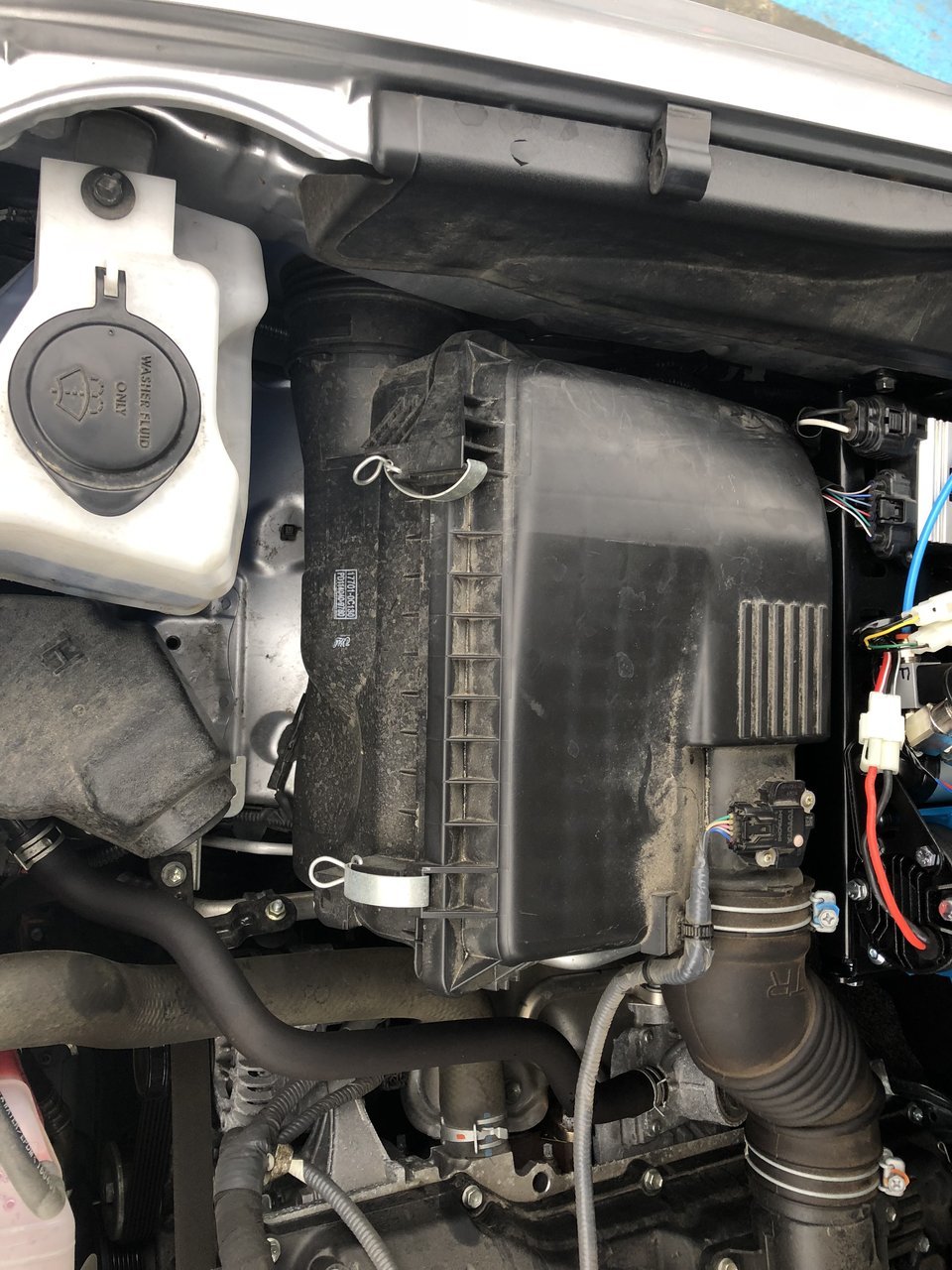

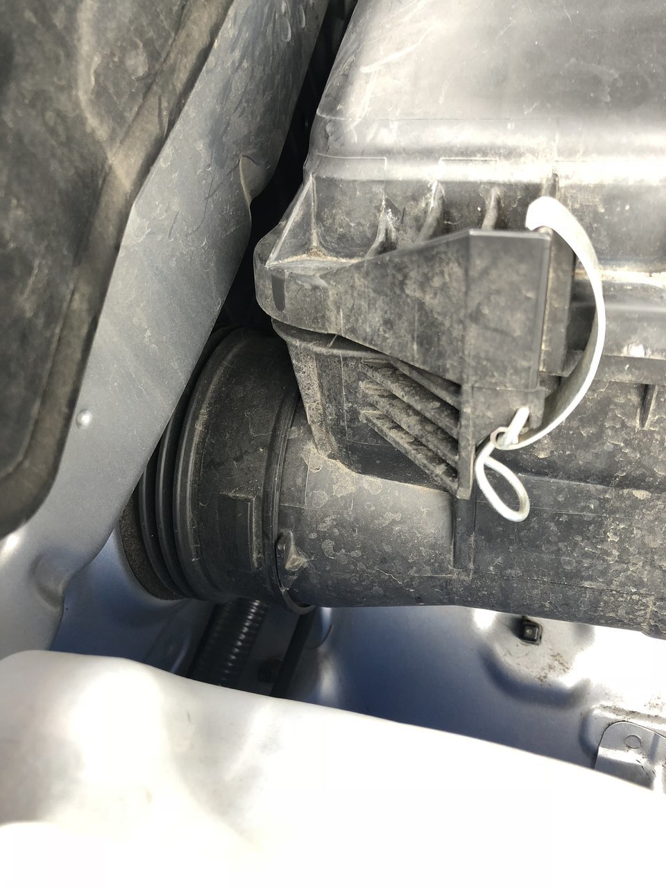

    However, pics say otherwise... pics of my 4 cylinder and from a 2016 v6 install.
    Awaiting on the fate of my taxes, if I don’t have to pay as much as I think I will, I’ll purchase and install myself. Pics clearly show it will work.

    Taka sadly doesn't post as much around here anymore, but he definitely got it to work!

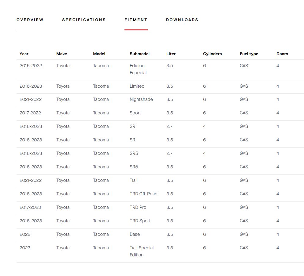

    little over 3 years later, it looks like ARB confirmed that it fits either engine and all trims for the 3rd gen.
