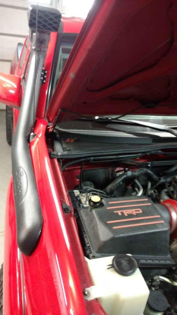

    08 I just purchased has trd intake with safari snorkel, so it is doable. I did not perform m the install, what info are you looking for?

    Well... not really anything to show from pics without removing fender liner and I don't have time to do that now.
    The PO mentioned the snorkel is for the hilux and it does not fit the fender perfectly.

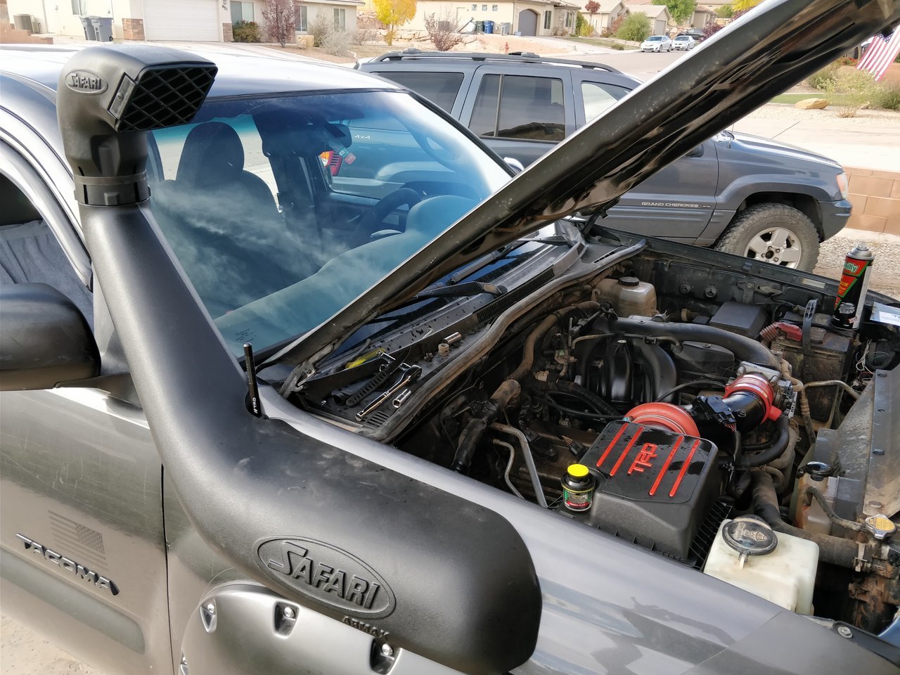

  19. Nov 12, 2017 at 2:33 AM
    #19
    unstpible
    unstpible Well-Known Member
    Aug 16, 2012
    #84909
    3,707
    Derek
    Cedar City, Utah
    03 4x4 boosted V6 Auto 341k miles
    CX Racing Turbo kit. TransGo shift kit. All Pro Apex bumper and skids. Smittybilt XRC 9.5 winch. All Pro Upper control arm's. Bilstein 6112's with 600lb coils. Eimkeith's lower control arm reinforcement plates. Perry Parts bump stops. All Pro spindle gussets and alignment cam tabs. All Pro standard 3" leaf springs. Bilstein 5125's rear. Extended rear brake lines. Rear diff breather relocation. MagnaFlow catback with resonator. Bluetooth stereo. Memphis 6x9 door speakers. Diode Dynamics SS3 Pro Amber fog lights. Single piece headlights. aftermarket grille. Anzo taillights. LED 3rd brake light. 4runner sunglass holder and dome lights. Master Tailgaters rear view mirror with 3 directional cameras, G shock sensors, and anti theft system. Honda windshield washer nozzles. Stubby antenna. Scan Guage II. 2nd Gen Snowflake wheels powder coated black. Cooper Discoverer ST Maxx 235-75/16 Denso 210-0461 105 amp alternator. Speedytech7's big wire harness upgrade. Aeromotive 340 fuel pump. Haltech Elite 2500. Tacomaworld sticker. Tundra brakes with Adventure Taco's hardline kit
    Any updates? I just installed the safari snorkel on my 09 and was looking for pretty much the same thing your doing but I don't have the TRD intake however it seems like it would be fairly straightforward
  20. Nov 23, 2017 at 5:31 PM
    #20
    unstpible
    Aug 16, 2012
    #84909
    3,707
    Derek
    Cedar City, Utah
    Safari snorkel with the TRD intake
