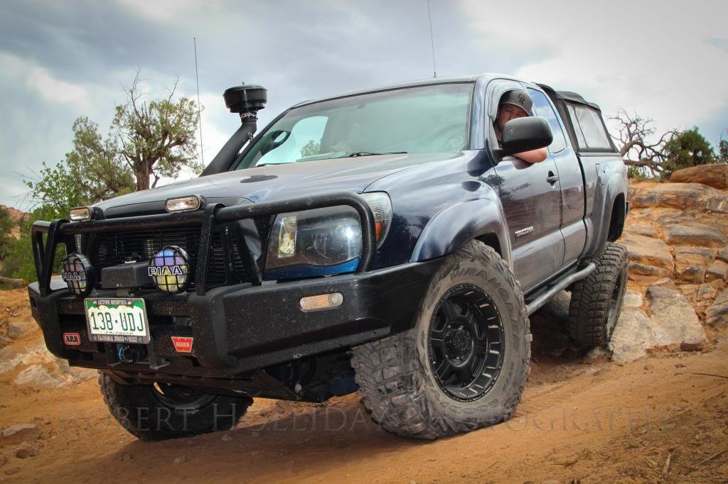

    i'm a fan of the airflow
    the larger hood sucks in a lot of shit though...watch out in big snow storms if it's wet snow..to help even more with dust i have a donaldson pre-cleaner
    RockTherapy2013-510-1_edited-1_zps6b05cd_d06b5f6d496b72bb611253fe931274e48a6d1e8e.jpg
    pre-cleaner helps a TON with the dust! did a week in moab for cruise with the normal hood on and after a week i tapped out a good amount of dust from my AFE filter. after a week in moab for rock therapy at the end of may, i used primarily my donaldson and insignificant amount of dust was in the filter. i caught more dust in the filter on my way home when i swapped back to the normal hood than 10 days in utah using my donalson.
    couple safari snorkels next to my airflow with donaldson

    big difference in the plumbing comes with the diameter of the tubing..4" throughout with the airflow..the factory tubing is actually slightly smaller than the airflow. so less restriction there. plus the tubing is made so you do not have to modify the inner engine bay to meet up with the factory intake like a lot of people have to do with the safari.

    downfall with the airflow is mainly aesthetics..lot of people don't like the looks of the larger hood and they stick up slightly higher than safari.

    Any charge air temperature or vacuum pressure issue w/ that precleaner?? I know Airflow has a TON of warnings about using the hood facing the right direction...

    i do notice a slight drop in mpg with the donaldson due to the air being sucks in versus jammed down it's throat..
    temps are maybe 1-2* higher with the donaldson...with the normal hood i see 0-5* over outside temps normally..anything >30mph i'm usually about outside temps
    normal driving i use the normal hood...dusty and snowy conditions i'll be using the donaldson. last trip to moab i was seeing sustained winds around 50+ i'd say coming at me, at that point i switched over to the donaldson for the rest of the trip because the winds kicking up all the dust around the state. and like i said, after 10 days of driving all around utah, there was insignificant amounts of dust that made it to the filter. so it did its job well i'd say!
    so..
    temps...slightly
    vacuum...not that i noticed
    airflow...restricted enough to slightly drop my mpg
    daily driving..not recommended, stay with the main hood
    dusty/snowy..highly recommended
