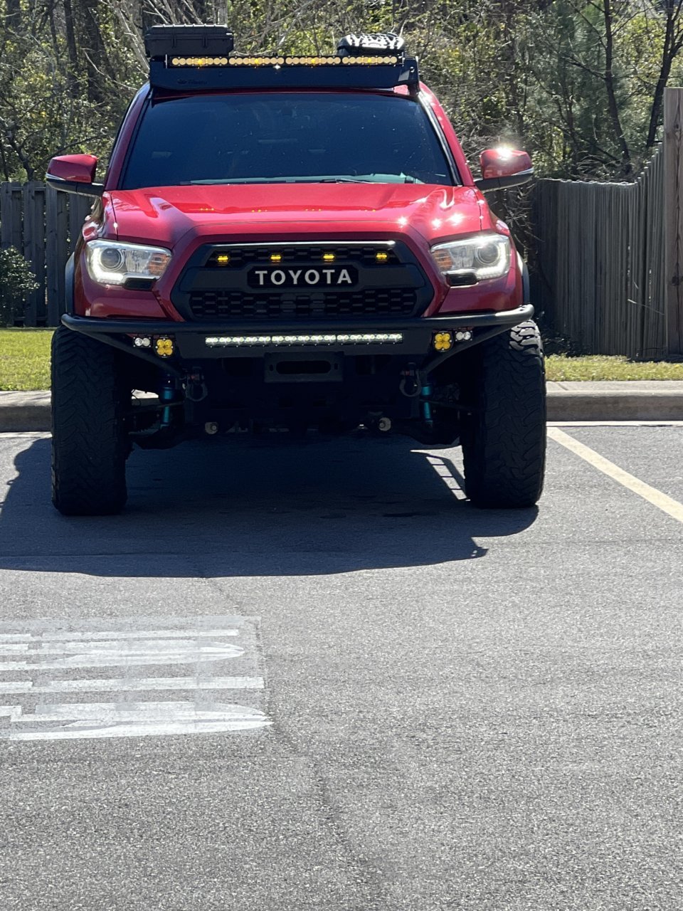

    Hey MR, ty. Nice rig! Just trying to make the ride as smooth as possible for my wife.
