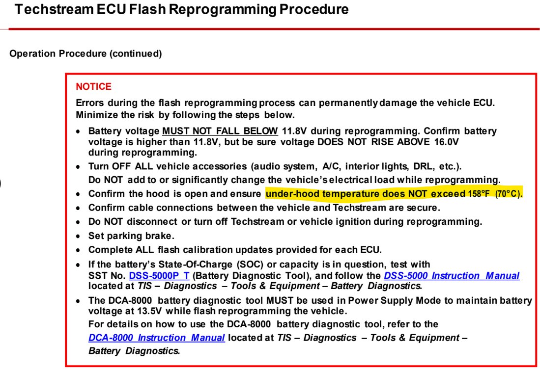

    This is all that I got:
    From that, it can be assumed that some underhood temp above 160F is good to go. Most nylon parts are good to 185F minimally.

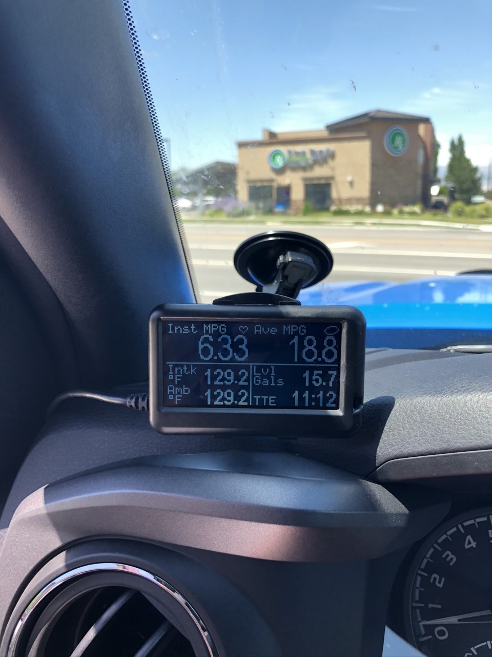

    So I finally had a chance to try and test this out a bit more. I set up my Ultragauge to display both intake temp and ambient temp and guess what? They stayed in sync for the entire 10 mile drive I did! So I guess what UG thinks is ambient temp is actually just intake temp; perhaps it is supposed to just represent ambient engine bay temps. Either way, I feel like the mystery is solved.
