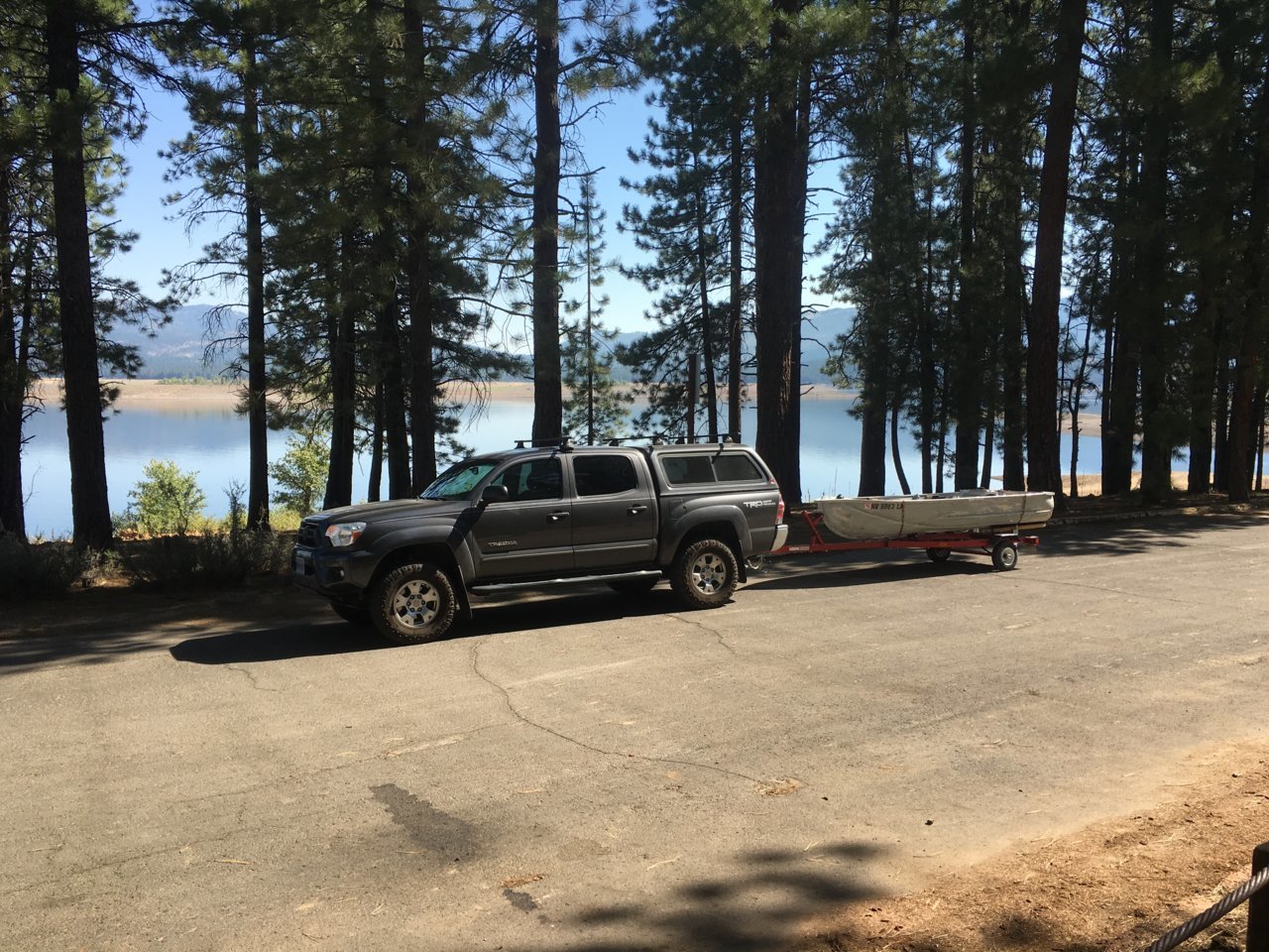

    the tires on the Harbor Freight trailer would disintegrate before the boat and trailer would get off the ground. The boat and trailer was probably less than 500lbs (not including the motor that I had to pull when towing because I was afraid it'd rip the transom off).
