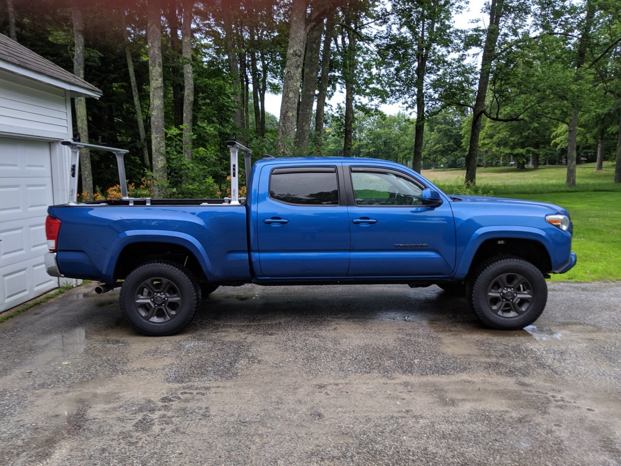

    I put a 3 inch lift kit in from Rough Country, came with rear shocks. The whole kit was $300. I find ppl around here find anything with that name a sin, but it was relatively inexpensive, install was easy, and it looks absolutely fantastic. I do not notice any ride difference at all, except for being higher than most everyone else, which I view as a plus. My brother in law is a mechanic and he said that if you decide to put a lift in you may get a little quicker wear on front end parts, but that's worth it to me in how it turned out.
