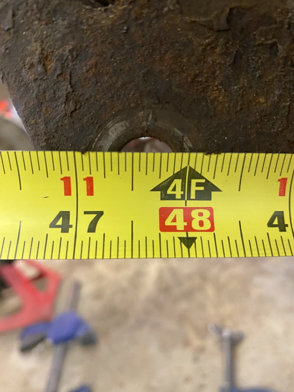

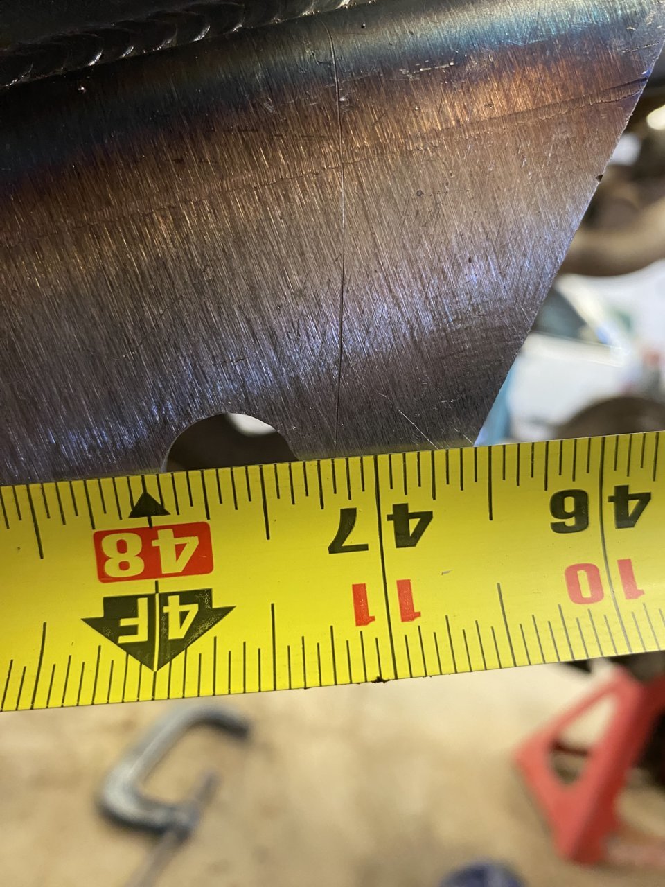

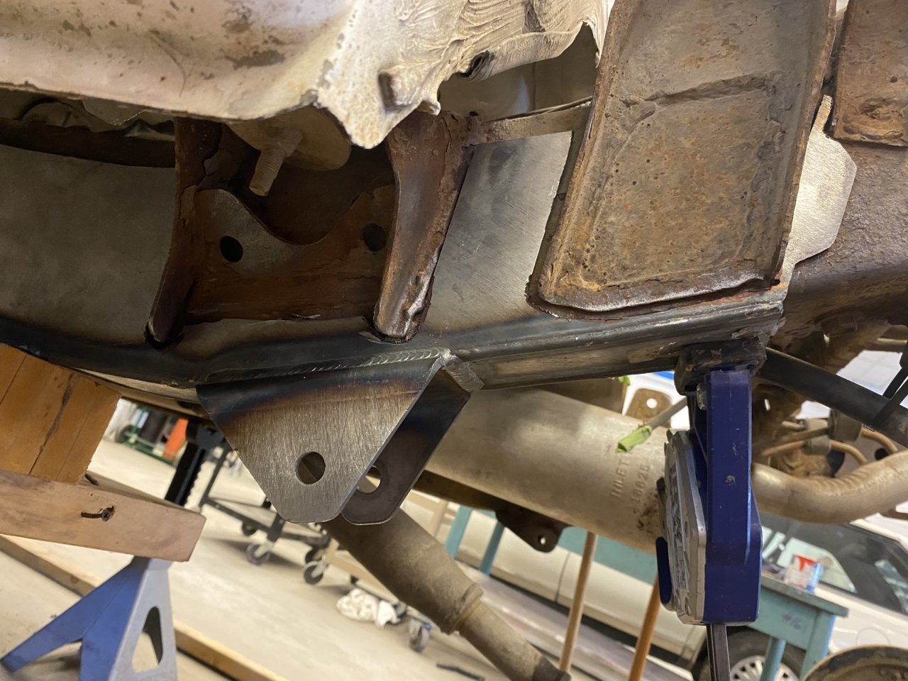

    I've got a quick question about safe t-caps.
    I've replaced my leaf spring hanger and I still don't seem to be getting the same measurements as the other side. I seem to be a little over 1/4th of an inch lower when I measure to the center of the hole from a fixed point on the frame (vertically) and then about 1/8th of an inch closer to the front of the truck. This is measuring the center of the hole once again. I do seem to have the diagonal measurement super close which I find weird. it does seem to be cupping the frame properly
    I'll have more pictures tomorrow of the measurements. I'm not sure if it even really matters or if the leaf spring will sort it out
