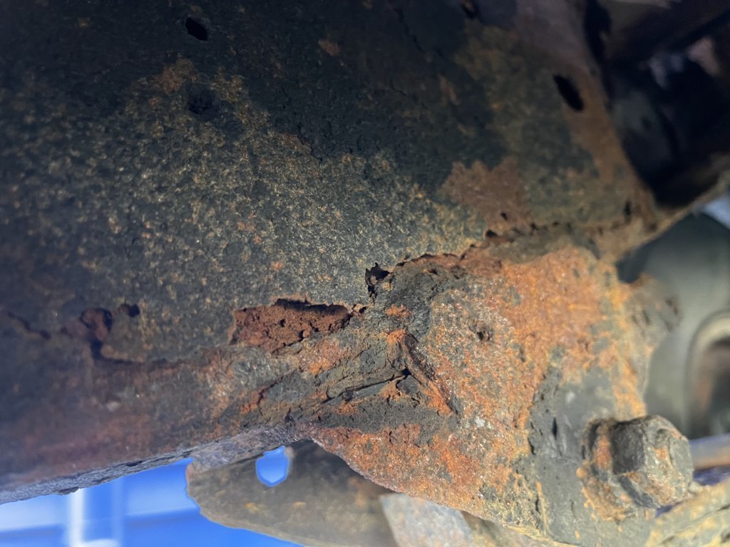

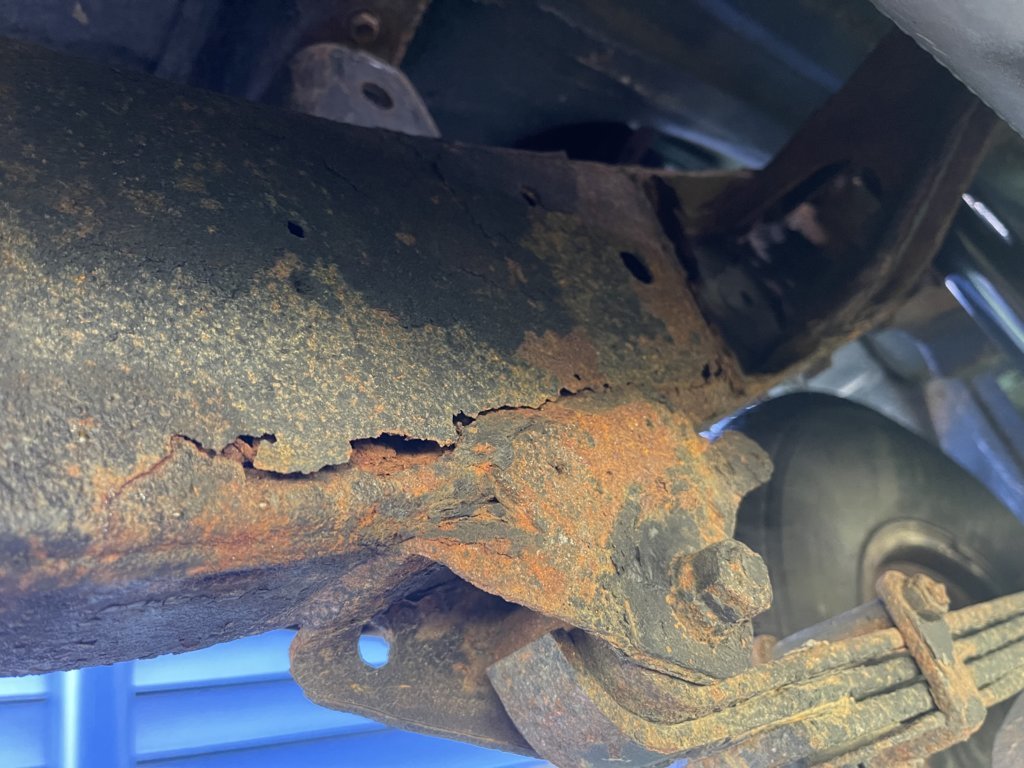

    First post on here. I have a 99 Tacoma TRD 4x4 Xtra Cab. You can see I’m dealing with the super fun frame rust that has resulted in a crack here.
    I am considering hiring a pro to install a safe t cap, but am having a difficult time getting responses or finding someone willing to install here in Nashville, TN. That said, I might be stuck DIYing. I’ve been researching lots of videos, ChatGPT, articles, etc to educate myself. I am pretty handy, do a lot home renovation work and do good work, and I do dabble in car stuff. But no welding experience. I understand this isn’t ideal to learn with since we’re talking structural. But I’m feeling a bit SOL and may need to just DIY.
    I’m thinking about picking up a HF MIG 140. It’s 120v. I understand 240v is preferred — but it seems not in my financial capacity. I have a solid brushless angle grinder. My plan is to:
    1) cut away rusted material
    2) take opportunity to clean up inside of frame best i can with shop vac and pole with rare earth magnet attached. Grind away rust inside immediate are cut open. Prime, paint, use fluid film best I can inside whole frame.
    3) grind away to bare metal area to weld to.
    4) Tac Weld safe t cap ( obviously clamp in place, measure, etc)
    5) weld in place. My best education is watching a couple hours of YouTube, plus I’ll take several practice welds and test strength first. Im planning to use fluxcore as I don’t have access to or a place to store gas. Unsure on what wire to use and would welcome recommendations.
    6) once weld is complete, prime, paint with a rust preventing paint, and fluid film. I plan to fluid film once a year moving forward.
    6) I’m planning to take time later this summer to hit the whole frame with bed off with my angle grinder. I’m hoping to grind away rust. Frame is definitely rusty, but this is the only spot with holes/cracks. The rest I’ve taken a hammer to and while there are a few thinner spots, Right now the frame feels solid everywhere else.
    Am I thinking this through completely? Anything I’m missing? Any concerns or tips anyone has?
    if anyone has recommendations in Nashville for a solid automotive welder I gladly welcome it!
    such a shame this has happened, I’m sitting at only 78,000 miles, interior is in great shape, and engine runs wonderfully.

    I would not do it as a first major welding project, especially with a small welder and a frame that far gone - I would bet that finding clean metal is going to mean removing a lot more than you think, and you will be welding in very awkward positions with a very low power machine and questionably appropriate wire.
    Maybe expand your search for pros to include those who are not necessarily automotive specialists.

    I suggest doing all the repair work yourself and finding a mobile welder person to come do the weld. You do the cutting and fit up the sleeve (which means cutting off the spring mount) then have a welder come do the weld. I’m going this route for my Land Rover. Welder charges $85/ hour with a $200 min said he’d need a couple hours . Heck I paid $700 for a guy to weld the Taco and he had it for a week.

    Making new reinforcements, plates, gussets, etc is all easy and really the hard part for the whole thing is all the prep work required. Hitting any and all rust with a wire wheel (please wear goggles and a respirator), cutting off the weakened metal that's getting replaced (easy with a plasma cutter, less so with an angle grinder), all takes time and is a job in itself. However, if someone did all the prep work, I'd gladly take on the job for welding on Safe T caps and other reinforcements needed.
    I bet if you did all the necessary work (without having to buy a welder), you can easily find someone to get the job done for you.
    Get the bed off for the easiest access. It's really light and would just require you and a buddy to lift it off.

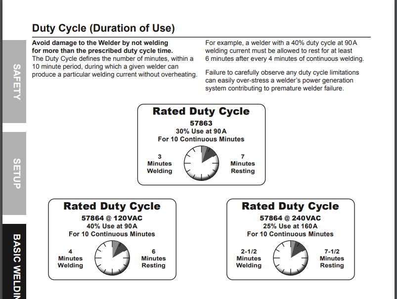

    -Smaller 120V welders typically have low cycle times at high output - be aware

    The little, cheap 120v welders will do this job. It may need a break now and then and a 30 amp circuit or higher is best, 20 will do it but may trip now and then.
