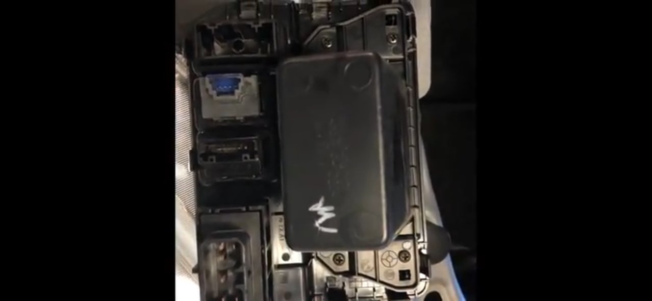

    Found a video on that panel. Doesn't look lile the safest place to Drill....

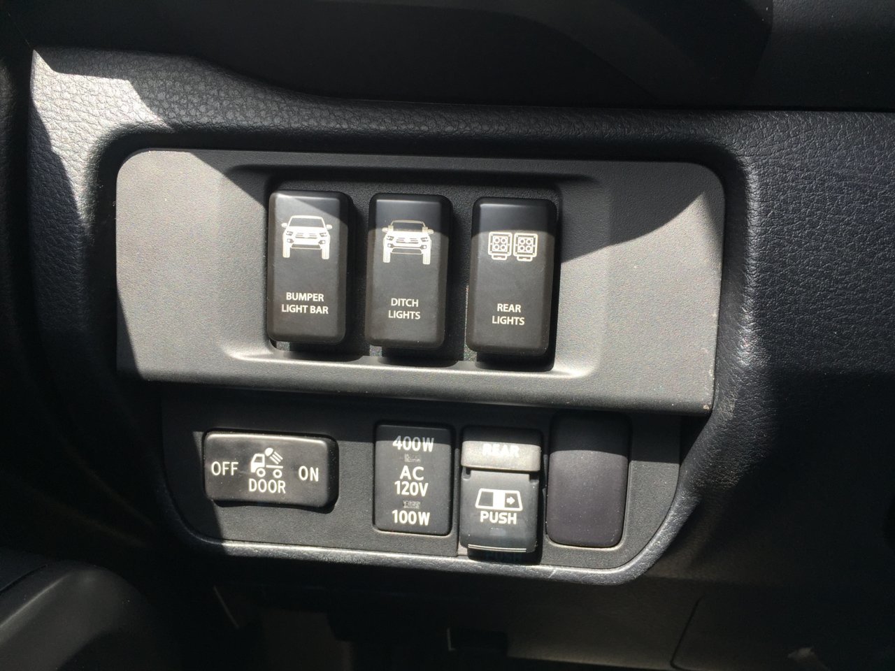

    Why drill a hole? Ditch that useless cubby... what fits in there anyway? This panel is from @CaliRaisedLed and the switches are from CH4X4. Mine are wired up to Rigid lights but I can’t see why it wouldn’t work with KC. Looks much cleaner than a hole drilled, actually looks almost factory. I also have a Relay holder under hood from @ragofabrication all told there’s gotta be less than $50 worth of parts.
    Beerpayzdabillz and grubburg[OP] like this.

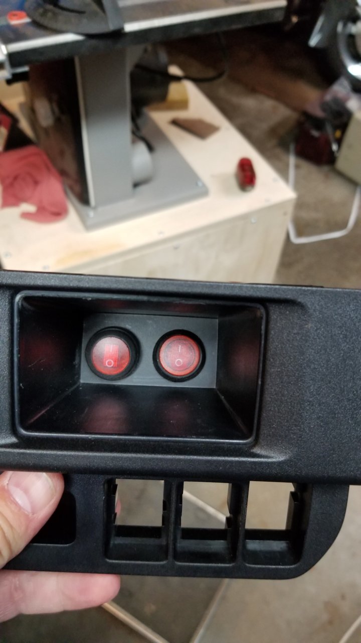

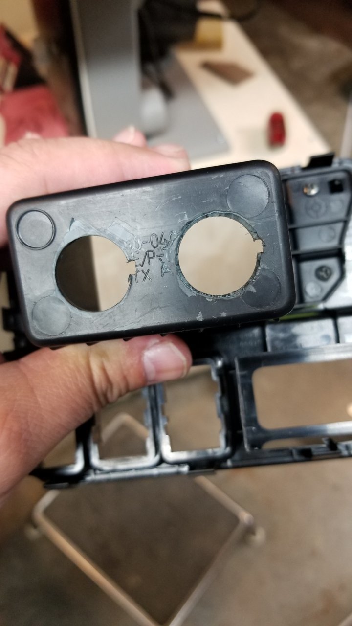

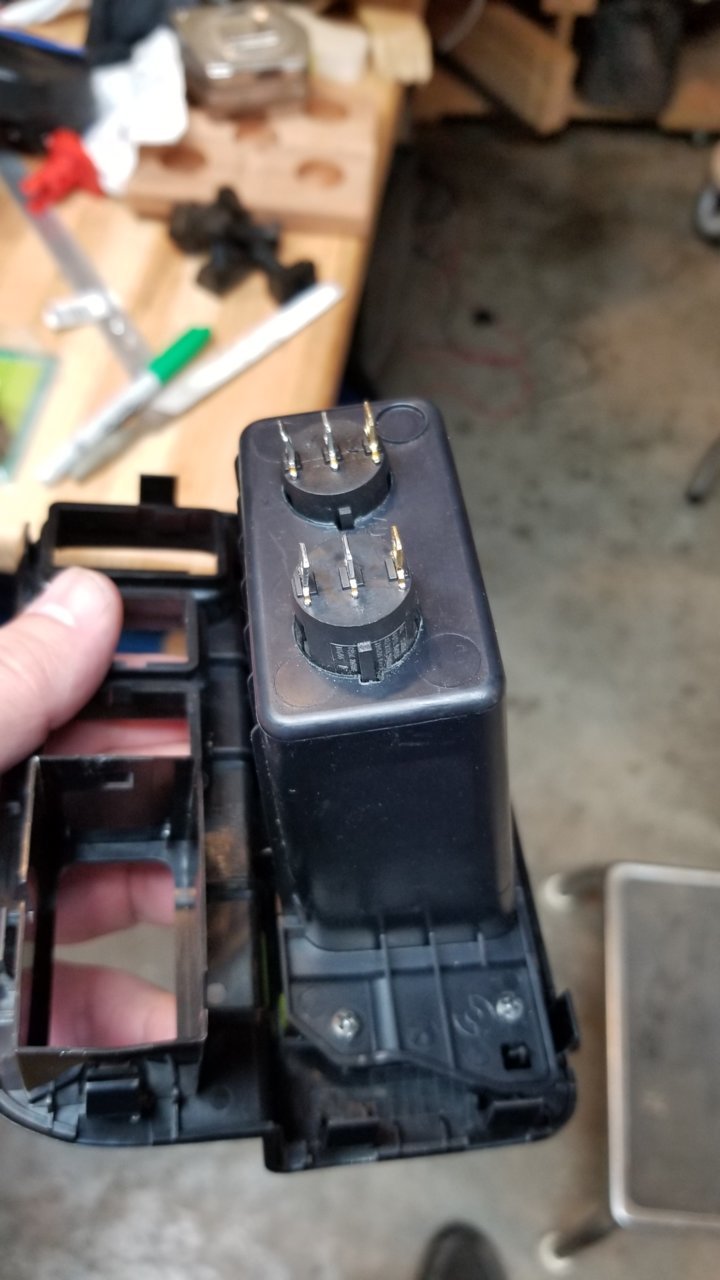

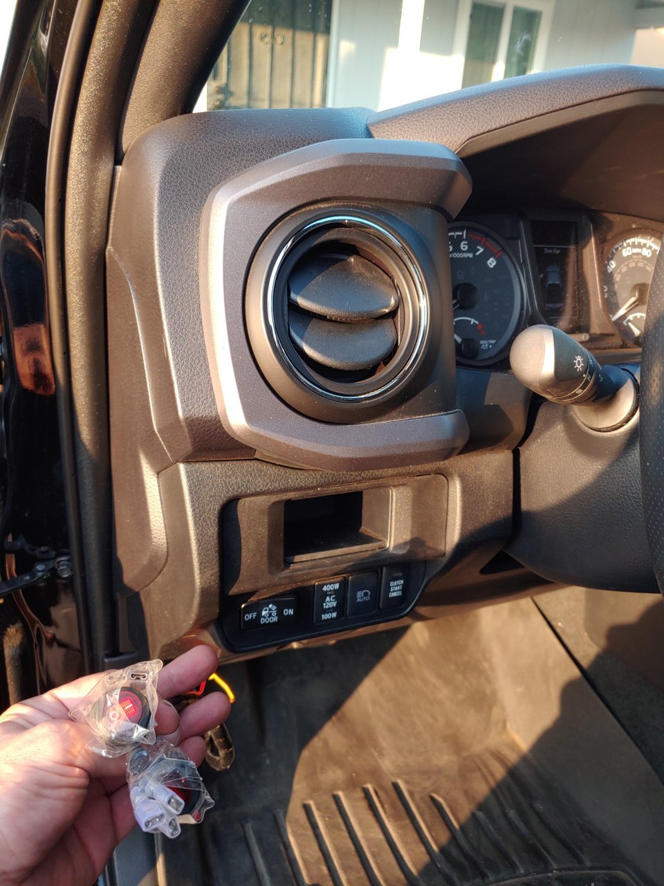

    @grubburg I did that before I put in a switchpro. I liked it pretty well and if you laid it out better I think could get 3 switches. I used a 3/4 forstner bit in the drill press and a small file to cut the groove. Super discreet and I could still wedge my wallet int the cubby. 20191027_202447.jpg 20191027_202820.jpg 20191027_202940.jpg
    grubburg[OP] and YOTA 4X4 like this.
