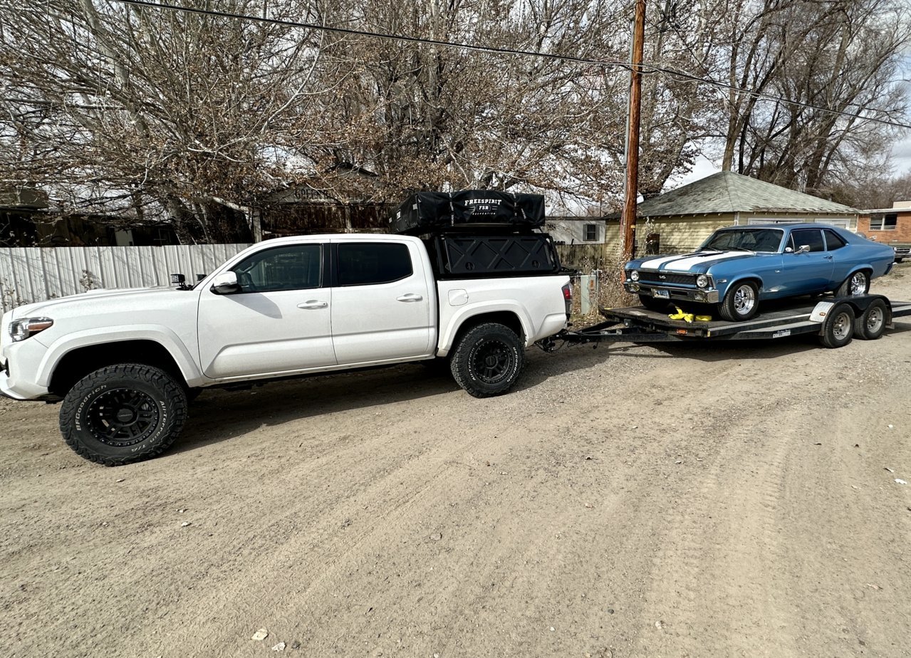

    Across town (if < 20 miles and no 70 mph highways): fine, Longer than that: F to the N-O
    Why no:
    1. You will have difficulty gaining and maintaining speed with that much weight behind and will need to be in 3rd or 4th gear to rev your Taco into the 3-4-5k RPM band where peak horsepower and torque is achieved
    2. With that much weight you will be bouncing around on stock suspension
    3. The RX on a trailer will exponentially increase drag
    4. By law, towing that much weight (and common sense for safety) you will need a brake controller - I am not certain if 2nd Gen TRDs came wired for towing like the third gens do; you will want to verify you are wired for a brake controller and then install a decent brake controller
    I only pulled this with my Taco because my dually was hooked up to another trailer and it was < 6 miles to my place. Keep in mind I have heavy Dakar Leaf springs from an OME-005 kit, my TRD Sport came wired for towing and I added a Red Arc Tow Pro Elite brake controller. If I were you I would seriously consider renting a full size from Enterprise, Budget, or Hertz (or hell, even Home Depot or Lowes) that is wired for towing and has a factory integrated brake controller.
