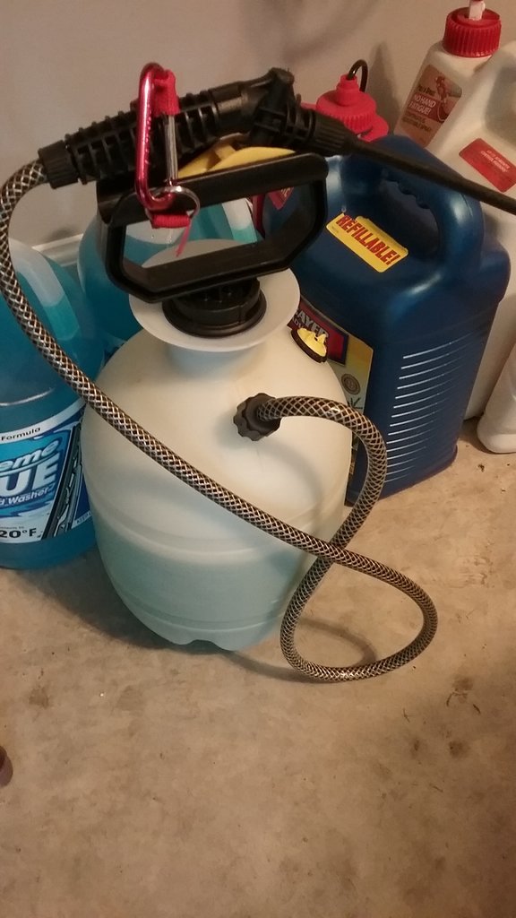

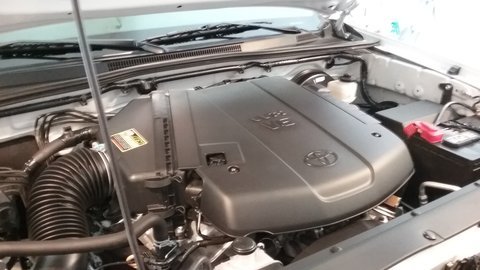

    Simple Green cut 50/50 with water in a pump pressure applicator.
    Cold engine. Let it soak for a minute or so. Rinse with low pressure setting on the garden hose nozzel.
    No worries of water intrusion as the engine
    compartment is not a sealed environment. It's designed to handle a certain amount of moisture. Just use low pressure.
    Do this every couple of months and you get this.

    I would recommend guaging which product to use based on how dirty your engine is. I usually just use car wash soap diluted with water in a spray bottle. You have to be careful with some of the degreaser products as they are caustic to aluminum. I also don't like to use the aerosol degreaser as it is solvent based and will make your interior smell like solvent when the hvac is on. A wheel brush with a long handle works well to get some agitation.
    something like these

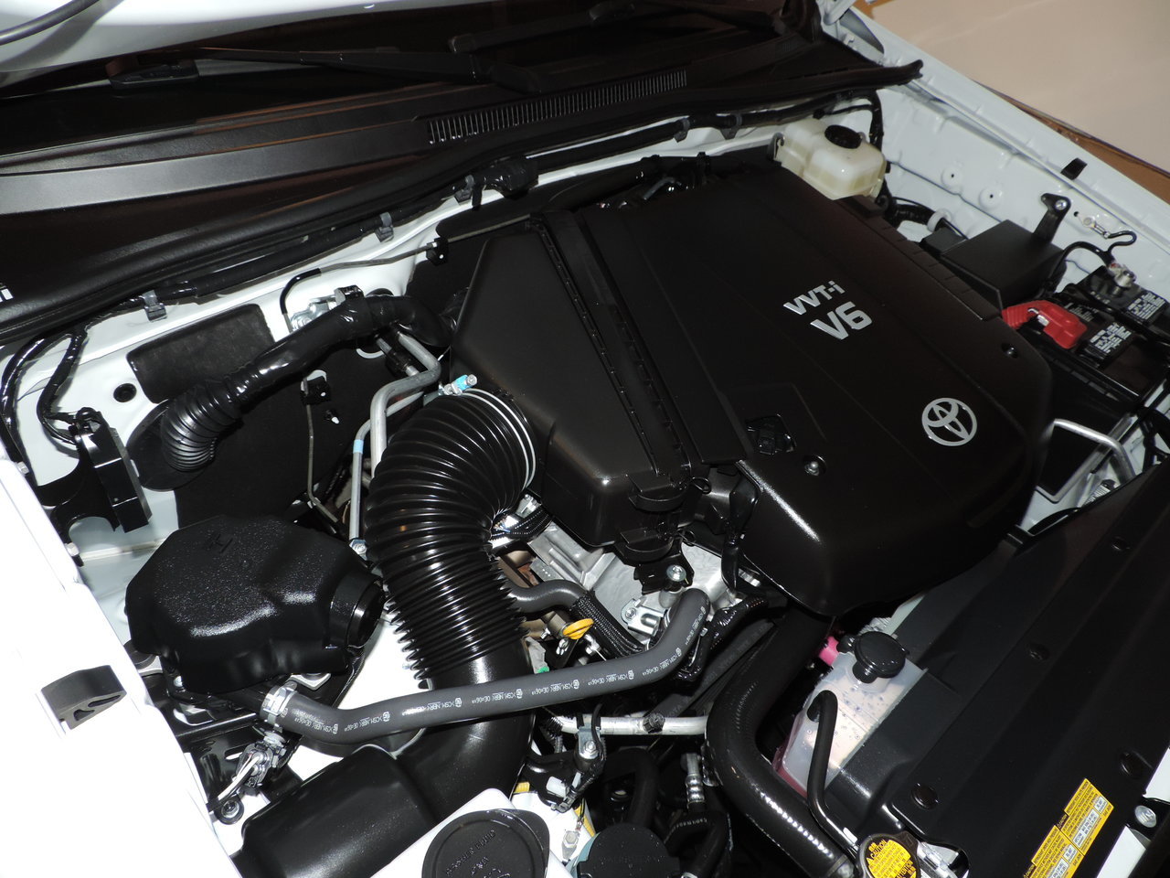

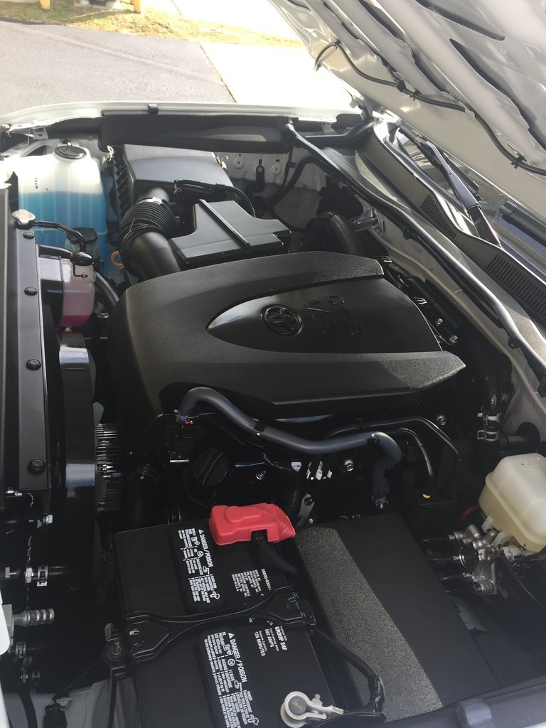

    My 2017 on the left my 2014 on the right......
    Simple Green @ 100% let set 20 minutes and hose off.....
