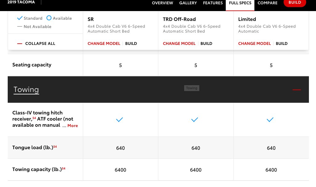

    This is what I found. Off road will be very close As tow package is likely standard

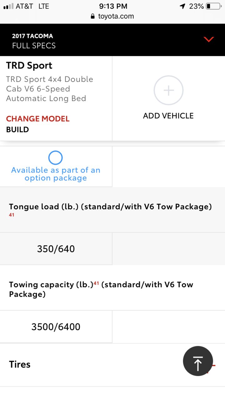

    The tow rating on that truck is 3500. I'm sure people have pulled more with no issue, but you need a ttailer brake controller for something that heavy

    How is it 3500 pounds? Pretty sure the 4x4 comes with tow package standard.

    The sport with tow package has a tranny cooler (mine does at least and its a 2012) not sure if the 3rd gens all have trans coolers or only tow package trucks do.

    Just depends on if shes got the tow package or not. I don't know if all 4x4 trucks come with it or not

    Not all tacomas came with a tow package, most if not all do now, but not in the first years. make sure you are certain before trying to tow that much weight. Lots of dealers or people will install a hitch reciever, this does not mean you necessarily have an tow package

    I’m confused by your question. The camper I would be pulling is approx 3500 poundsdry. I do have a 2017 off-road that has a receiver hitch.

    Having a hard time viewing the whole screen on my phone, does that say it DOES have ATF cooler?

    You can check by vin, but the trans cooler should be located in front of the a/c condenser, just behind the grille. It will look like a small radiator. That's where I'd check first.
