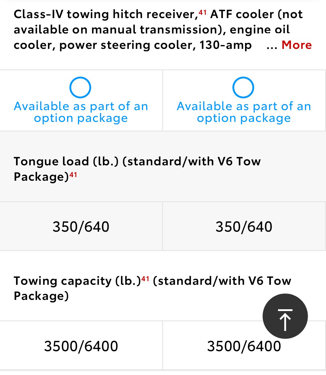

    Tow package comes with auto trans cooler, power steering cooler, oil cooler, class 4 hitch, 4 and 7 pin connector and 130 amp alt

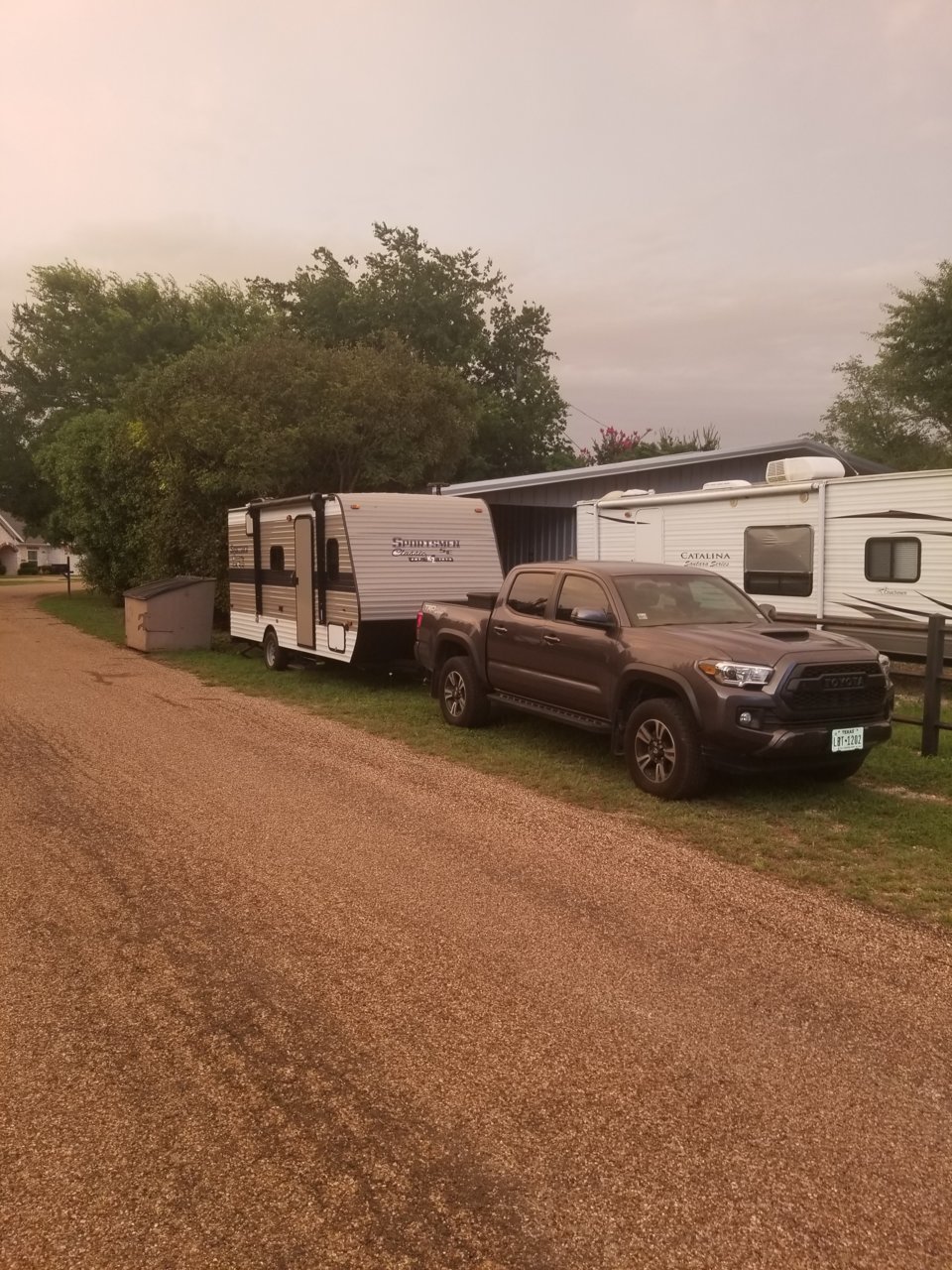

    Celtic Hutcheson
    Celtic Hutcheson [OP] Active Member
    Jun 22, 2019
    #297086
    42
    Central Texas
    2017 Red Tacoma TRD Off-road 4x4
    3” lift, custom leather seats
    You saved my life lol..I looked and I do have one!

    OP - Are you inquiring about towing with a bumper hitch or a class IV receiver tow package?

    You're good to go!
    She has the equipped hitch and tow package.

    I was pretty close to 6,000 pounds and towed this little Ranger above Salt Lake back to Blythe. There are better trucks for this job. When I started on my journey I was not too sure if the Blue Taco was going to "pull it off." After I managed to get through the Salt Lake construction and traffic the trip was not too bad. Down hill really surprised me. Low gears hold the speed down with very little use of the brakes. Only a few times, when some dumbass cut in front of me and slammed on their brakes, did I smell the brakes. Just leave plenty of room for safety because these brakes are not made to stop anything close to 6,000 extra pounds. But, yeah, 6,000 pounds, hopefully not through big city traffic, is about the limit.
