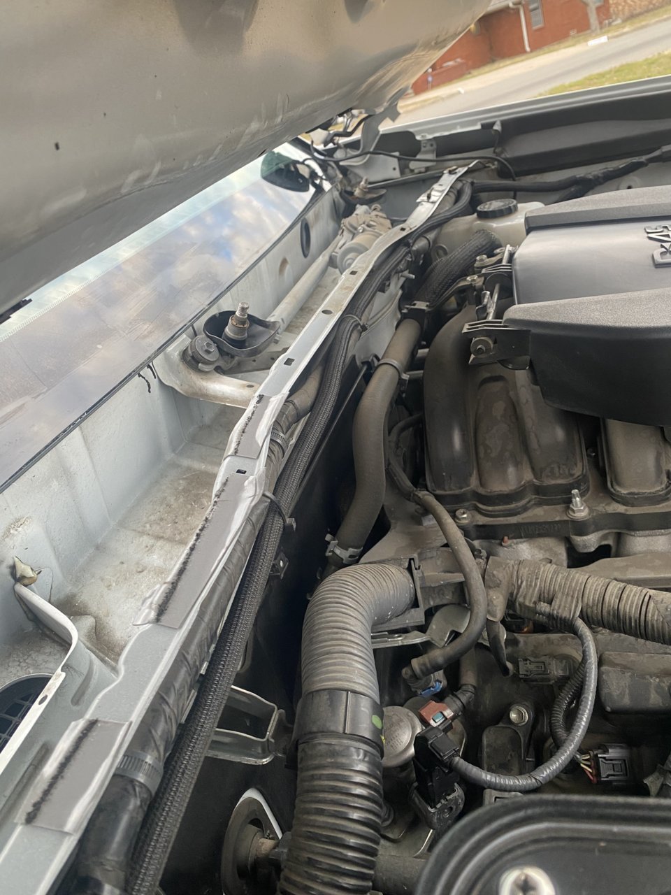

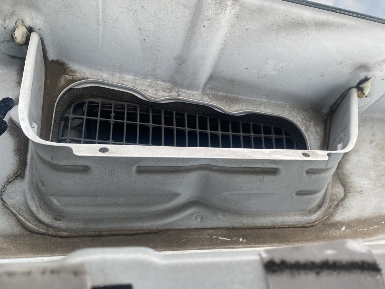

    638726A9-9689-4683-8426-E1E2EF837AEB.jpg 777A511F-CECF-4AC2-8A53-2B6404A0D9D3.jpg So I had my windshield replaced. When I picked up the truck I noticed that I had a significant amount of new engine bay/induction noise now in the cab like something wasn’t put back together correctly. I pulled the cowl only to find out they broke all the tabs on it and had taped it down with 3m. I’m beyond pissed so I’m going to try and get my money back I don’t want them to fix it because I don’t want them to touch my truck again.
    Does anyone have photos of inside the cowl where the cab fresh air intake is. I feel like it’s missing a part. Is anything suppose to clip into those two open holes on the lip of of that sheet metal at the top of the intake.
    TIA

    Do you have the (2) #4 cowl top panel braces?

    I don't see them. That would be under the cowl right since it's a brace?

    I'm not sure what would cause the increase in induction noise like my intake got 4 times louder the only thing I can think of that could cause that is the fresh air intake from that cowl to the cab. If the windshield wasn't sealed right maybe that's the issue idk. It's not leaking I just got rained on but maybe because its sealed good at the top and not the bottom.

    Yes I would assume looking at the diagram.

    Off the wall guess here, and just gonna play devil's advocate; maybe they cleaned out 3 lbs of leaves and pine straw from that intake and now its clean and not clogging outside noise :notsure:
