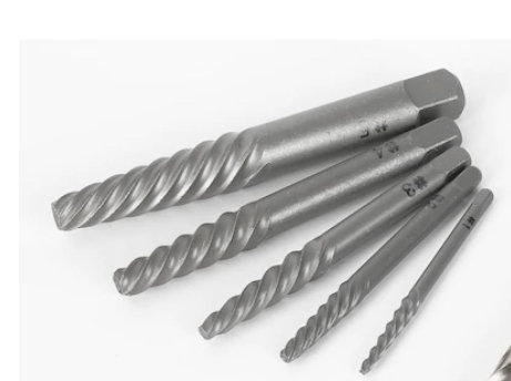

    Get a nut cracker
    HondaGM likes this.

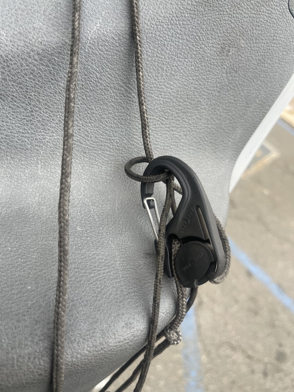

    Penetrant repeatedly over day’s first. If you already tried loosing you might have bent and weakened it so be prepared for it to snap off.
    After penetrant treatment take your line wrench or a 6 point socket to it. Put tension on it and tie it off with string or something. I have some of those cam jam nitize things that work really good for that. Then just leave it sitting with tension. You can pluck the string like a guitar to check if the tension loosened.

    Here’s the cam jam nitize thing I mentioned. Makes it easy to hold tension, then make it a little tighter if needed.

    If it twist off, go with an extractor.
