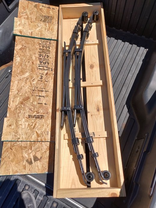

    Finally called in for my TSB leaf springs. My buddy is an adviser there so I told him to just load up the parts in my truck and let me handle the install. Aint nobody got all day to wait for that install! Itll take 45 minutes tops on the lift with some air tools! :D

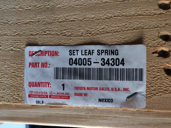

    Did they ask for the old ones back?

    SC 2.5
    Not at all. They loaded up a huge wood box with the springs in them along with hardware. I'll post a picture when I have some time. I noticed that I got the 34304 from the serial number on the side of the box but they are 4 leaf springs. Ive been reading some information on this thread about the two different variations and the tsb has been out for awhile. I'm thinking they updated the 34304 to 4 leafs, which seems contradictory to what some members on here are stating the serials are correlated to in terms of spring quantity.

    Here's what I picked up from the dealership today. They also included new shackles, ubolts and the ubolt "retaining bracket" that goes underneath the axle. All in all, it was a measly 10 minutes in the dealership and out.

    Oh ok so the regular (34304) springs are now 4 leafs just like the heavy duty ones (34404). Did you get the harsh ride TSB done years ago? It seems like people with the harsh ride TSB done in the past have not successfully received the correct 34404 springs for this recall after skimming a few pages of this thread. This is disturbing.

    From the parts I have in front of me, I believe that is true. I never had the E02 done previously and am still on the original leaf springs from 2007 with 170k miles. They're pretty communicative and squeak at even a fly sneezing at my vehicle.
