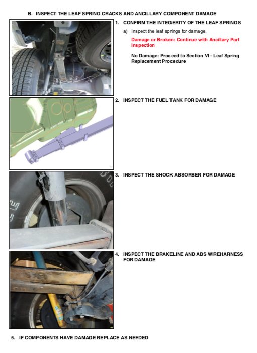

    I would love to be able to read that Toyota notice...
    are you able to post the complete notice here?

    PDF attached.

    Thanks for posting the pdf. I'm doubting their torque spec on the U-bolts. They have it at 37 ft/lbs. I think that was supposed to be 73 ft/lbs. Having them under torqued will cause major axle wrap every time you release the brakes and hit the gas.
