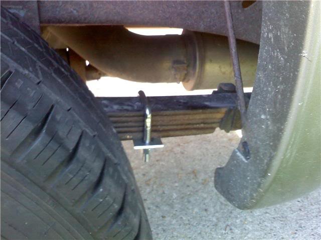

    I come from the diesel truck world where you clamp over load springs regularly for traction and axle wrap. Its very common. You wont find a pull truck that isn't clamped.

    Materials can be picked up for 25-30 bucks from Tractor supply. I had my leafs clamped on my old truck. Planned on doing this truck but then this whole recall thing came up so I'm waiting to see how this all pans out. Probably would help a lot of people with their sag as well.

    Doesn't that essentially eliminate all the articulation from your leaf pack

    Tire rotates one way. Spring pack rotates opposite direction. Leafs in rear separate, leafs in front compress.
    Putting a clamp in the front will increase spring rate only. Putting one in the rear will reduce axle wrap under hard acceleration.
    The springs on my chevy 2500hd without clamping were 10x stiffer than this Tacoma and I had the front and rear clamped with no issues. That's with heavy towing, hard acceleration, and 1006 lb/ft of torque. IMO these Tacoma springs could use some stiffening up.

    Maybe under acceleration , I'm talking about articulation Ie drooping the rear tire
