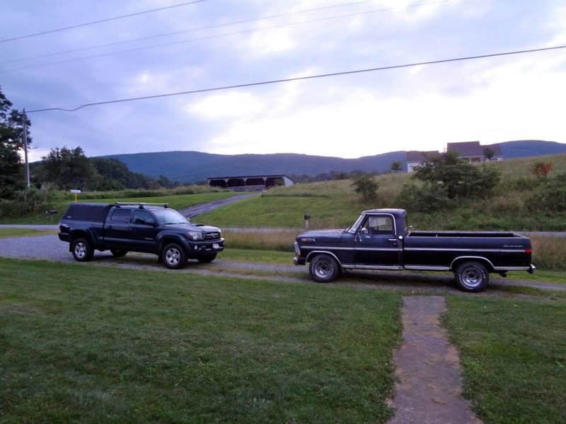

  4. Jan 9, 2015 at 9:00 PM
    #624
    blueridgegreen
    blueridgegreen Member
    Jan 9, 2015
    #145981
    8
    Jonathan
    Middlebrook, VA
    10 Dbl Cab
    My spring cracking beast......and his old friend.

    Looks familiar
