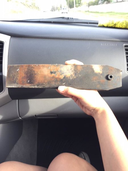

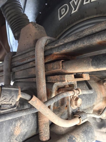

    So I was driving down the road going pretty slow and went over a speed bump and hear loud "clunk clank clunk"...10 feet further down headr another "clunk clank clunk" with something loud hitting the ground. I pulled over and realized it was a piece of the leaf spring that broke off.
    I brought it in and toyota kept my truck. They said it's technically NOT a TSB but a recall on the part or something along those lines. They said the last truck that was brought in took about 1 month to get the leaf pack for replacement. The fastest they had was 1 week...So now I will be driving a rental toyota corolla with all expenses paid by the dealership. I told the service guy that I had a 'add a leaf' and I better not recieve a truck that is lowered back to stock. He said they will only replace the stock leaf pack with a new one and keep everything in place. I read some people say that the dealership will void the replacement if they have aftermarket parts so I would call back and say BS on that because mine is getting fixed. I have the Toytec ultimate lift kit on my truck and they still took it in.

    sooo you know it was the AAL that broke and not the factory leaf pack, yeah? :rolleyes:

    I never said it was an AAL that broke. If you look at the photos the AAL is at the bottoms and it clearly shows the leaf that broke was on top...

    The AAL broke. In your pic, 3rd leaf down. Bottom leaf is the factory overload leaf. So unless you're saying one of the main leaves above, out of the frame of the picture, is broken then the AAL was the defective spring

    So, His vehicle had only two leafs from the factory ???? Don't think so. :eek:

    Yes..... he could. Two leafs plus the overload. That's what my truck had from the factory (2007). I currently have the 3 leaf plus overload TSB.
    And yes...the AAL would've been installed on the bottom above the overload leaf. The AAL broke.

    I agree with all the posts above, looking at the picture it sure as hell looks like the aal broke. Mine has the same as the posts above, 2 main springs plus the overload.

    Two plus overload is what my 2007 still has; missed TSB by a month when I bought mine in 2010. I run airbags to compensate.

    OK. I relent I was counting the overload as a spring ....
