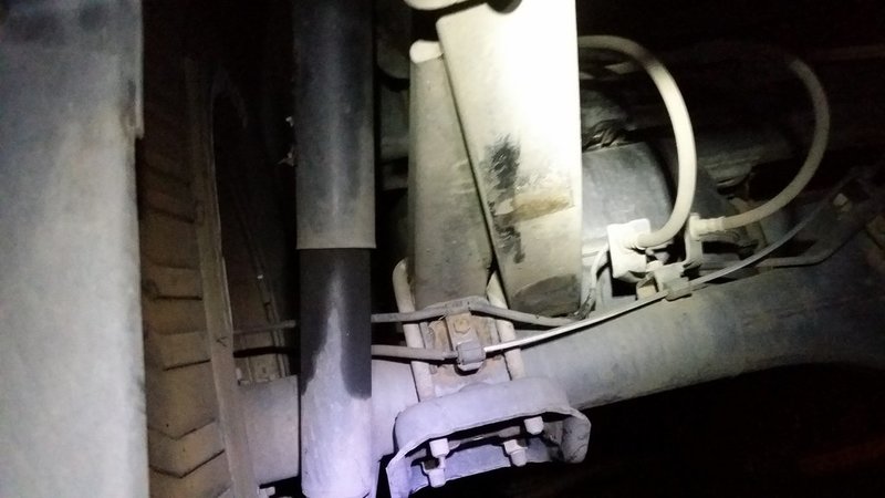

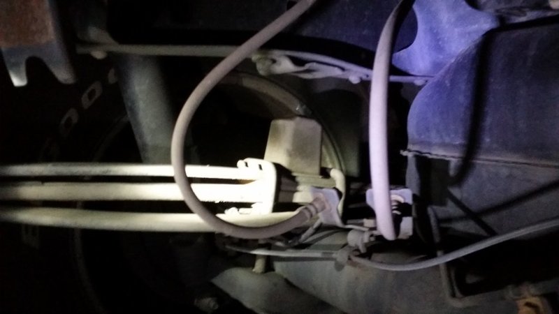

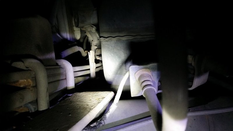

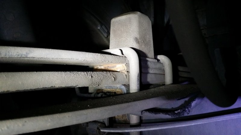

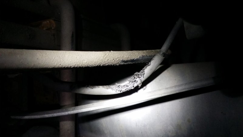

    Broken leaf spring
    So I ran over a piece of metal that put a really good puncture in my all terrains and turns out that it was part of my leaf spring or the assembly for the spring. I had Toyota diagnose the beast for a bad wobble I had felt at the low end - exactly as some of yall in this forum have described and they ultimately charged me for new axles, main bearings and a bunch of other parts and labor that got the repair up into the multiple thousands.
    The wobble persisted and I ended up having a collision earlier this year when the truck veered to the left while I was accelerating moderately under normal driving conditions (no rain, oil or gravel, etc.)
    I just dropped the Taco off at the Toyota dealer tonight for the service department to look at first thing tomorrow...since there is no fix for the leaf springs yet and mine is clearly not drive-able; I am really curious what happens next. There is all kinds of other damage (brake rotor, rear bumper, drivers-side quarter panels, etc. due to the accident that I would assert was at least partially caused by the broken leaf spring (if not completely caused by).
    Having a huge mis-diagnosis and ultimately a huge failure due to the service departments' not being able to find the problem seems like it would put Toyota on the hook for the repairs and possibly a reimbursement for the axles, bearings and other "repairs" that were made last year...
    Am I off-base here? Should I have my lawyer engage Toyota on this one?

    I love how the first pic has a big section of whats left of the lower spring digging into the fuel or brake line and just poised to stab itself right into the gas tank the next time I had to brake really hard...this is crazy.

    Another note; 1 week before Toyota swapped out the axles, etc. I had another service shop change the brakes, shocks, struts and align the Taco just to make sure the wobble wasn't caused by any of those components...that service was almost $1000 by itself, and I have a feeling that all of that will need to be replaced/redone. I wonder what the chances of Toyota stepping up on any of that will be...seems insane that they wouldn't have caught the broken leaf spring in Feb 2014 and would let me drive away with a truck that would ultimately be in this condition...very disconcerting indeed!
