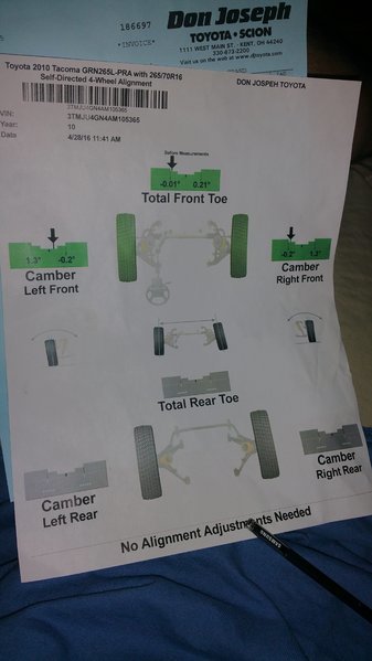

    Anybody else have bad alignment after the new leafs?
  4. Apr 27, 2016 at 6:37 PM
    #1204
    Arailt
    Arailt Well-Known Member
    Jun 21, 2013
    #106777
    1,260
    Dallas, TX
    2019 GX460
    Mine felt off after, but I'm not sure how replacing the rear leafs would affect the alignment.
  5. Apr 27, 2016 at 7:12 PM
    #1205
    volks71folk
    volks71folk Well-Known Member
    Oct 14, 2014
    #140351
    104
    I am not sure either. I just had mine done and it is now off. Finally have time tomorrow to take it back in.
    I did call to tell them about it. They said bring it in and they will check it. He also said an alignment is not included by Toyota. I just got new tires and an alignment. It should be up to them to fix this.
    Arailt likes this.
  6. Apr 28, 2016 at 3:06 AM
    #1206
    T@co_Pr3runn3r
    T@co_Pr3runn3r XXXXXXXXXXXXXXXXXXX
    Jan 20, 2009
    #12767
    14,635
    08 RC Prerunner SR5
    Toe bro, rr toe is affected by replacing leafs. With the center pins it can only be off a little but that's all it takes. I saw how much mine is off when I got new tires and they did alignment. Axle needs a tweak to get it right. positive on one side, negative on the other. I also have changed steering wheel to 2013 and needs to be straightened and will be putting on my LR UCAs and all of this will be addressed by next alignment.

    Can you tell the rear toe is out by the machine the dealer uses for alignments? I am assuming yes?
  10. Apr 28, 2016 at 6:10 AM
    #1210
    T@co_Pr3runn3r
    Jan 20, 2009
    #12767
    14,635
    08 RC Prerunner SR5
    Yeah, all the alignments I have gotten printout from show rr toe......and camber too IIRC.
    Oh, you said dealership......Imuna go with SHOULD. Dunno why their machine would be any different in that respect. Ask them if it does and ask for the printout from alignment so you can see before/after settings.

    Ok, my ride pulls to the right after having this done.
    Thx
  12. Apr 28, 2016 at 6:24 AM
    #1212
    T@co_Pr3runn3r
    Jan 20, 2009
    #12767
    14,635
    08 RC Prerunner SR5
    mine kinda migrates to the left barely after last alignment and after seeing the positive toe on passenger side and too much negative on driver side, that tells me my rr axle is askew to the right making it want to drift left when moving. I want them to loosen u bolts, pull back on driver side and push forward on passenger side and clamp it back down and see if it'll line up better.

    Just got back from the dealer. Here is my alignment readings. They said Toyota does not include the alignment with new springs and my alignment is now mest up from getting new springs.
    The dealer said call Toyota and complain. If they get enough complaints they might start including it.
    Alignment was perfect when I pulled up and shit when I pull out and nobody wants to fix it. Uggh...
