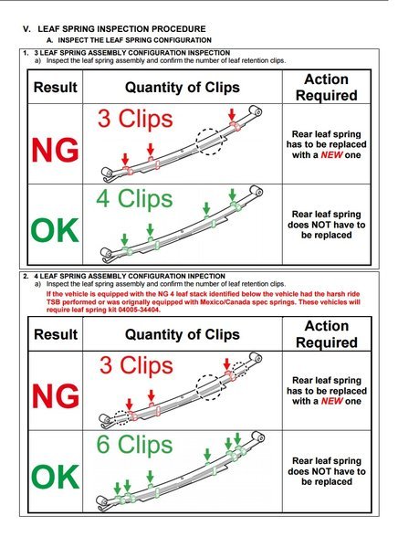

    This is why...

    08 RC Prerunner SR5
    That sucks if you happen to have the 3 leaf pack above with 4 clips - No good but they won't replace according to the post above. Mine off a 2015 are the 4 leaf 6 clip type so I'm good but will try to be reimbursed for what I paid using my paypal transaction receipt with purchase item listed in the note field. Also will provide the matching bank transaction as well.

    For what it's worth, the inspection seemed more of a formality. The Toyota Service man said they have only done a few of them and they have not had to turn anyone down. I did ask what the disqualifying factor was, and of course the leaf springs have to be original.
