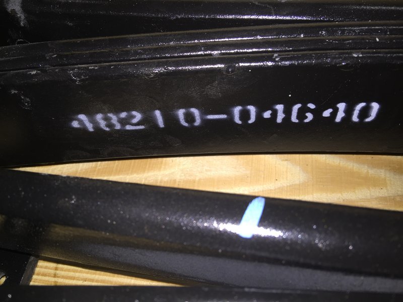

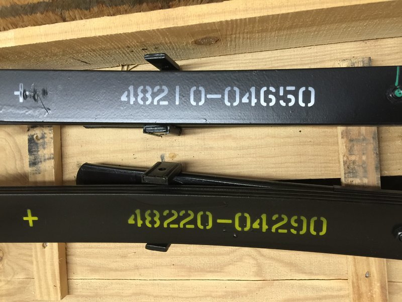

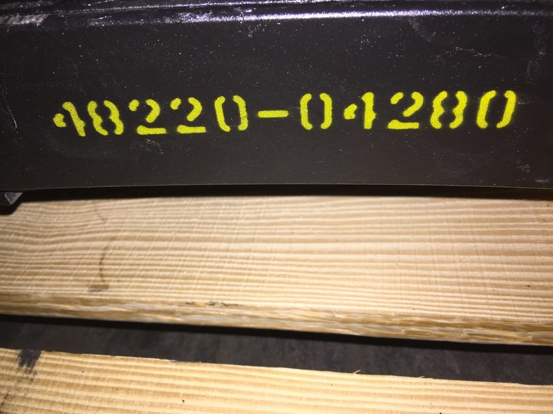

    image.jpg We've done prob close to 100 so far and not one has left lower that when it came in. Reg can does have a diff part #. Check your springs and see what #s on them. These are the #s u SHOULD have(double and access)

    Are those the same part numbers that should be used on the regular cab 4x4 too?

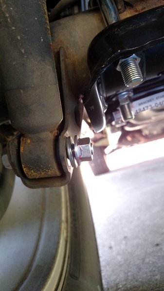

    New member here, I just got my recall done today. I cannot stress enough to check your setup after you get it back. I heard something rattling on the way home and found this.

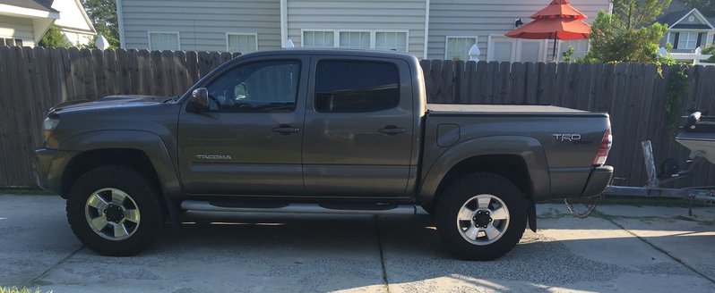

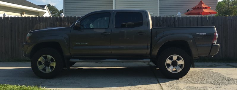

    I'm actually hoping I lose a 1/2"-1". It will allow me to add the Archive Garage Shackle Filp without having to mess with the front. I currently have the new leafs with a 3 leaf AAL.
