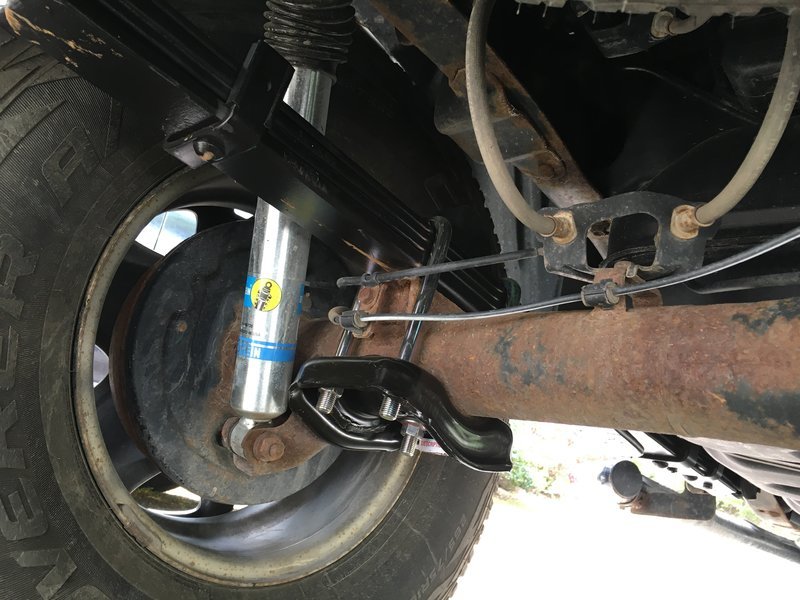

    Here is what they did to mine. I just called the dealership, gave them my vin# and they said yep yours is recalled. They called and let me know when the leafs were in and then I made an appointment. Took about 1 1/2 hours. I read on here before hit the bolts with some pb blaster before you take it in and the techs will love ya. They put on everything but the bilsteins. I also got the extra leafs but they are kind of flat. I haven't added my aal yet. I'm at 1.75 in the front and have a little Cali rake going...

    That looks "normal" for dealership work. What's the problem?

    where is your bumpstop?

    Hiding in plain sight. Done at a "stealership", must be a hack job. :smash:

    At 56, my plain sight is waning I guess.....I see the silhouette of it now squinting and such. Blended into the tire upon initial glance. Yeah, mine won't be going in. Bought some dude's 2015 6 clip 4 leaf low mileage packs and just did them myself before all the recall stuff got going. I'll be going the reimbursement route.............
