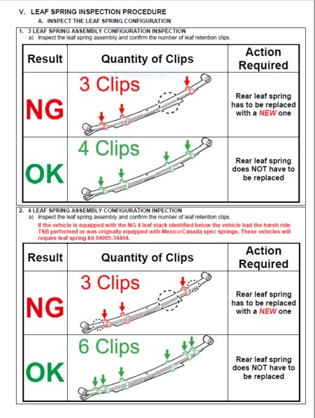

    That's not necessarily true. However, you can check if you need the new ones yourself.
    Here is a screenshot from the technical instructions sent to Toyota techs.
    Image #2 is what you're concerned with. If you have six clips, you're good. If not, go back there and tell them to RTFM. Here, I'll even attach it for you to bring to them. :D
