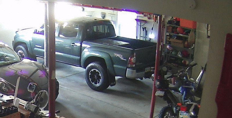

    So, I have a security camera in my garage, and it occurred to me I might be able to see the difference by looking at a pic from before the springs were replaced, and one after. Amazingly, I parked in the EXACT same spot when I returned from the dealership yesterday.
    So, below, the first image in the animation was shot at 8am shortly before I left for the dealership, the second was shot around 1pm, shortly after I'd returned. No other changes occurred, only the spring swap. There is no weight difference in the vehicle, etc.
    Original springs were the TSB 4-leaf put on ~2010, new springs are the recall springs. It looks to be sitting close to 2" lower to me. It's a big difference visually.
    DEEVON911 and DaveInDenver like this.

    I dunno if it's 2" lower, but it's clearly lower. There was another thread about this. If you had 4-leaf TSB springs before the correct part number for the new springs is supposed to be 04005-34404. If you can check your work order, see if it says they used SPRING KIT, RR LEAF 04005-34304.
    The 04005-34304 is what I got but I didn't have TSB springs to start with. My truck raised just a bit and is a much better, slightly more firm, ride. They are 4 leaf (3 main + 1 overload) where as my originals were 3 leaf (2 + 1).
    So the new springs aren't as bad as the originals, although they may not be sufficient spring rate. OTOH the ride might be better with an empty bed. I have a topper and a bunch of junk in the back so my original springs were crap and these are probably barely enough.

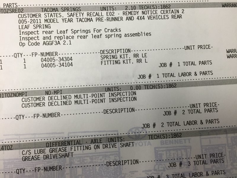

    Sigh. . . sure enough, they put the wrong ones on:
    sooooo frustrating.

    http://www-odi.nhtsa.dot.gov/acms/cs/jaxrs/download/doc/UCM496226/RCMN-14V604-9451.pdf
    I don't know if they are wrong per say, but the Recall notice states "The following leaf spring kit should only be installed on vehicles who previously had T-SB-0359-10, Rear Spring Harsh Ride, performed on the vehicle. This kit will only be needed in rare cases, the inspection procedure in the TI will identify if this kit is needed."
    They did solve the "harsh" ride on my truck, though, which seems to be because the truck was riding on the bump stops all the time. But their spring rate must be lower than the TSB springs since you lost lift. I gained a little, though, even with the weight.
    So apparently Canada and Mexico spec trucks got real leafs?

    I'm not sure they are wrong or not. The notice specs out a different part number for the dealer to order but has anyone confirmed that they are actually different part numbers on the springs themselves? I got 48220-04290 screened on my springs with part number 04005-34304 on the work order. It's not impossible that everyone is just getting uprated springs now so the 04005-34404 springs could just be a different part number for the same springs.

    All of you folks who have the TSB 3+1 springs beware; most dealers are too lazy to inspect your truck properly. Here is my story from another post:
    Anyone else having problems with their local Toyota dealer getting the right springs put on? My 05 DC had the Harsh Ride TSB springs done years ago, and I am pleased with them (I tow a camper). Got my recall letter in June, took it to dealer for "inspection". They said I qualify for the recall and would call me when parts came in. Waited 3 weeks and called them. They said not in yet. I wanted to verify the part # for the springs on order; 04005-34404. They said that's the wrong number, should be 04005-34304. Said that's the ones for all AC/DC models. Tried arguing over the phone, gave up and drove over to them with a copy of the TI in hand. At first they tried to tell me the 34404 ones only applied to Canadian/Mexican region trucks. I argued some more. Finally a management type agreed with me, said they have never done the 34404 springs for any truck so far, and would have to open a case file and get Toyota to approve. They inspected the truck again. I thought all was good to go now. A day later they called back, said I need to bring truck back a 3rd time so they could take pictures and collect "data" before Toyota will approve. We'll see what happens after the pictures.
    Update: Took the truck in a 3rd time, they took pictures and told me they would submit to Toyota.
    Anyone who had the wrong spring set installed and are unhappy with the drop in ride height, go back and demand they do it right! Not saying the new 34404 set will be better, since I have not had mine done yet, but at least they should do what Mr. Toyota promised.

    The dealer installed the wrong ones on mine too. They called and said the number should start with a 9. Anyone else get the correct ones the second time around? If so, what number did you get so I know what to look for? I'm taking it back Monday for the "correct" springs and rear differential leak.
