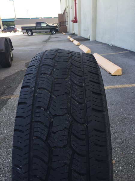

    My 06 taco w/ 180k miles was dragging some serious ass lately. Actually ruined 2 tires and blew out both rear shocks bottoming out so hard towing a trailer.
    Called the dealership and they swapped out both leafs under recall owed them nothing.
    Rides much better now.
    The new leads have 3 leafs old ones had 2 and more clamps to hold the pack together.
    I suggest anyone with a taco under recall get new springs adapt especially if you tow
    Or you will need new shocks and possibly rear tires

    That tire isn't WORN crooked, that tire is torn apart. Broken suspension parts don't do that, overloading does that. Also, excess weight doesn't blow out shocks unless you have too long of shocks installed. Shock should NEVER be able to bottom out.

    Agree with the bottom out - but how about top out??
    Yeah that tire has had it - what's the Model of the tire, Smallpackageman 6 ?? Just "HOW Much" overloaded was it to do this??? Were you hauling a house??

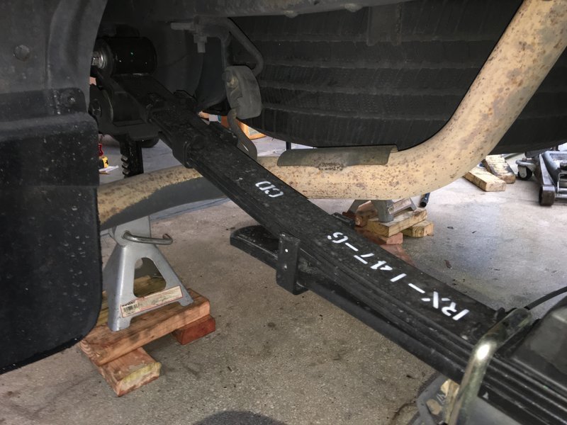

    Can someone post a pic of the updated spring setup?

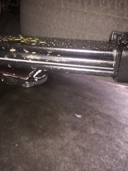

    3 clips in front of axle, 3 clips behind axle, 3 leafs, 1 overload........
    front half............
    rear half..................
    sorry, quickest ones I could find........

    I typically tow heavy loads long distances with the taco been doing so for 3 years with no problem
    This time I had around 7000 pounds of wrecked Dodge Charger & 2 axle car trailer ( I part out cars on eBay)
    This particular time the leaf let go and was bottoming out extra hard on a 300 mile trek
    Both rear tires had the steel belts let loose
    The shocks are original and were on the way out for a while so bottoming out probably finished them off

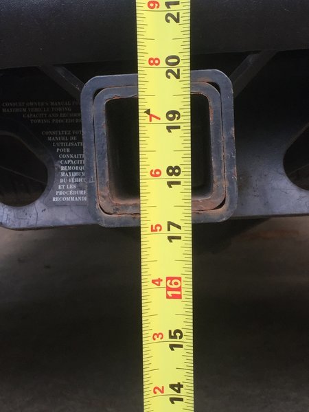

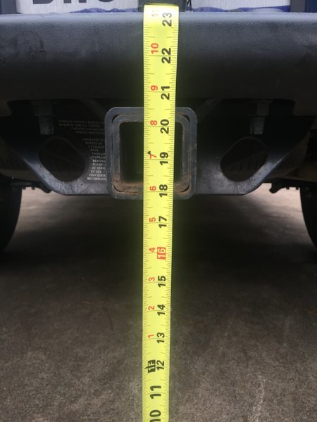

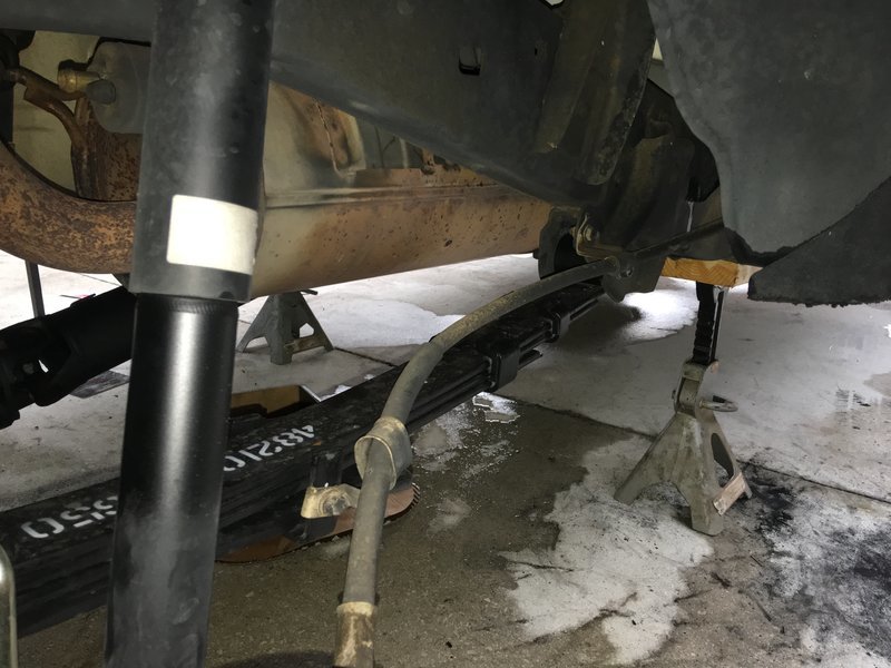

    I finally got mine done this past Monday. The dealer, normally responsive, drug their a$$ on this one. Had it inspected back on 7/14 and was told it qualified-parts in 2-3 weeks. Crickets. Called service advisor-left message. Crickets. Called again-same reply. Called third time for service Mgr and passed to another service advisor. He said parts had been in for about a month so I made a appt for Monday. On Monday am, there was no appointment when I went in to drop it off But they took it. Picked it up that evening and all was good.
    The truck sits about 3/4" higher than the old springs. See pics, 19-3/8" before, 20-1/8" after. The yellow part # is the left side and the white is the right.
    I've driven about 85 miles and the ride is about the same to a little firmer than the old springs but it seems to have a quicker response to bumps and dips. No alignment but I didn't expect one and it doesn't seem necessary. Typically factory leafs fit one way to a bead on the axle and a divot on the springs. I haven't pulled my trailer yet but I expect a better ride. I typically use a weight distribution hitch w/o issue so the 3+1 set up should make for a more confident ride.
    All said, so far it's an improvement over the OE stock 2+1. I say get yours today.

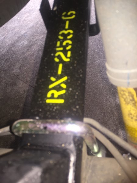

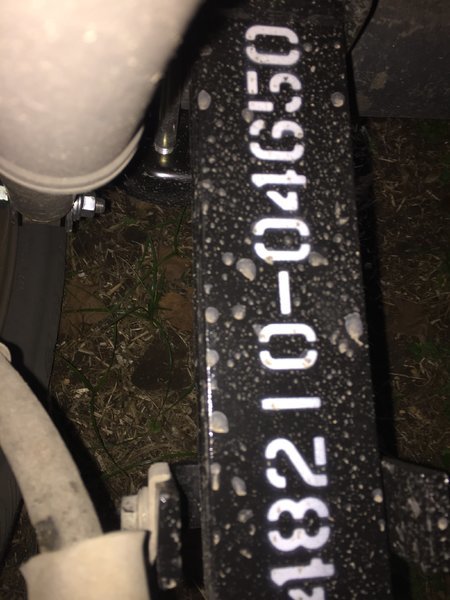

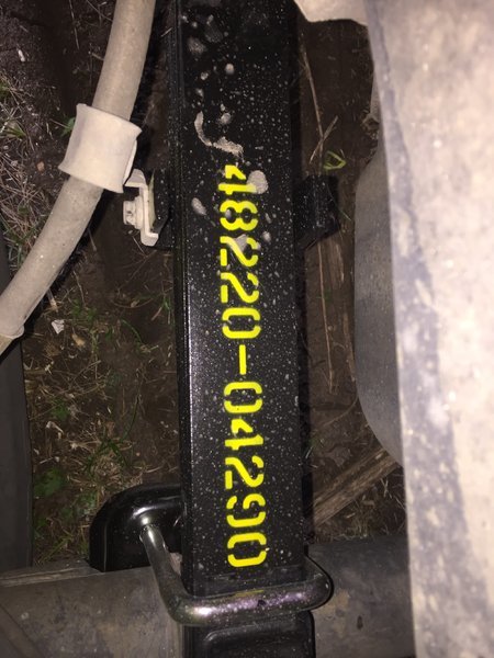

    I had the 4 leaf (TSB) pack installed some years back and liked the firm ride it provided.
    Before having the new springs installed, I told the service rep. to be sure to get me the replacement springs for the 4 leaf pack.
    Research showed me the KIT # for that replacement is 04005-34404 and each spring is 48220-04300 for the left spring and 48210-04660 for the right spring. I checked them and all was correct, but the ride height is lower and the rear end seems a little softer than before.
    I think I would never have gotten the recall done had I known that. It would be interesting to know just how many gas tanks were actually punctured.
