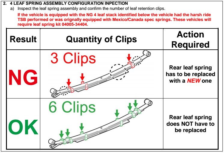

    Honestly if you have the TSB done from 3 leaf to 4 leaf and it's good condition, I would just keep your TSB one.

    Hmmm. Toyota told me last year that all three leafs were to be replaced regardless of clips. I dunno. Mine were replaced with 4 leafs and six clips. Happy so far.

    Sorry for bumping an old thread but I'm still debating whether or not to proceed with this recall.
    I had the harsh ride TSB done like 10 years ago and got the 4 leaf pack out of it. It's still performing great with the Icon 3 AAL that I installed like 8 years ago.
    Based on the stories here of people with the TSB 4 leaf pack getting recall done and incorrectly getting the 3 leaf pack for the recall and with my Icon AAL which complicates things, should I still go for the recall?

    Climber15 New Member
