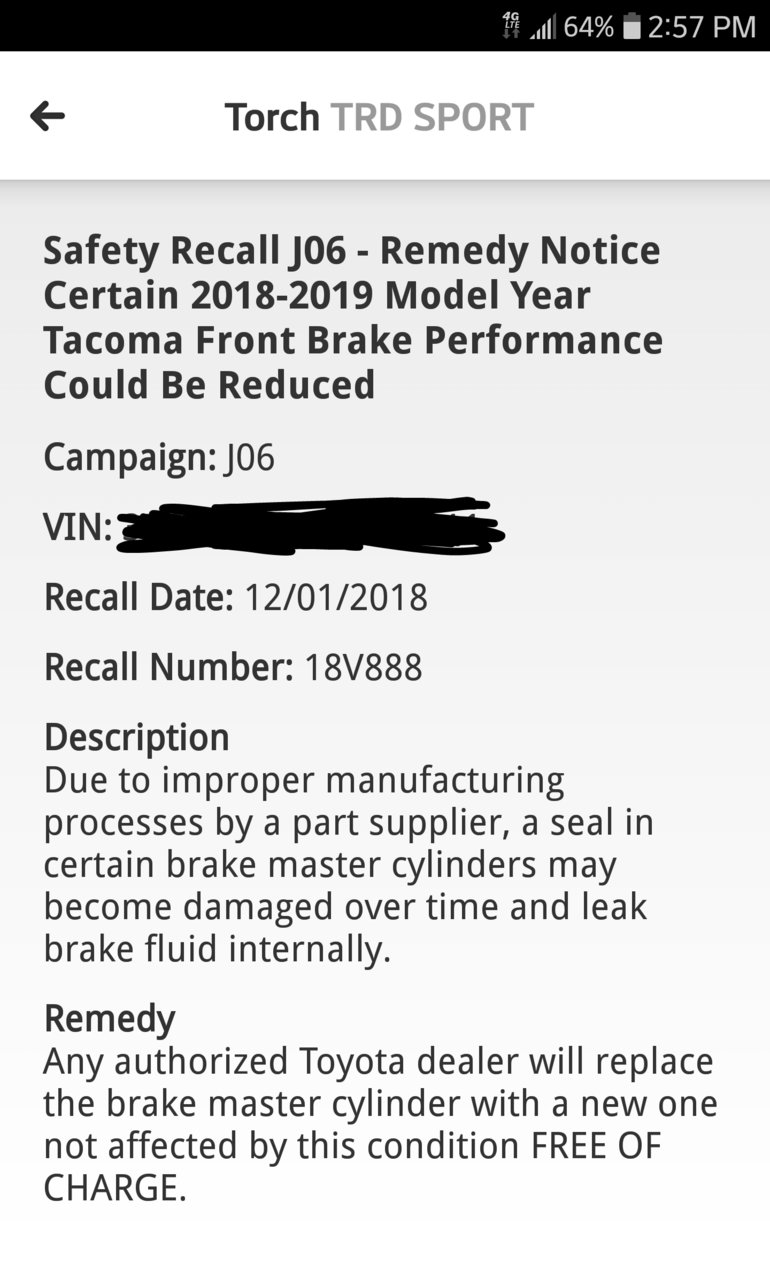

    I searched and couldn’t locate this recall being posted. If it has been posted already I apologize for the duplication.

    This is exactly my symptoms with my truck. Although I personally was not able to see the brake fluid leaking, this reads that DUE TO IMPROPER MANUFACTURING PROCESSES BY A PART SUPPLIER, A SEAL IN CERTAIN BRAKE MASTER CYLINDERS MAY BECOME DAMAGED OVER TIME AND LEAK BRAKE FLUID INTERNALLY. “THE BRAKE PEDAL COULD CHANGE, AND FRONT BRAKE PERFORMANCE COULD BE SUDDENLY REDUCED”. THIS COULD RESULT IN INCREASED VEHICLE STOPING DISTANCE AND MAY INCREASE THE RISK OF A CRASH!
    This recall is for 18-19, but I definitely think Toyota needs to extend this out to 17s because this is exactly MY TRUCK! I first said something to my Cousin about my Brake Pedal feeling differently on December 29th. I chose not to drive my truck that much afterwards because it felt really weird and he was too busy at the moment to take a quick look for me. Therefore, I was patiently waiting until he had some time in his shop for me to bring it in and to let the holidays kind of settle down. Like I said, I only drove my truck a few times after that, one being this last Tuesday, January 8th, to work. On my way home my brakes went out and it scared the shit out of me. There was nothing left in my brake pedal at all and it went straight to the floor. I called my cousin and he came and towed it home for me until I could get in touch with Toyota. My cousin looked it over briefly and mentioned that it has to do with the Master Cylinder. I just dropped my truck off at Wilsonville Toyota so we will see!
