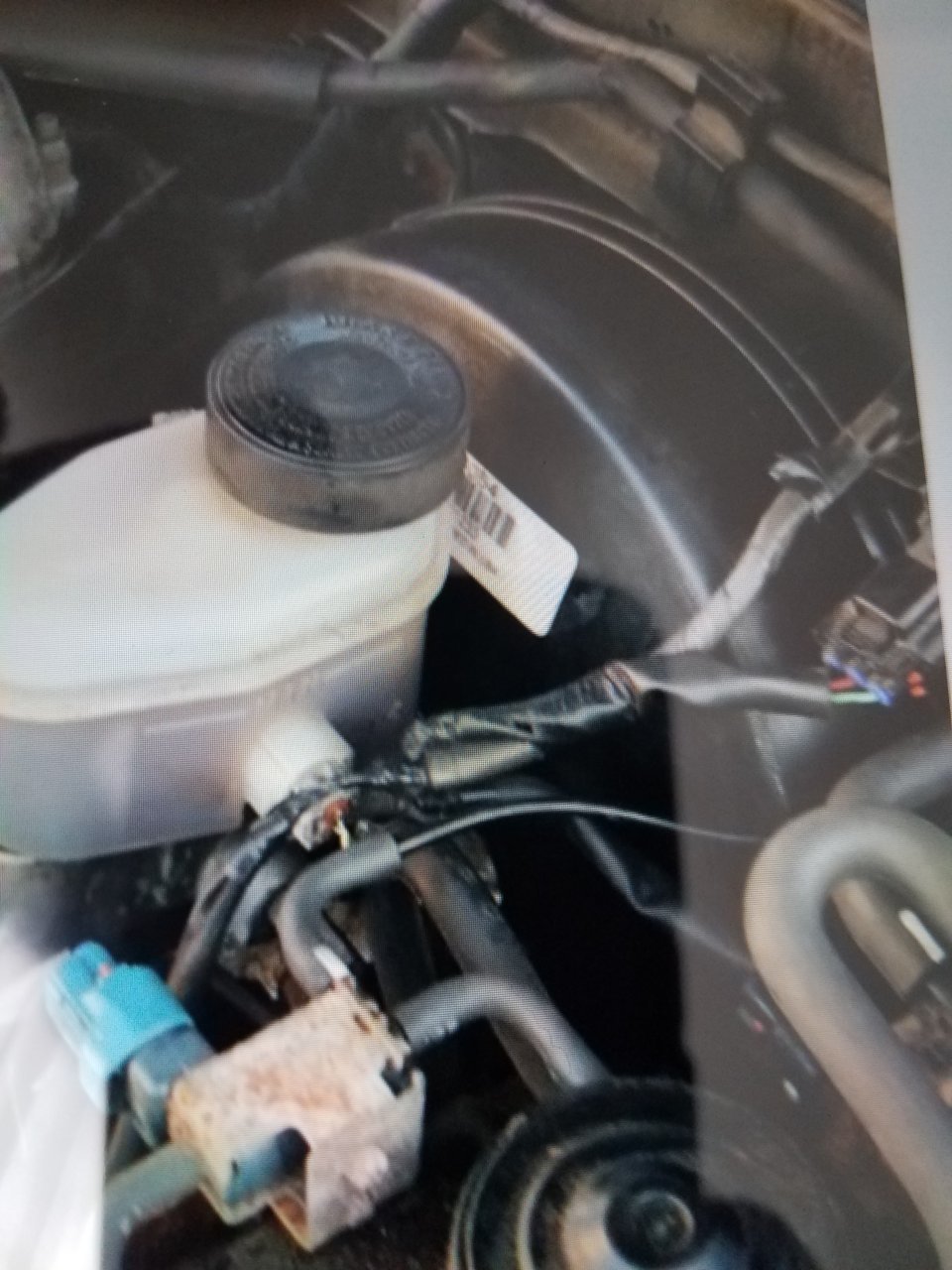

    I didn't think any Off Road or Pro's were on the recall list because we have a different style booster/mc combo for A-TRAC & Crawl Control. Seeing that your truck is 2 wheel drive I assume your truck has a Traditional Style Vacuum Booster and MC instead?
    TT005[QUOTED] likes this.

    Here is a 1st Gen Tacoma, the black circular disc that the MC is attached to is a traditional style vacuum booster.
