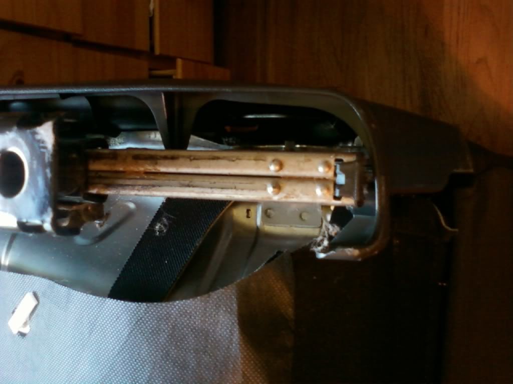

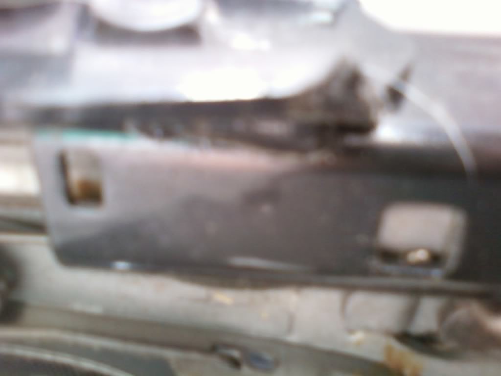

    Following Taco Dells write up
    Here:
    http://www.tacomaterritory.com/forum/showthread.php?t=141220

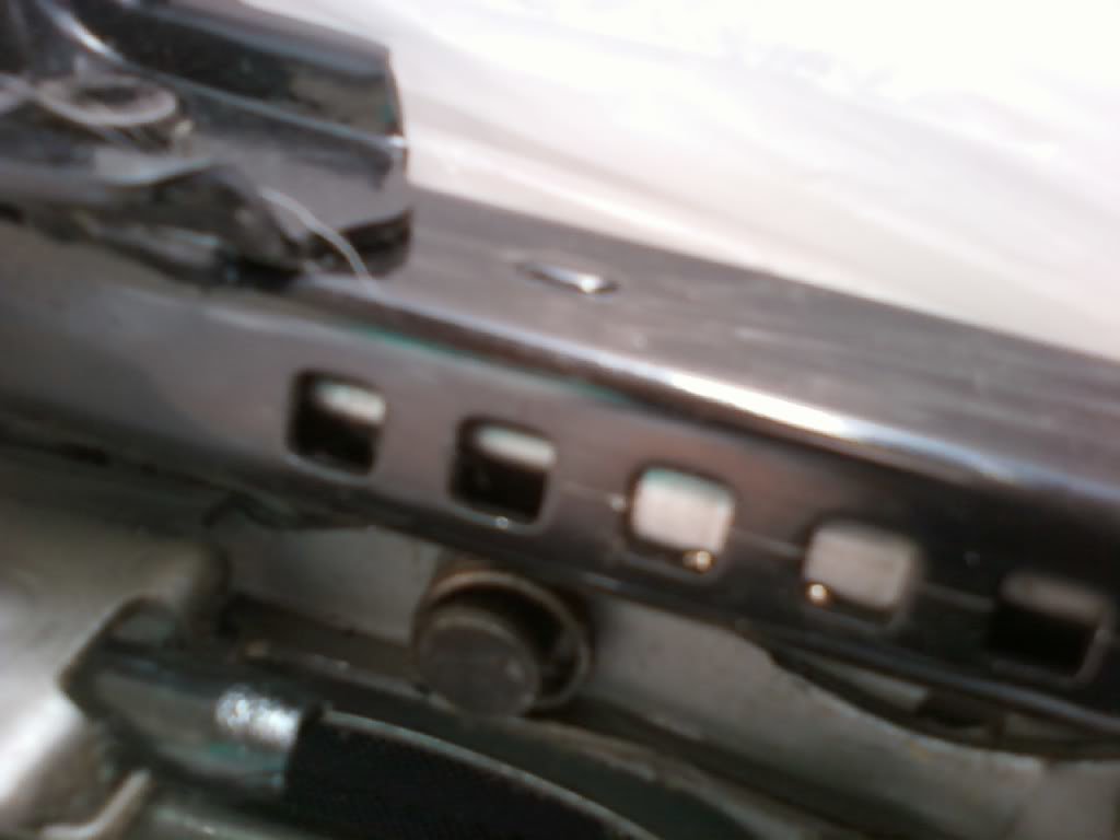

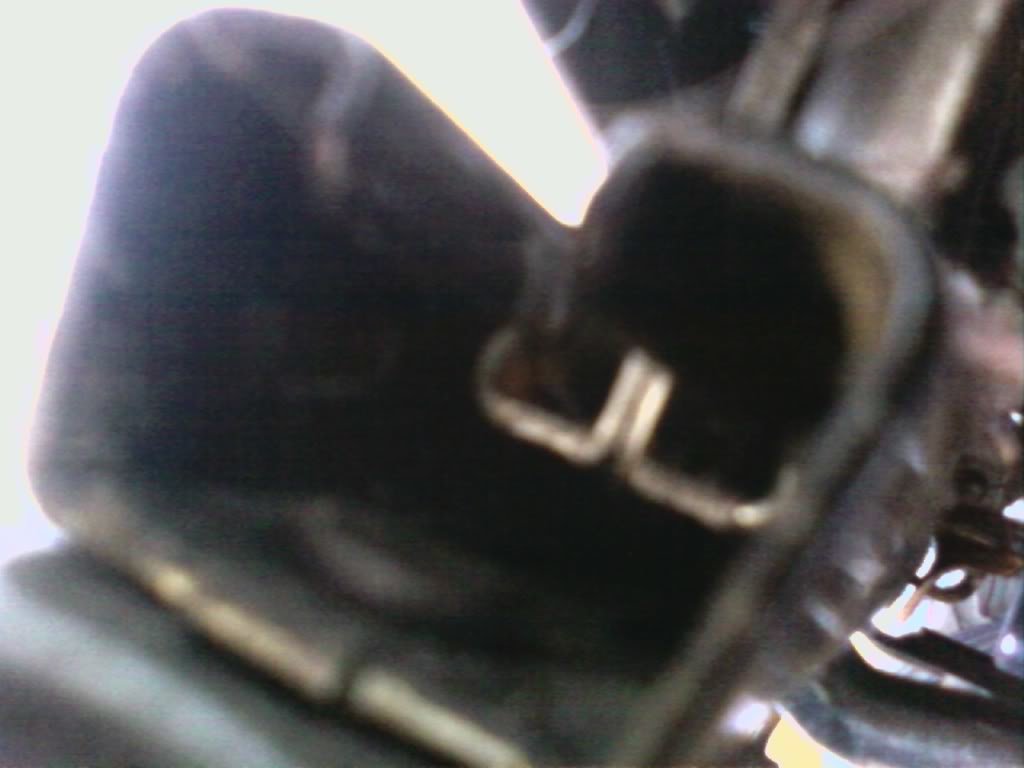

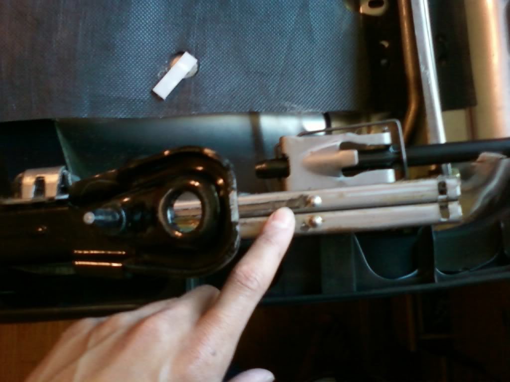

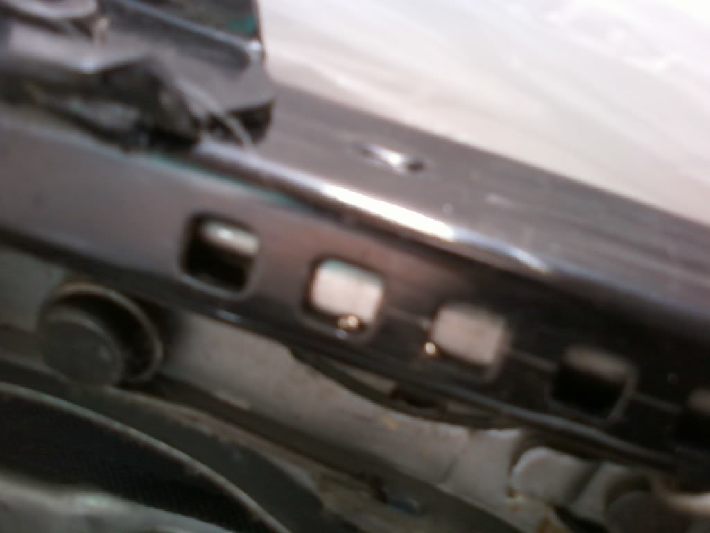

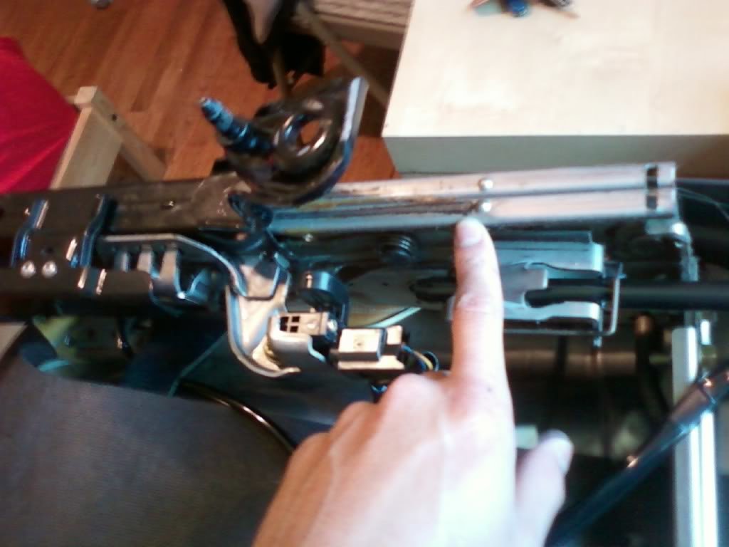

    First Grind off the "Bumps" on the tracks.
    2 on the front of one track.
    The other 2 on the front of the other track.
    4 on the back of both tracks.
    Grind off the Rivet head on the front of both tracks. Seen at the bottom of the picture. Black little nub.
    This is the part I wanted to make sure about. The "bearing cage" Putting the screw driver into the [][][][] and pushing the "bearing cage" out towards the front of the rails.
    In the pictures i think its the Little silver thing with 2 bearings (gold/bronze)
    <<<--- You can see me moving it to the left
    I believe there are 2 bearing cages on each rail/track. Once they are out then you can remove the bottom rail and swap them with Tacoma ones.
    Then phone died.. Had a camcorder...
