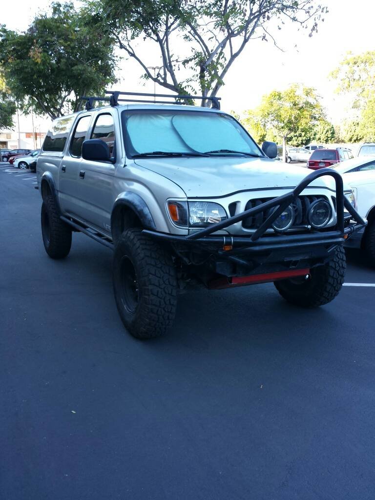

    Picked up a Yakima QTower system for cheap and gave the truck a wash. Chilling at CSULB waiting for class.
