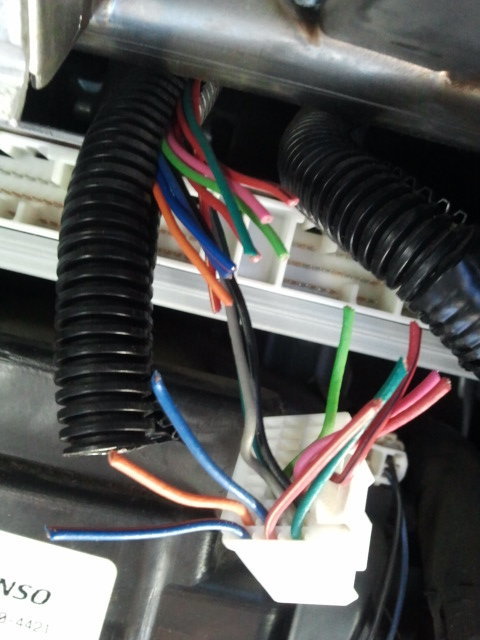

    Great job! love the truck and your work.
    Do you have any more info on the modifications to the trans harness?

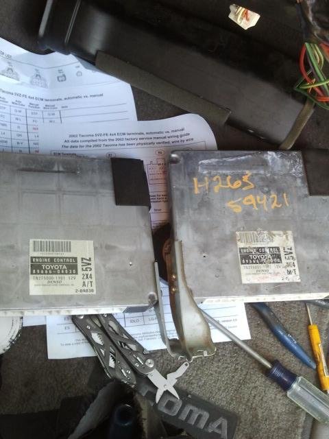

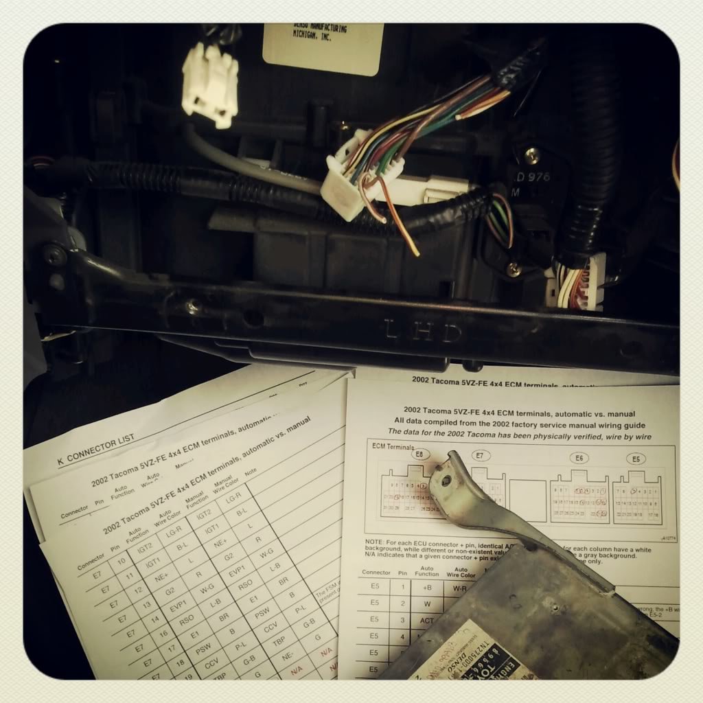

    Manual Transmission doesn't connect to the ECU. You only wire up the reverse light and if you want 4wd light or ADD.

    So the manual Ecu will plug into auto harness? (Same engine and year of course) then it's just a matter of cutting the wires you don't need?

    Yep. Theoretically you can leave them but why risk a short on an expensive ecm.

    @gray223 Some people added a spacer instead. I believe that was Jeff over on TTORA. Jeff also provided ECU diagrams for all models. I recall he is some kind of data analyst.
