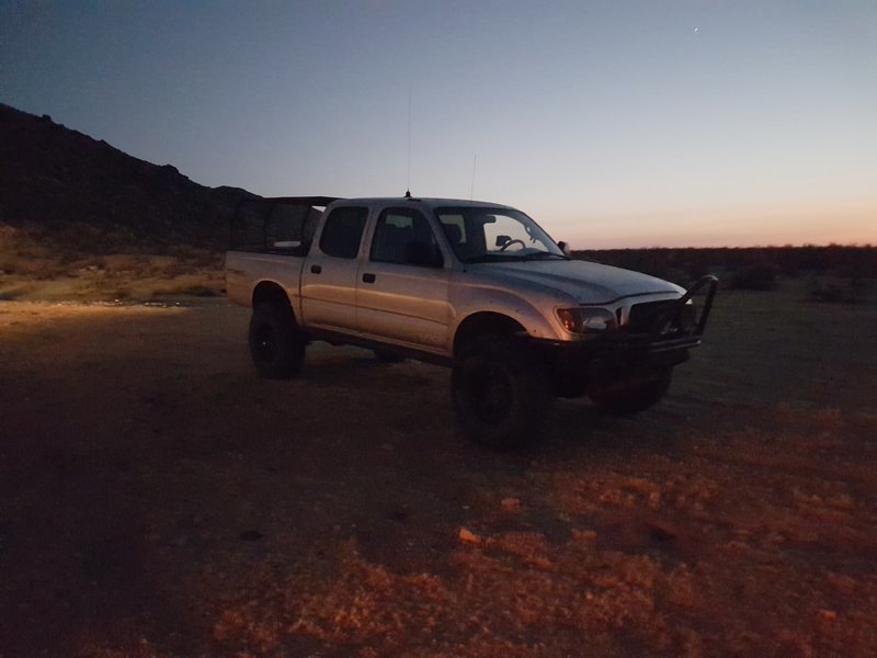

    uploadfromtaptalk1457830705036.jpg Only picture I have on my phone.

    What CB antenna do you have? I cant see one anywhere...

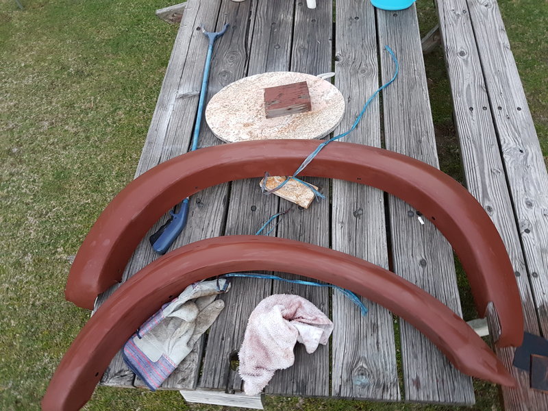

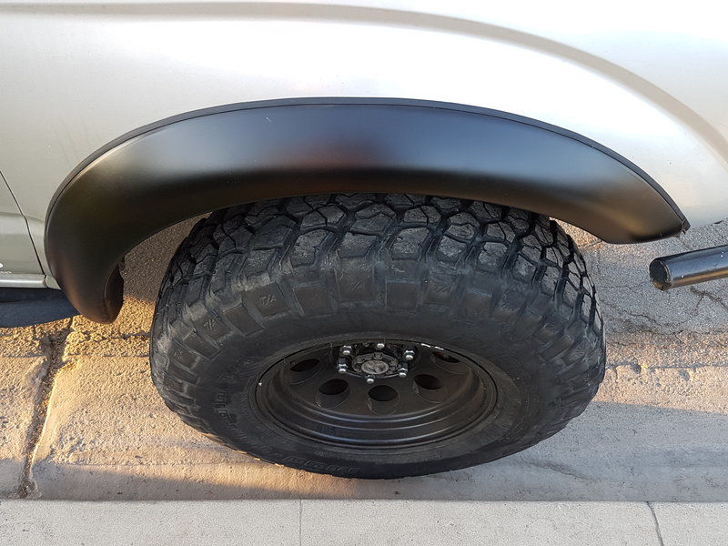

    Wow, it has been a long time since I updated this. Bought an Allpro Expo rack, and moved the tent to the rear. Easy install. Took off my fenders to paint them.
    Here is what I did:
    • 220 grit
    • 400 grit
    • 800 grit wet
    • Rustoleum primer
    • 400 grit wet sand
    • 800 grit wet sand
    • Rustoleum bumper paint
    • 400 grit wet
    • 800 grit wet
    • Another coat of Rustoleum.
    Fenders finished up. Now I need to do the hood.
    FirstGen Jer likes this.

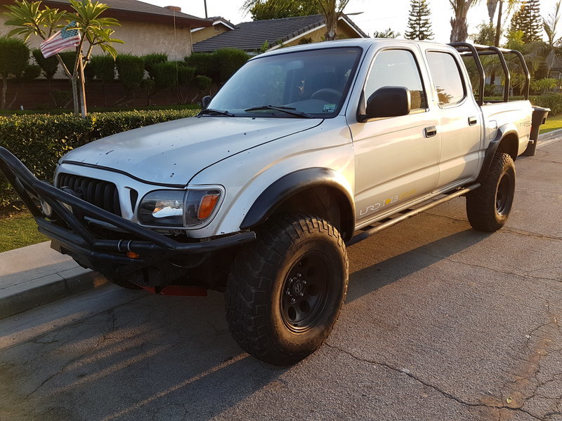

    Came out nice. Hope it lasts....

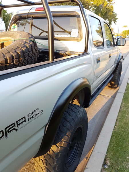

    For some reason I cant put text between pictures in one post while using my phone. Anyway here is a closer picture.
