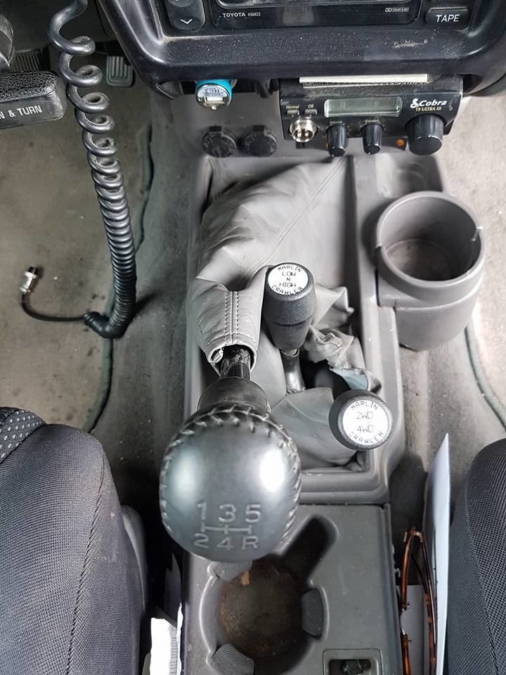

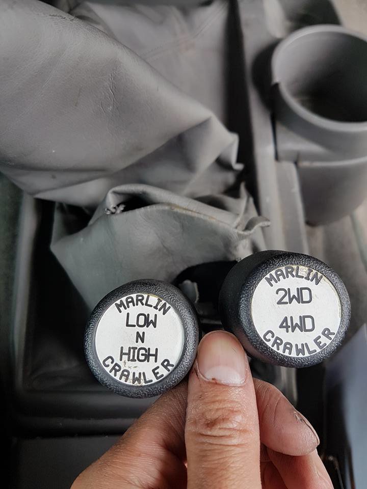

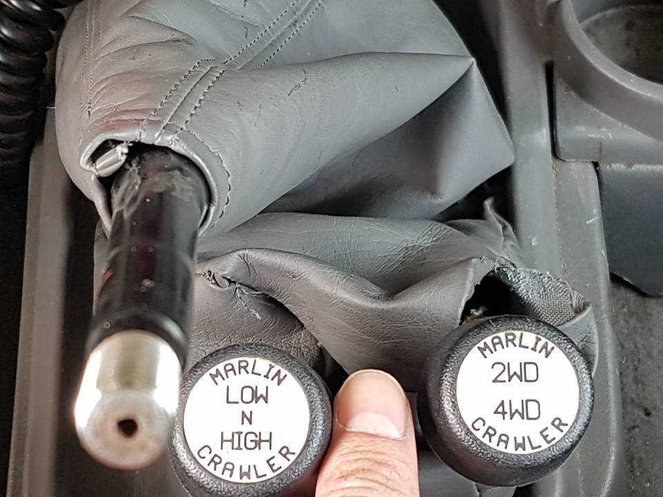

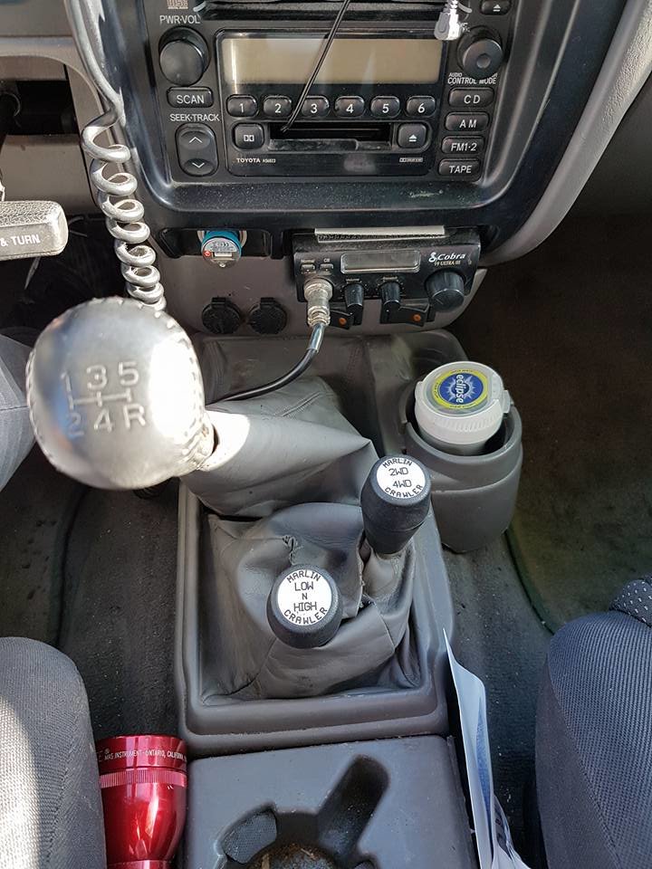

    Update. Had some vibration issues with the twin stick for some reason. Always wanted to fixed how they looked.
    So I cut them and welded them back up. Then I forgot about Reverse hitting when in Low gear.
    18157111_10155369900359470_6378581511057_2e29c65ee48e808a3eef391fa2297e62ec77895a.jpg
    After measuring I realized I had to move it about 1 cm or so to the passenger side.
    18057698_10155372691049470_9040193168231_2a4055f0f0427b352f9ce6b887ffbe1fb217385b.jpg
    After an 30 mins or so of cutting and welding everything is back together.
    18056972_10155372691109470_4144283802722_9be4d77b9547d1518b94f3959ae90a643c9b05cf.jpg
    Reverse and Low gear clear again. Looks much cleaner now.
    18057109_10155372691154470_5157971005969_8a85a60dd4f5068dc7d0de28683c84fd6f413084.jpg
