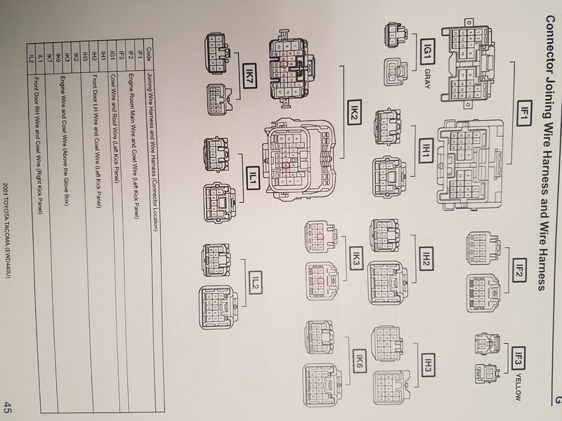

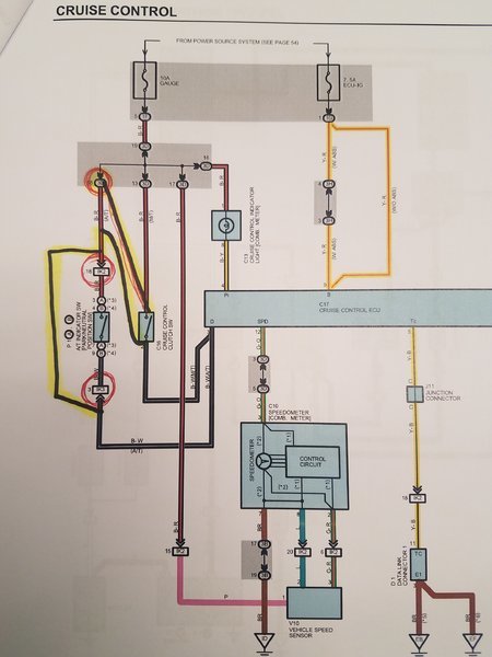

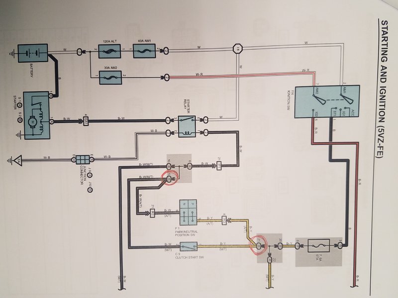

    No sir.. Whole family always makes sure its out of gear. You can basically wire it into the park neutral safety. It just a switch to keep you from starting it.

    Ah shucks.
    Yeah, my first attempt failed. I tried wiring it in parallel with the clutch switch so I could start it with out pressing on the clutch. The switch I used is from the older yotas. I may try to hunt down one from a newer to see if it works better.

    Is this your current set up with out the clutch cancel?

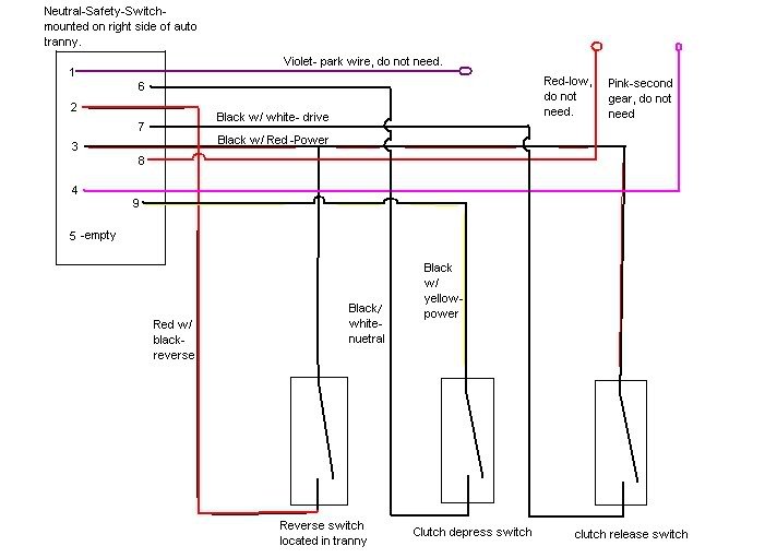

  4. Jun 12, 2017 at 10:13 AM
    #144
    J-rad268
    J-rad268 New Member
    Nov 24, 2015
    #170532
    4
    2001 Double Cab Pre-Runner

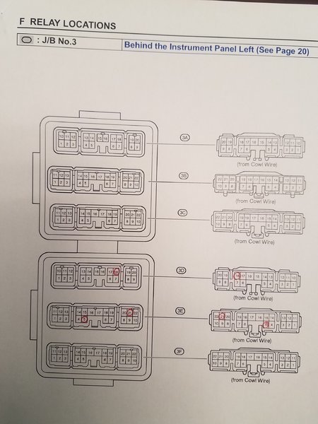

    Done: E-locker axle swap 5 speed manual Swap 4wd Swap To Do: Supercharger Intake Headers/exhaust
    This is how I wired the clutch pedal on my 2001. Have to push the clutch in to start, and and it cancels the cruise. I haven't wired the dash cancel switch yet. 20170612_110134.jpg 20170612_111214.jpg 20170612_110220.jpg 20170612_110253.jpg

    Nice! Thanks for sharing J-rad.

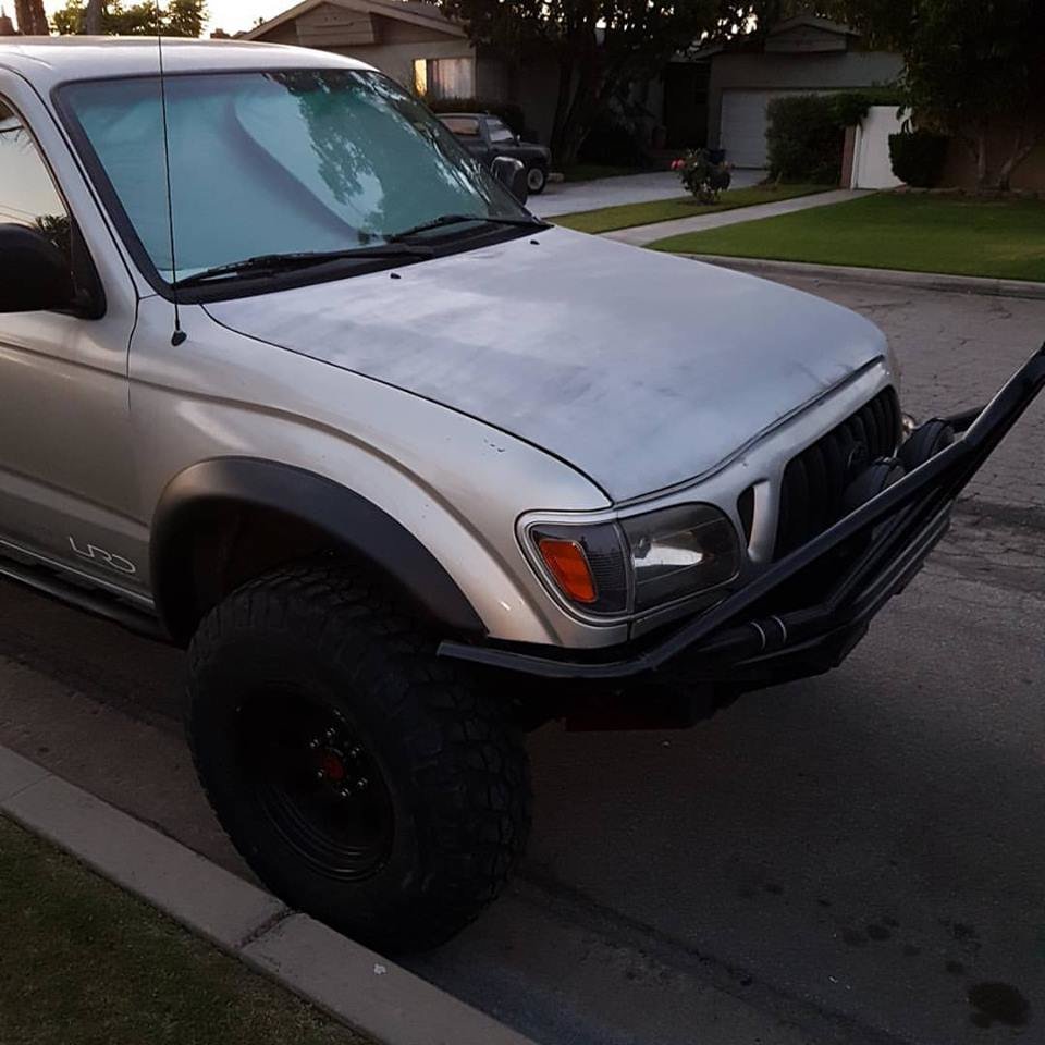

    For those who don't follow me on instagram: Safetydang
    I needed to fix my rusty hood.

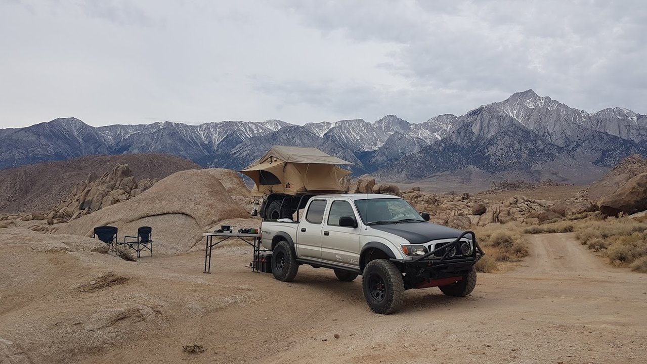

    Alabama Hills, CA BLM Camping
    Birthday girl wanted to go camping. We went to my parent's house and packed up the goodies in 30 mins. Didn't mount the shower since we were only staying one night.
    X7BHis6SPd-TB_5EOQ2ZuxVM49l_IdAi7x-OB4uR_e1feb3aa407fcd9a07a5539e9eec69ea724d1a22.jpg
    5pm and ready to roll out.
