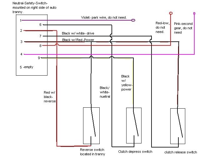

    I got everything except the ECU. Im kind of thinking I can get the engine wiring harness and ECU out of a 2004 and just put it in mine and it should work without unpinning and cutting. Input from anyone would be awesome

    It takes 20 minutes to unpin the connections. Buy the 04 (manual ecu), no harness needed, and just unpin the hand full of wires.

    I just bought the ECU. Do I not need any of the transmission wires?

    FInished putting the trans in and I was hoping that I could start the truck without doing the wiring for a little but that’s a big fat no. I’m guessing I have to wire up the diagram above for it to turn on or do I have to also unpin the wiring from the ecu for it to run. Emissions aren’t due til November

    Just the diagram i sent. Unpinning with a new ecu will help solve the Check engine light.

    @SafetyDang quick question on ecm unpin. Looking the diagrams I downloaded from mosk on yota tech . I found a manual ecm for my year, on E5 plug it shows slot 5 wire as B/W FOR IGSW, my wire is black with red stripe. It also shows the same for slot E5 slot 15 B/W for IGSW. The slot 15 white is correct color per diagram. Did you pull any wires in this E5 plug? It's the only one on that plug that need to be unpinned on an 02. Thanks in advance

    Sorry did you find out? I would have to look at it when I have spare time

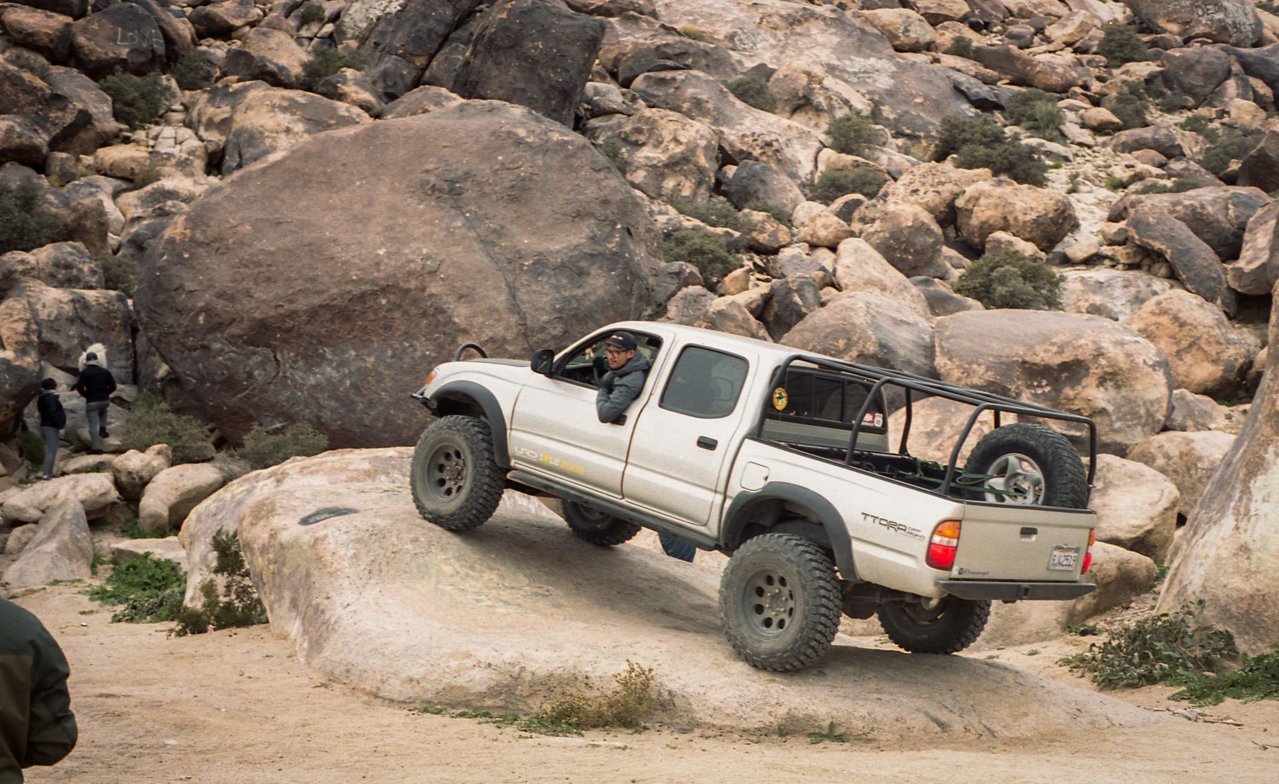

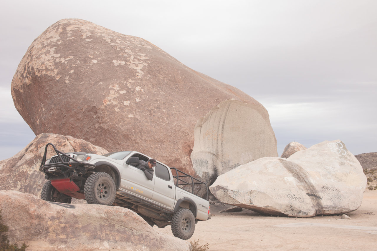

    Went to check out a big rock in Landers, Ca.

    Still a mystery, everyone ive asked says" you did what"? I would appreciate the help when you get around to it. What skids are you running? Thanks brotha

    I cut E5 pin/slot 5. Didn't even look at the color now that you mention it. Truck has been running fine since
