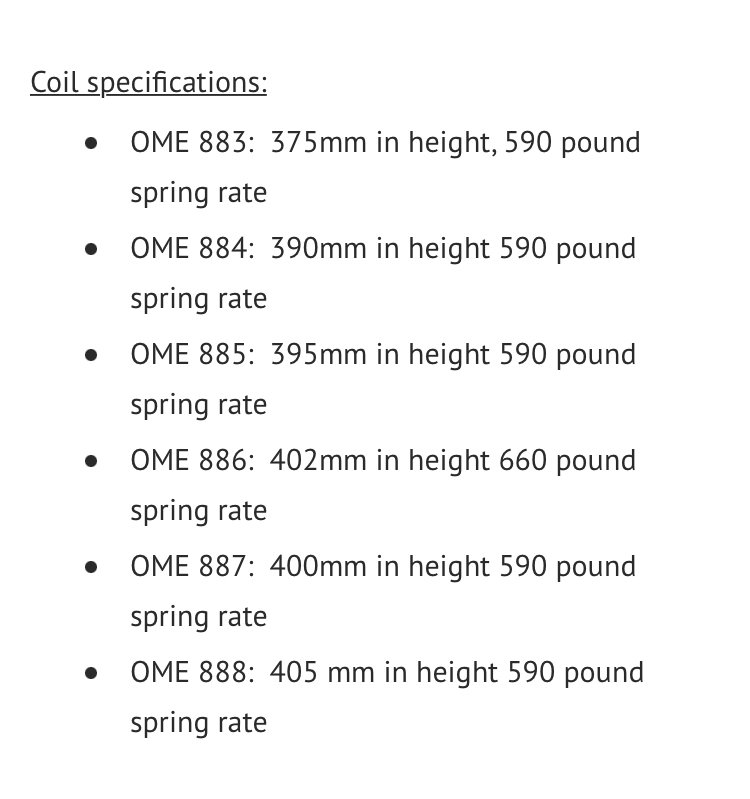

    That’s because they aren’t heavy enough for a 3rd gen. This is so common it’s not even funny...had this convo many times this week already. I had the 2888 and they did the same. Most of these coils are spec’d for a 2nd gen because ARB assumed the 2nd and 3rd gen weigh the same (which they don’t). If you get them mounted on the OME shock they are stiffer than a board due to the massive amounts of preload they use to achieve the 2” lift. I went with better shocks and an Eibach 700# 14” coil (will be 650# next rebuild) and the ride is way smoother and hasn’t sagged barely at all (0.5” in 3 years), but they do take about 2000 miles to break in.
    650-700# coil for 3rd gens...stock TRD coil is 13” 700#...,so 886 should be a good bet, but at 402mm, that’s almost a 16” coil...which seems oddly long, so it’s really hard to know with that length.

    you got me man. Even Accutune recommends 600-700#coils depending on weight, but after trial and error on my side, the data doesn’t lie
    I would NEVER go below a 13-14” 650# coil with these trucks. Even the guys at ADS Racing said 650-700# depending on front weight.
    who wants to preload the snot out of the shock to make the coil work?...or just get the right coil for the job.

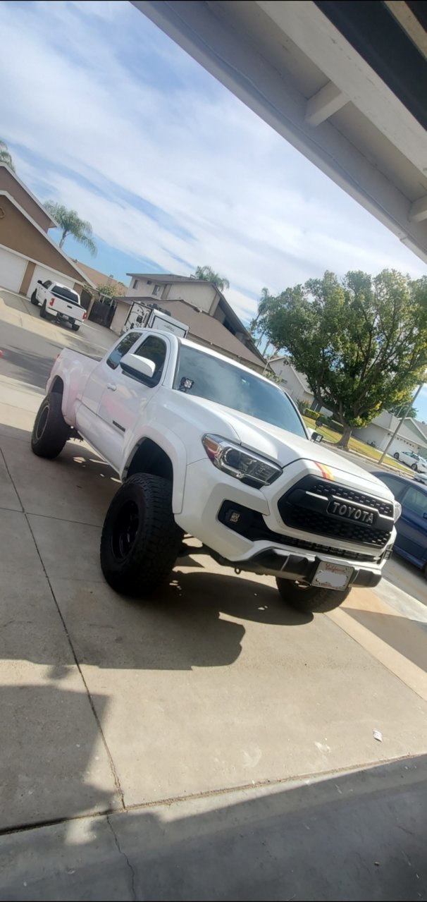

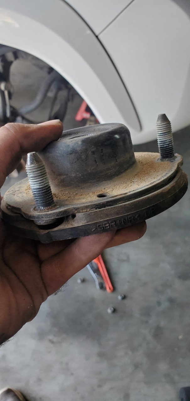

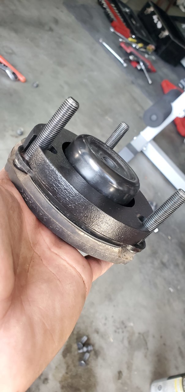

    Its a 1 inch spacer. I didn't want to go with a 2inch spacer or above or move the snap ring up.
    Its a 1inch spacer from fat bobs garage https://bit.ly/3o0vJ31
    I got it for $30 on offerup
    I installed it and now its pretty damn level with the rear. The 1 inch spacer actually made a nice difference. The only annoying part was replacing the stud bolts with longer ones that came in the kit.
    OEM studs w/ no spacer
    Longer studs w/1inch spacer
    This is how the truck looks after it was installed. The front used to be noticeably lower.
    NorNev[QUOTED] likes this.
