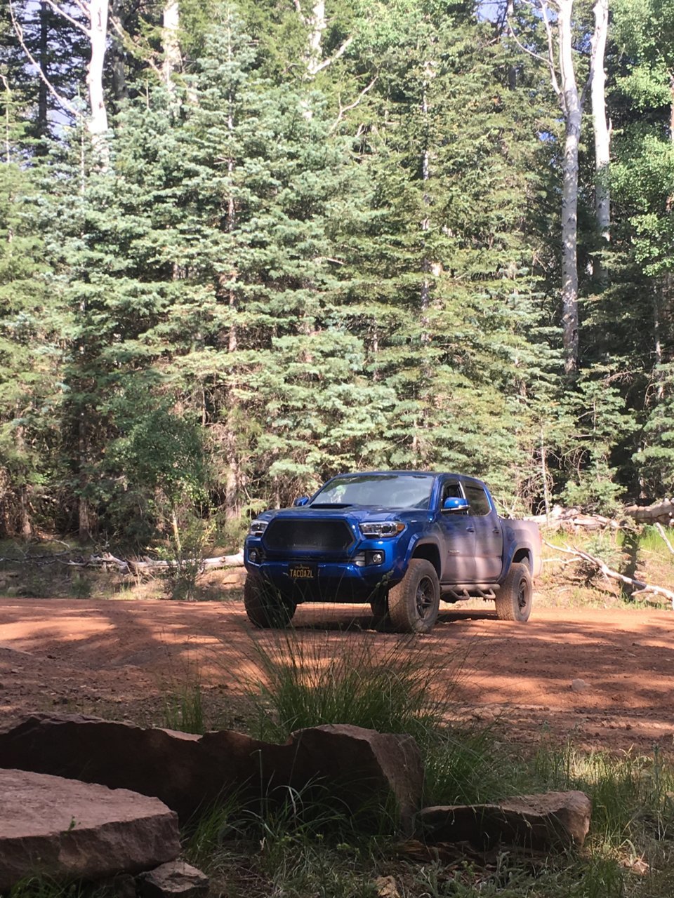

    I had the 887"s/5100's for a couple of years and 35,000 miles. They held up pretty good for me. I added sliders and they dropped a little and then I added a front bumper and well eventually I ended up on the 6112's with 650 pound springs. This photo, the 887's probably had 18 months and 25,000 miles on them.
