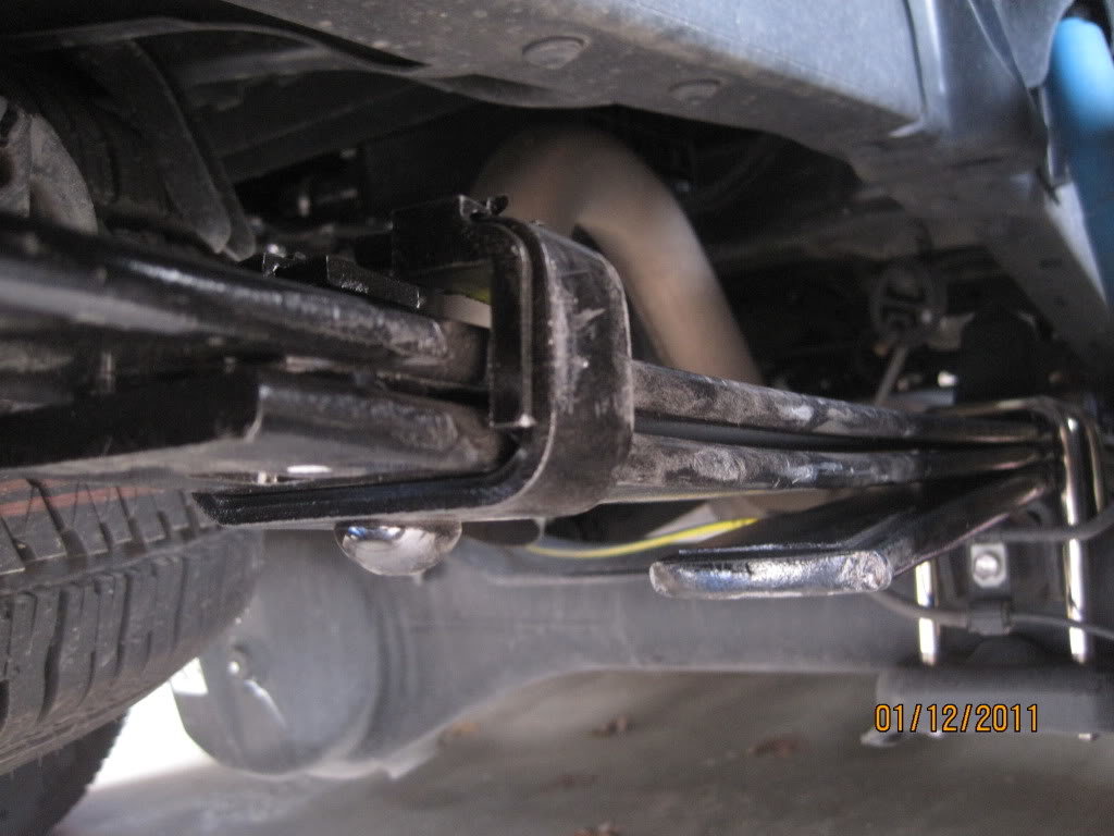

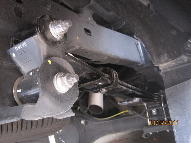

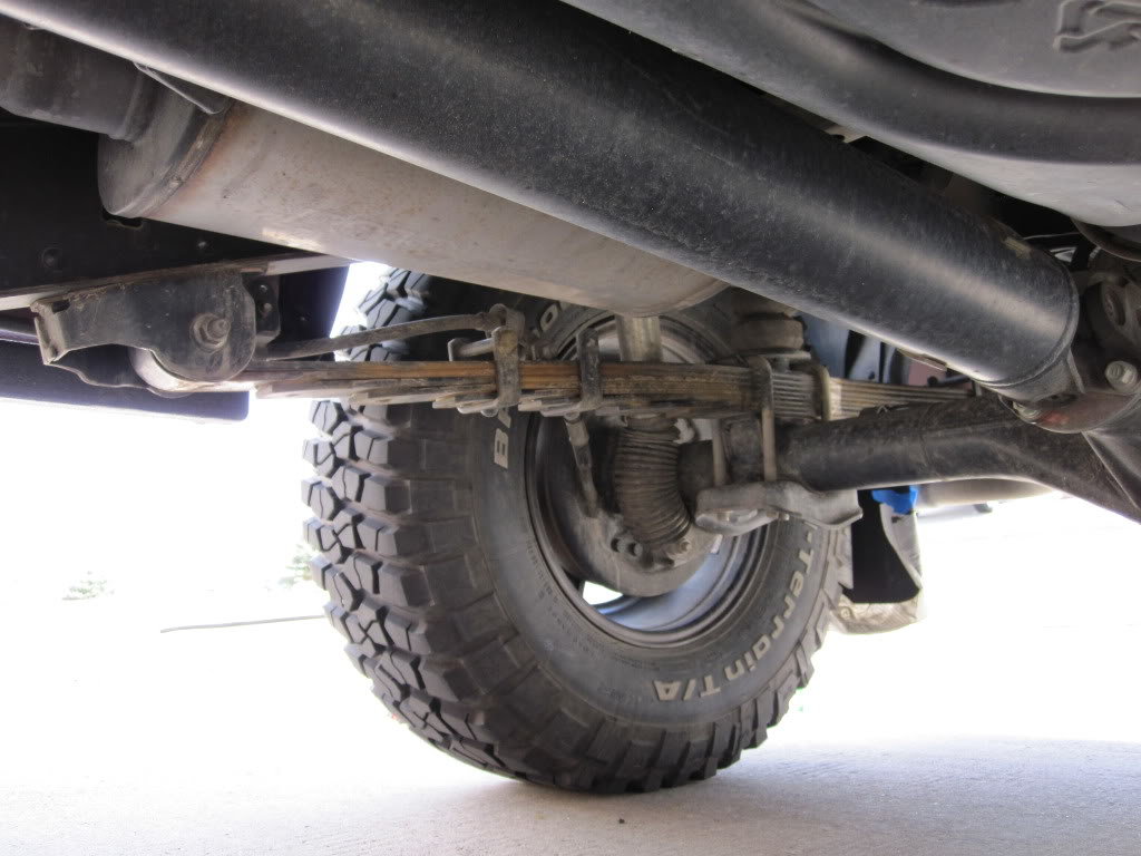

    About a year ago, I installed a pair of 8-leaf Alcans on my 2007 Double cab that I bought from Wheelers. Gradually, I've noticed that the rear seems to be sagging. I haven't abused the springs, and only load the bed down occasionally for skiing trips or whatever. When I installed them new, I measured from the center of the wheel directly up to the center of the fender flares (bed empty). Drivers side was: 23" and Passengers side was 23.5". Now, the measurements are (bed empty): drivers side: 21.25" and passenger side: 22". I'll attach some photos, and stock photos for comparison.
    Alcans with empty bed (you can see distance between timbren and frame in photo):
    Another shot of sagging/Alcans (empty bed):
    shot of stock spring:
    another shot stock spring:

    If the bed is empty, I don't bottom out. If I have even a couple hundred pounds of stuff in the bed, I will easily bottom out when going over bump/dip.
    I've contacted Charles at Alcan and Jason at Wheelers, and sent them the pictures you see. Jason asked for some more pictures, which I sent him. We'll see if they can offer any solution. Charles didn't think there was anything wrong with the pictures I sent him. I said a negative arch was normal. But I don't remember any negative arch to my stock springs.

    Ummmm.... Did you install the timbrens?
    When installed, they are supposed to be 1" from the frame (bed unloaded).. So, technically you are not bottoming out, you are using the timbrens to cushion the load. Did this problem start after or before the timbrens? If the timbrens are more than 1" unloaded, you ay need to call timbrens to send you the correct size spacer so they will be 1"... Some go 3/4"....
    Op.. Measure from the top of the leaf springs to the frame... What you got?
    As for your springs... I have no idea, but corrected timbrens may help what you experience as bottoming out...

    ^^^ not sure what the distance is supposed to be between timbrens and frame . . . no where in their literature do they state it should be 3/4" to 1".
    Regardless . . . the leaf springs used to be between 1" and 2" higher than they are now, and they appear to be sagging with some negative arch to them when the bed is completely unloaded. And my truck now has a reverse rake to how it sits.
