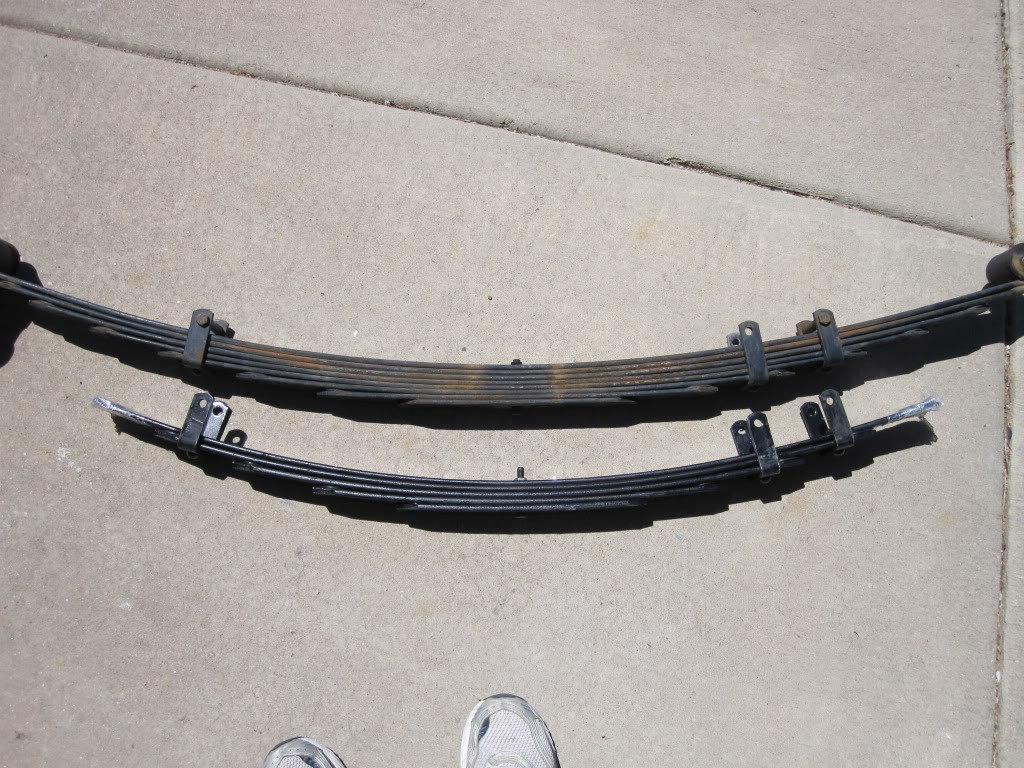

  3. May 31, 2011 at 4:41 PM
    #23
    Dr. Sleep
    Dr. Sleep [OP] Well-Known Member
    May 8, 2009
    #16977
    345
    Shane
    Colorado
    07 DoubleCab SR5 4X4
    Comparison of new bottom 5 to the old pack

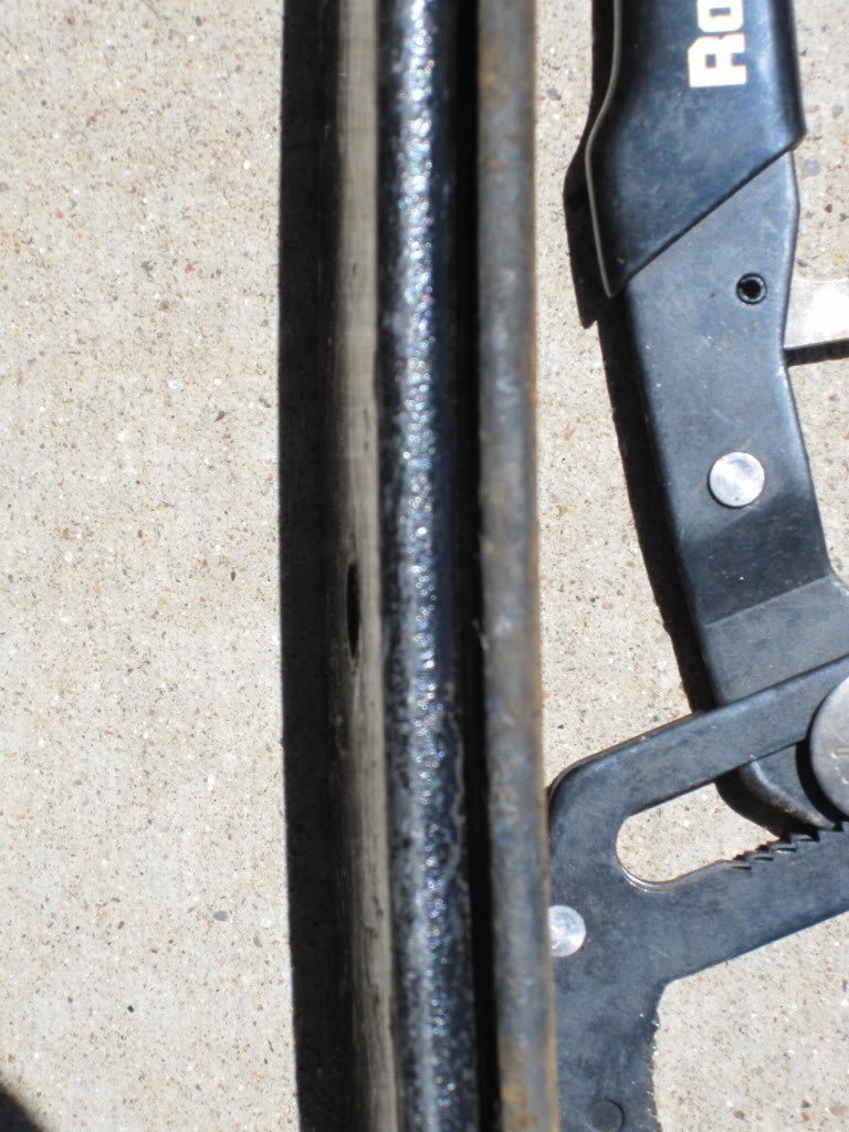

  4. May 31, 2011 at 4:42 PM
    #24
    Dr. Sleep
    May 8, 2009
    #16977
    345
    Shane
    Colorado
    Close up of thickness comparison. New leafs are thicker.

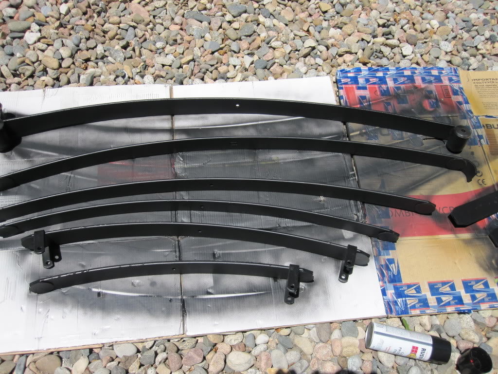

  5. May 31, 2011 at 4:45 PM
    #25
    Dr. Sleep
    May 8, 2009
    #16977
    345
    Shane
    Colorado
    Removed Rust from old top 3 leafs with flap wheel, and painted with rustoleum.

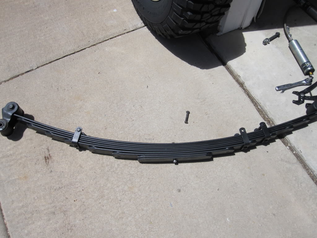

  6. May 31, 2011 at 4:46 PM
    #26
    Dr. Sleep
    May 8, 2009
    #16977
    345
    Shane
    Colorado
    Reassembled leaf pack with new bottom 5 and old top 3

  8. May 31, 2011 at 4:49 PM
    #28
    Dr. Sleep
    May 8, 2009
    #16977
    345
    Shane
    Colorado
    Gained about 2 1/2" of rear lift immediately after install. I'm sure they will settle out, but the ride seems better. I expected a harsher/firmer ride, but actually got the opposite. I'm quite pleased.
